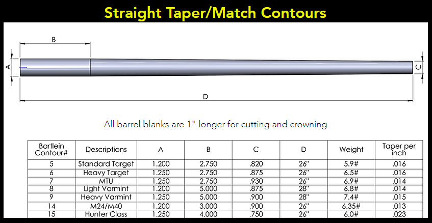

Are you ever going to carry this over terrain -- because that M24's going to be pretty heavy if you do.
HV is significantly heavier
OP: If you're just talking for precision, Bartlein for sure. I ended up getting an MTU recently because it was in stock, but I'd have preferred the HV if I could've gotten it. PRS is my use case.

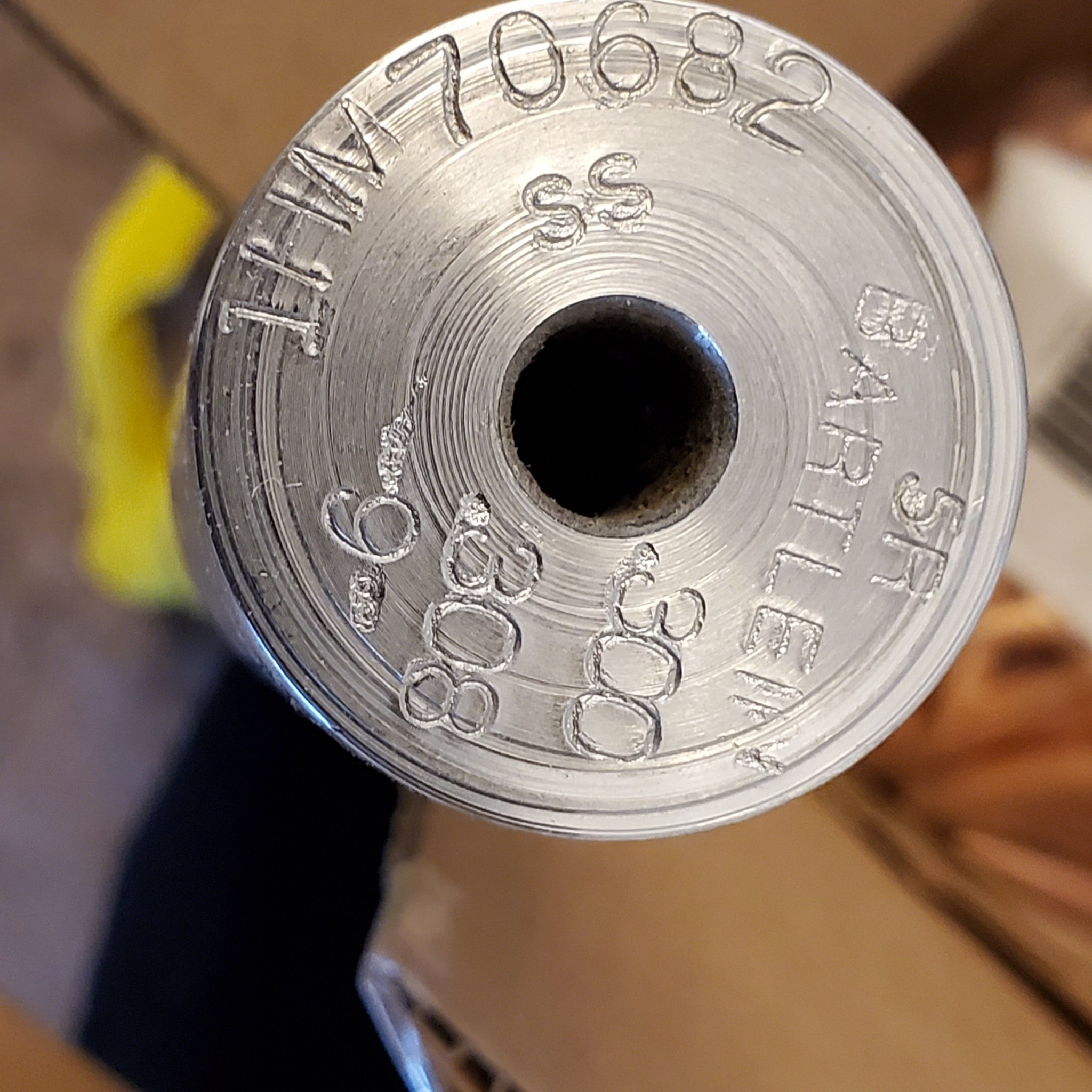

I vote for and use the 1-9 twist as the best versitle choice. My recent 308s were Bartlein 8 twist and 9 twist.
8 twist is a long action on a 30" barrel heavy palma.
The 9 twist is more portable hunting rifle Rem Varmit contour on a 22" Bartlein, it runs the 200 gr SMK at 2740 fps .715 g1 bc or 155s to 3100 fps and 230 gr SMK .8 bc at 2550 fps.
The 30" 8 twist is faster at 2856 Ave for the 200 SMK, and will handle 250 gr ATIPS.
Its also accurate with light 130 gr Speer Varmint bullets.
