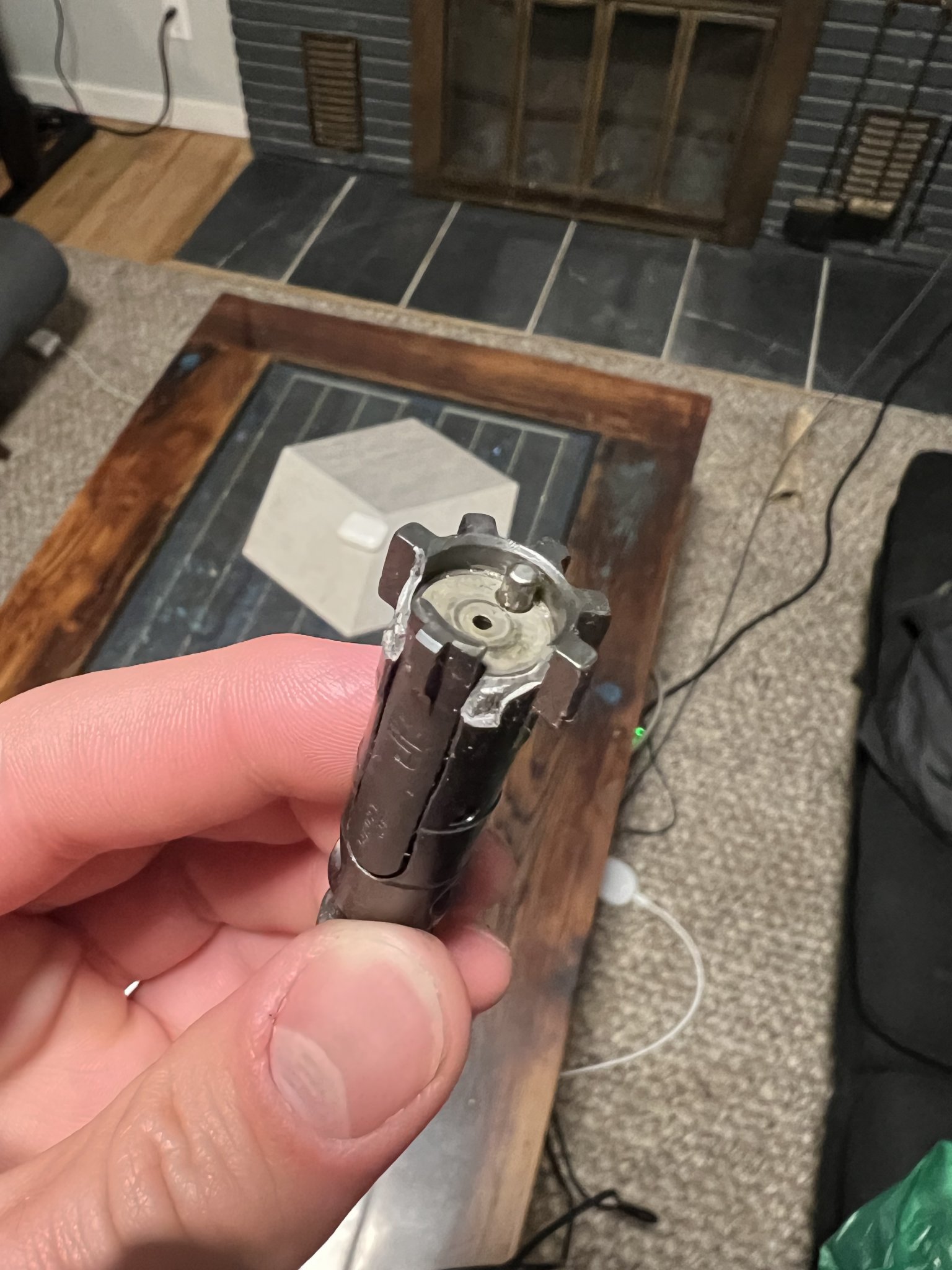

Lolol that blown bolt was me! You are spot on, I was .3 grains of powder above max and had about 400 rounds on that bolt, it was hot out, and I was running the gun hard at the end of day 2. I sheared two lugs off it. Luckily another shooter had his Seekins 6 Arc upper in the car and I swapped bolts and finished the day. I have since toned down my load and haven’t had a problem like that after 1000 rnds.
My rifle is all JP expect for the barrel and they were gracious enough to supply me with a free replacement bolt.

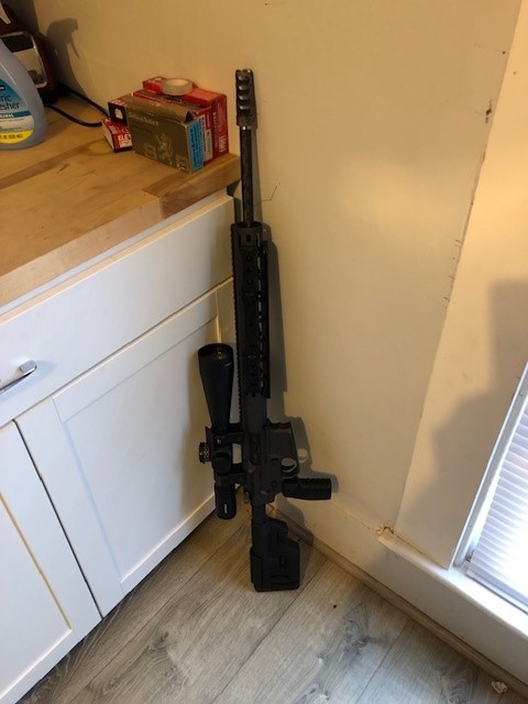

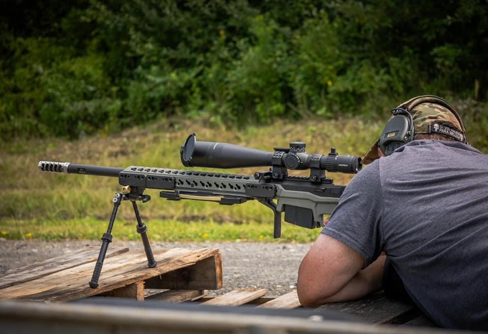

what do you have against carbon fiber wrapped barrels?
Carbon wrapped barrels are fine. But the trend in PRS, driven by the course of fire, is heavier weight rifles (20 lb +) shooting low recoiling cartridges. You can get more barrel (performance + weight) for less money with an all steel barrel. Paying a premium for a carbon wrapped barrel, then paying more for weights to increase the mass and balance of the rifle is just added expense for less performance.
Reactions: river22
i have had good luck with the carbon barrels with added external weights. If it a good barrel there is no impact shift during fire. I think 15 rounds was the most i had to shoot at a stage for all of the PRS matches i have done. that picture is my AI atx in 6.5 that's my bolt gun that is a steel barrel.

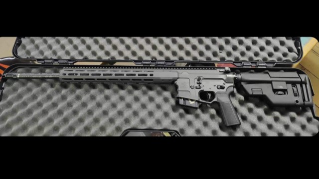

So that is no ? That doesn’t help this thread you could at least post a link.
Posting a picture of a rifle without even an optic in a case that doesn’t even appear to have been shot doesn’t help the thread either.
