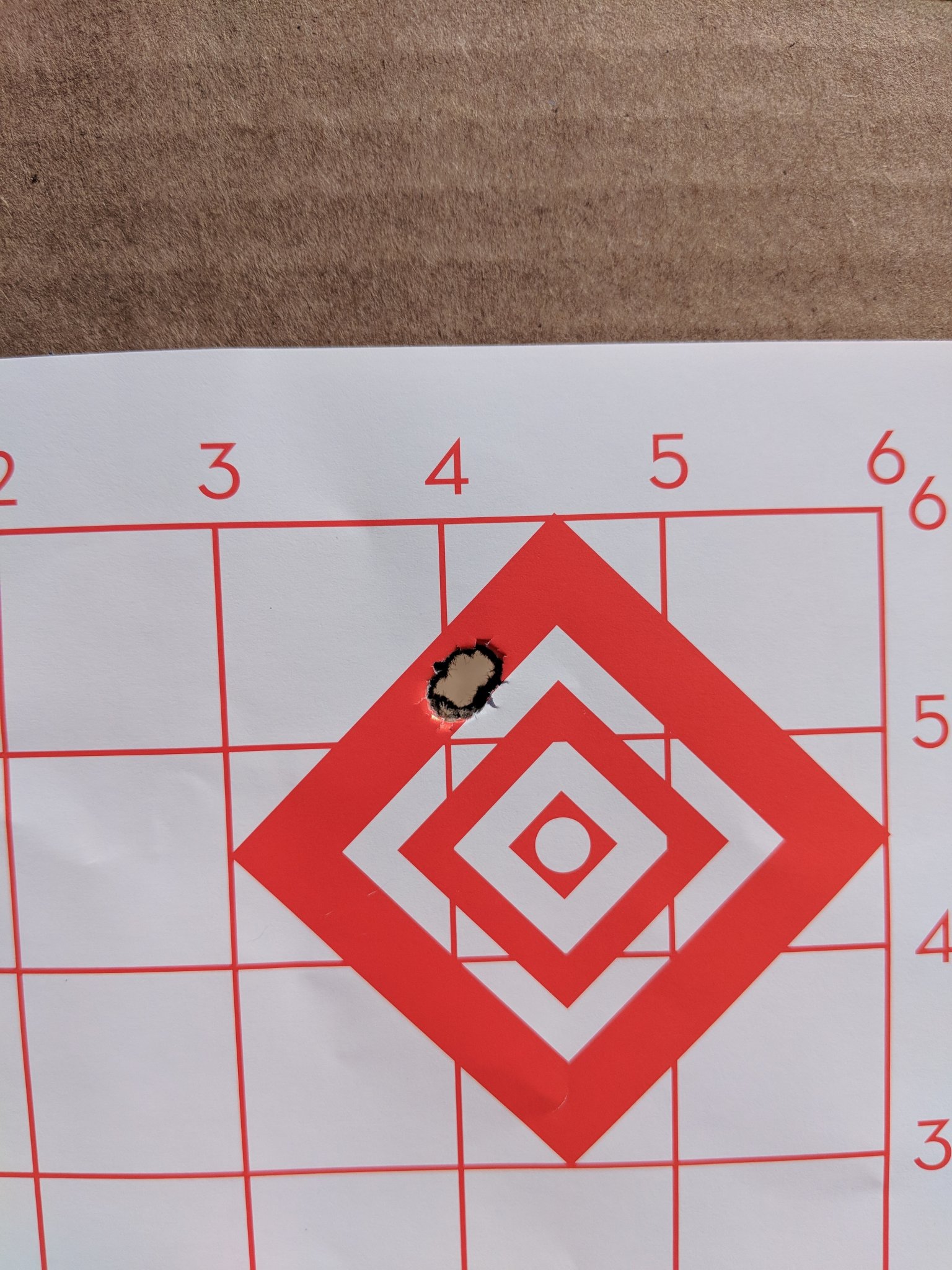

I have both, well technically a 6BRA and a 6.5 creedmoor barrels for one rifle.
Both can be dang accurate, but the 6BRA (FF loads are straight 6BR rounds) has some scary precision potential. I've shot some really good groups with a 6.5 creedmoor, but my best groups have been with my 6BR/BRA.
Here is 5 rounds at 100 yards with my 6BRA fireforming loads:
Reactions: BLKWLFK9 and Tunnuh
It is pictures like this that keep contributing to my addiction :p
