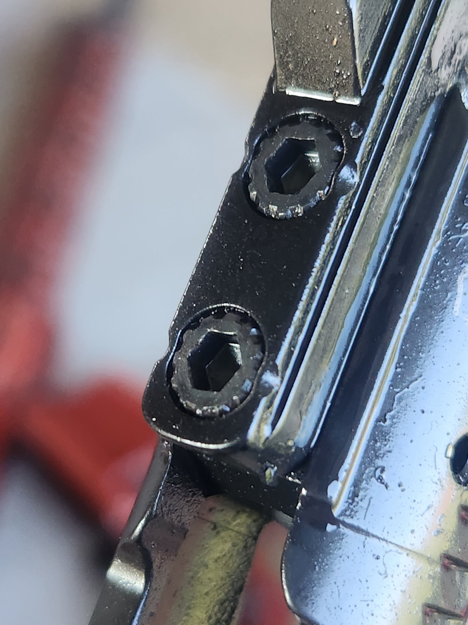

You tell me. I don't really get into the whole staking and pinning and mil spec and gauging parts thing, so I don't know if these are good enough for the stake-perfection-gang. I just buy one of everything and shoot it till it breaks, then inspect.
OCKS screws. Very nice. Those are the best. Staking looks good as well. Good job RCA.
Reactions: TonyTheTiger
