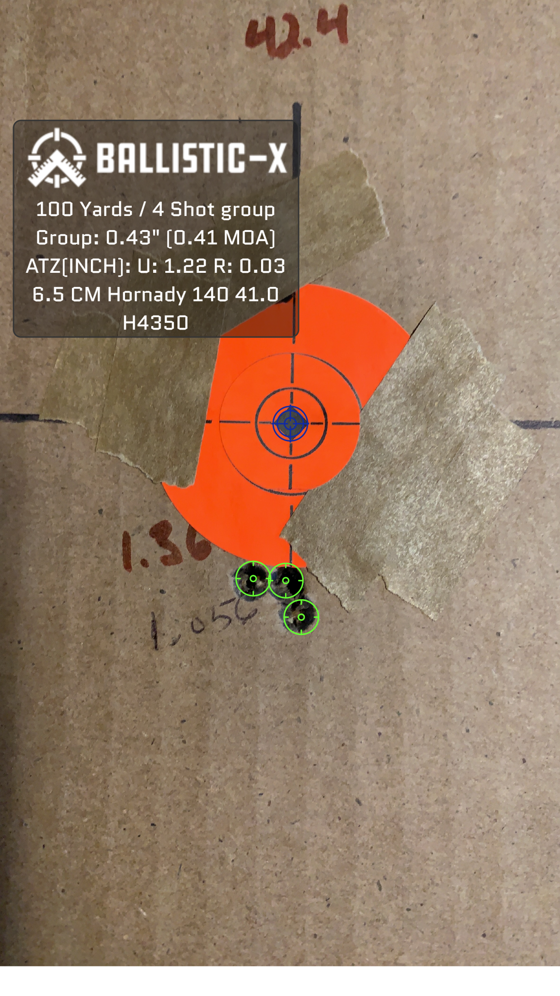

+1 on the Toolcraft. I bought the 6.5 marked bolt with the dual ejectors. Not sure if that was needed, but it sure does throw the brass!
That has the small firing pin, any issues?
[QUOT
No problems so far. Once I got the gas block tuned, which didn’t take long, it has been 100%. This is only 3 shots on my ladder test
