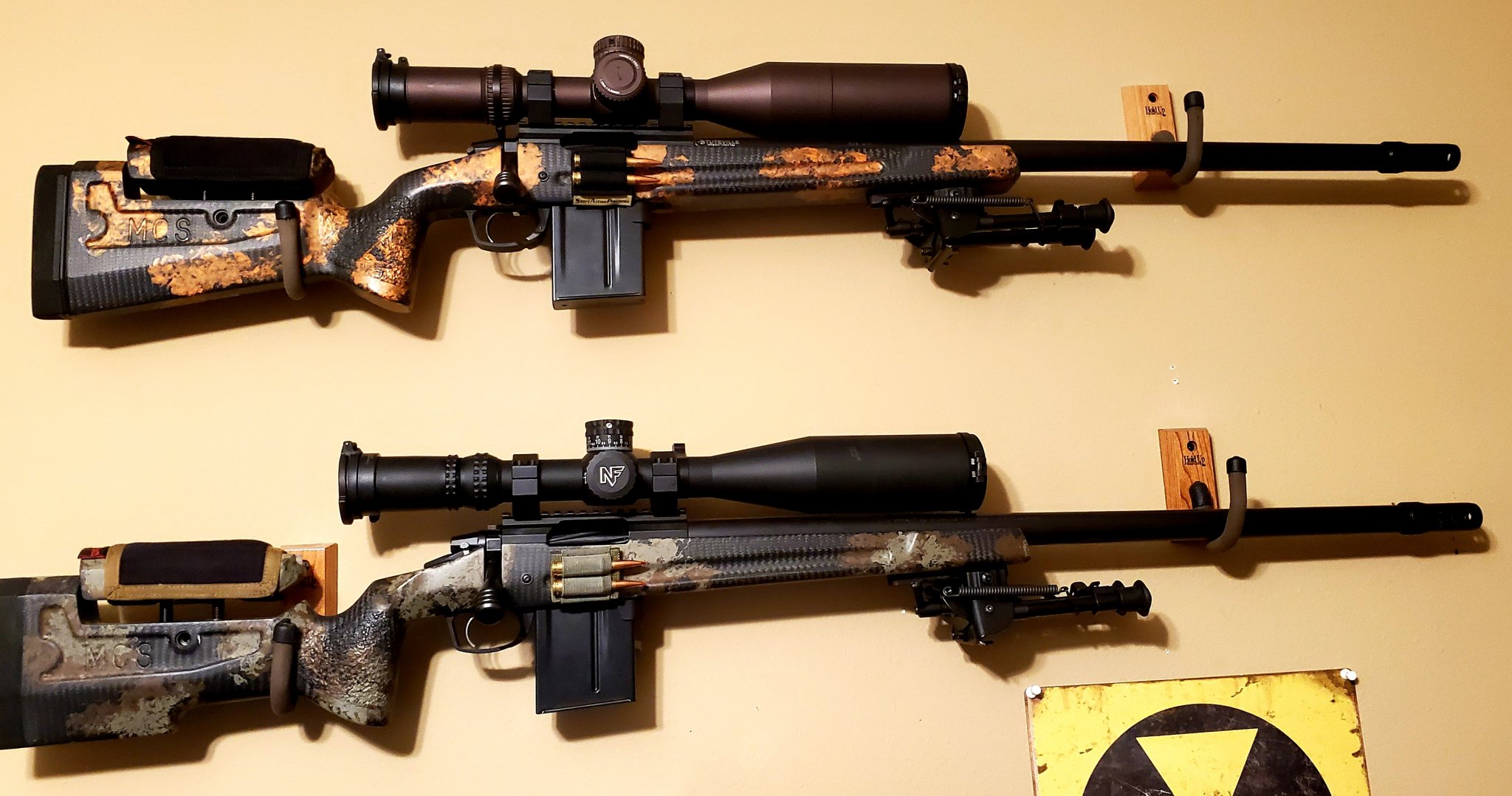

I got two 24” tactical guns, Kreiger barrels. Both shoot 44 grains Varget 175 SMK, 210M, Lapua brass, seated-0- right at the lands. Both shoot 1/8 moa @ 2680 fps.
