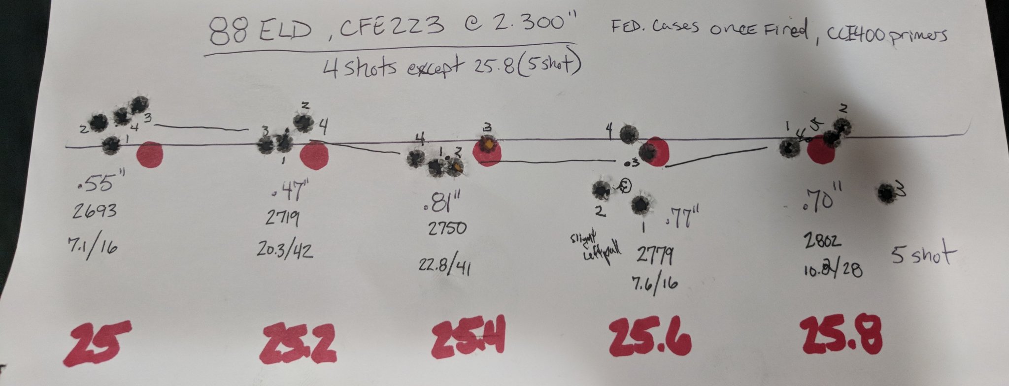

So have found a good node with 224V and 88 ELD but I'm in bit of a debate with myself: tight groups with occasional flyer that could be me OR slightly less tight with good SD.
Here is original test target with 4 shot groups:
25-25.2 tested well so I retested 25, 25.1, and 25.2 shown below:
SDs are good across the board but 25.0 has been consistently around 5-7. The velocity changed between the two days but that's probably because I let the loaded ammo sit for an extra day in my last test, as opposed to loading and firing within a few hours.
So here's my debate: a load that will put 80% into about 1/4-1/3 moa and 20% into a .6moa vs a solid 1/2 moa load with good SD?
I really want to chase that bughole load but feel like in competition, a flyer that's 50% out of group average could give me bad info for follow up shots. If this was your rifle, which would you choose for PRS style comps in gas gun division?

I'm actually dropping charge from 25.8 (ragged edge of pressure at 85+ degrees). That's why I wanted to retest for lower node and find something that doesn't put me in a potentially dangerous spot if ammo gets over 100 deg.
I've tested several other powders but none of them are giving me the accuracy I need for a match (have been .7-1.2 MOA with most). Varget is one of the only super temp stable powders I've run but also have R15, R17, XBR and H4350. Just can't get the mix of speed/precision/SD with the others or at least I haven't found it yet.
I will be testing whichever load I choose with the ice bath/room temp/carheater test 10 rounds each. That will at least give me an idea of temp variation for matches.
This load is being developed for a match in southern Ohio scheduled for early Nov. I'd expect temps to be between 45-70 max.

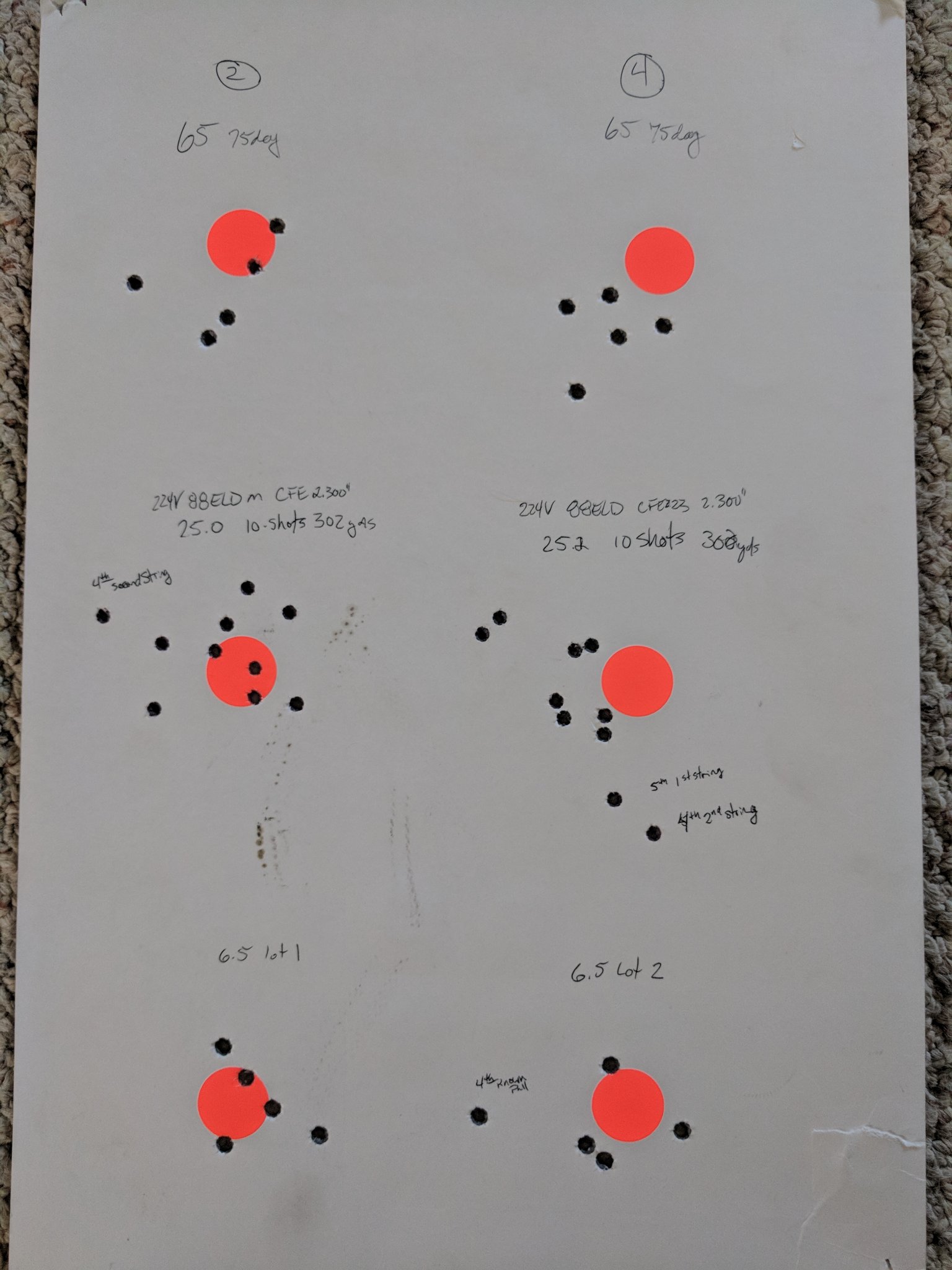

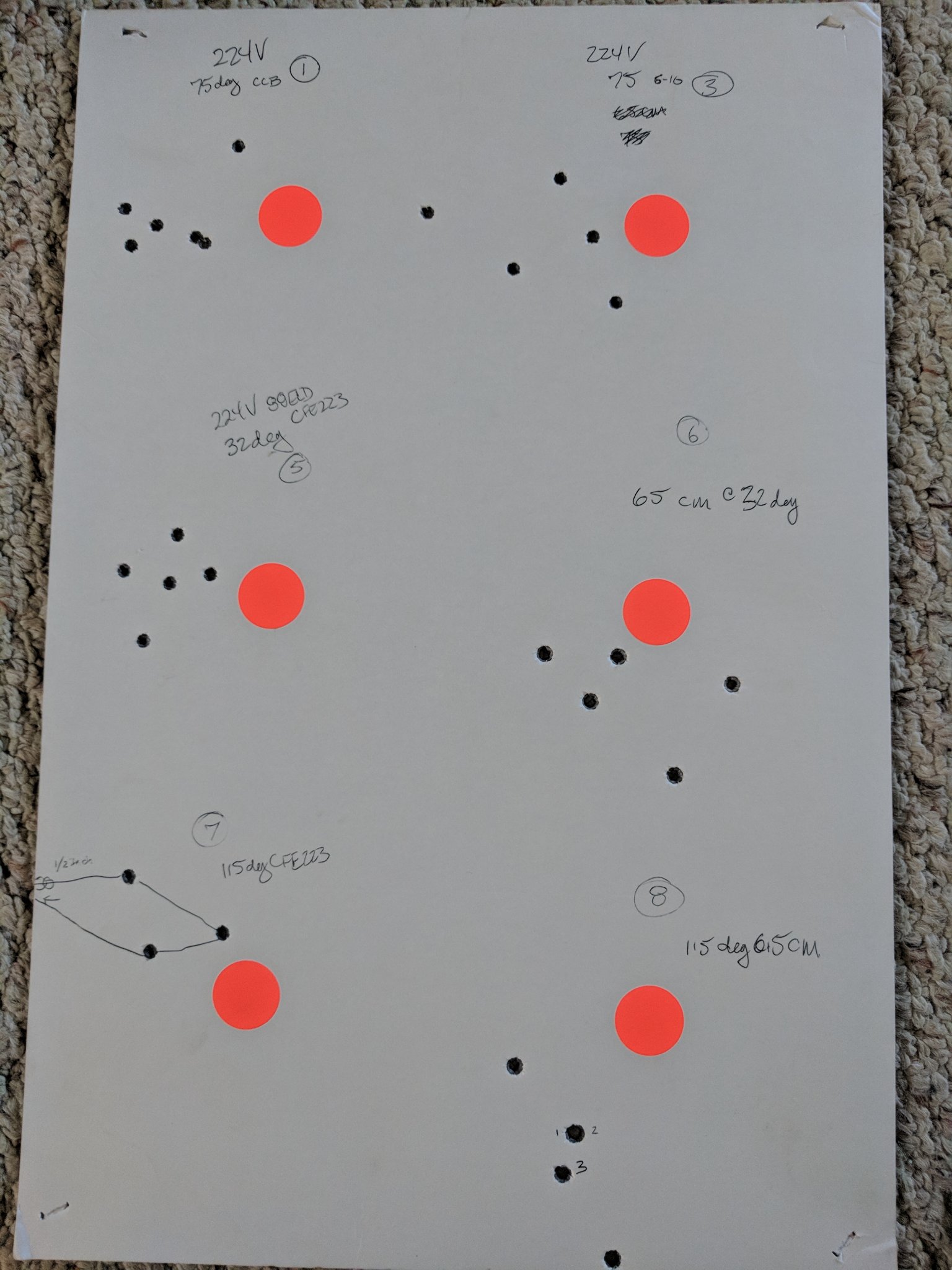

So testing went well and tried both 25 and 25.2 at 400yds. Also tested CFE223 temp stability...which was both interesting and enlightening. I compared CFE in my Valkyrie to a control of H4350 in my 6?5 bolt gun.
Top row two groups of 25.2 (top left is CB 6 shot group and right top is next 5 after 2 minute break. Ammo temp 75 deg.
Middle row is 30 deg ammo (224v on left 6.5 on right)
Bottom row is 115 deg ammo (224 on left 6.5 on right)
Here is target with 25 vs 25.2 (middle row; top and bottom row are 6.5 CM) 10 shot group for each fired 5 of each then switch.
I think it's going to be 25.0 when temps are 65-90; 25.1 when 50-70, and 25.2 when 0-60. The 25.2 charge acted EXACTLY like 25 when frozen and SD was 3.3.
Note: the 25.2 group is crazy consistent: notice each bullet has one right next to it. It literally fired the same pattern in same order twice.
Powder is definitely temp sensitivite as it had a 60fps swing over 85deg variation (2711@30deg, 2735@75deg , 2740@85deg, 2785@115deg). I really don't love having to temp tune a load but it is super consistent for a given temp (SDs around 3-10 fps).
