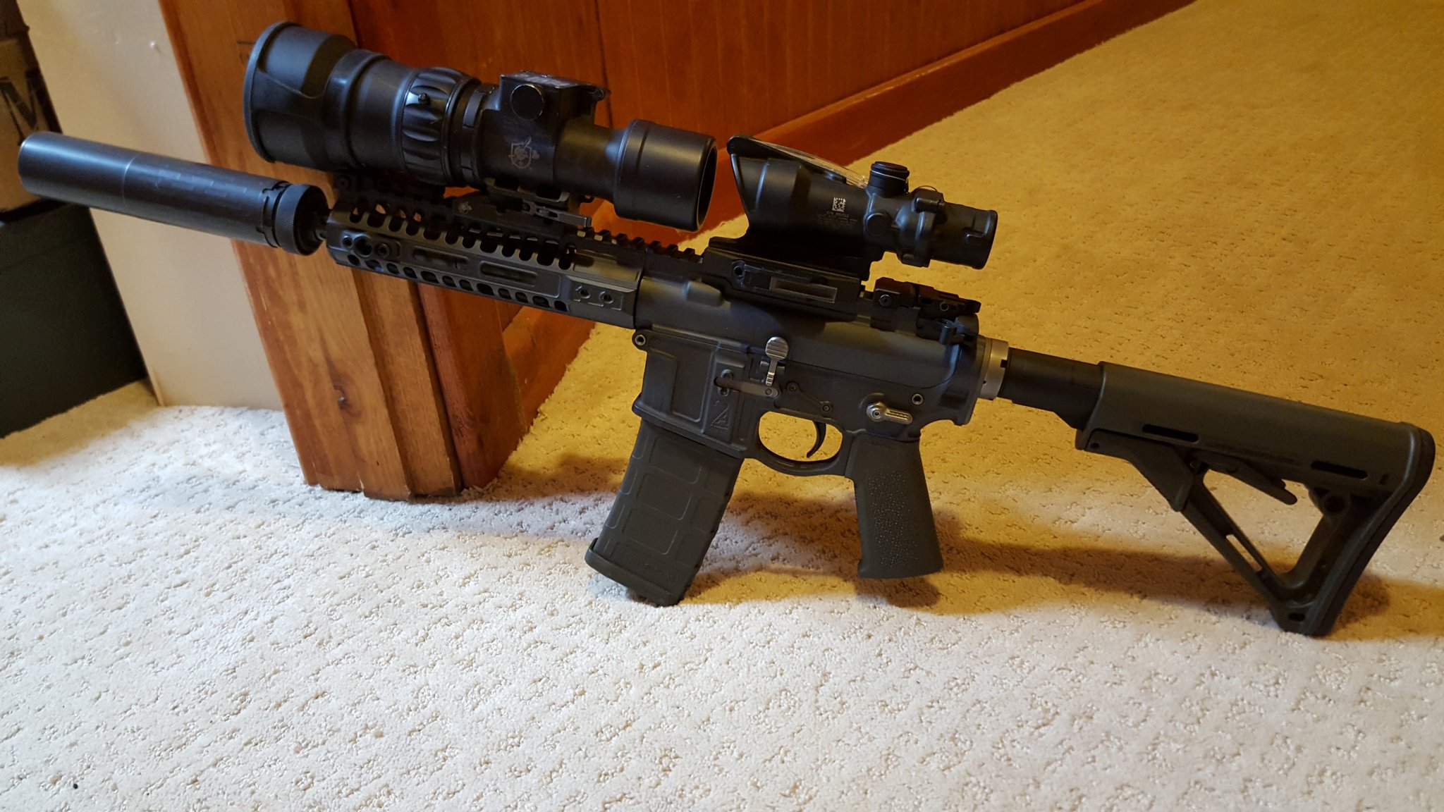

I have played with my PVS 30 on a MK6 1-6, ACOG TA31 (4X), and multiple 4-16 and 3-20 scopes, It works well on all of the above. I would think the low end of magnification would be around 3x.

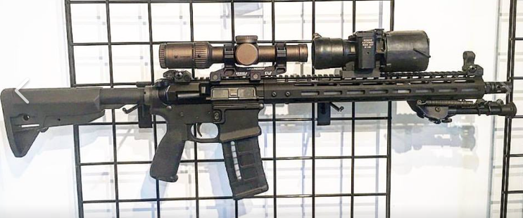

Thanks for sharing your guys' info and experience with these! The pics were very helpful, I didn't realize just how big the pvs30 was until seeing it on Dag's setup! Thanks for the recommendation of the pvs22, it does look a bit smaller than the pvs 30.
