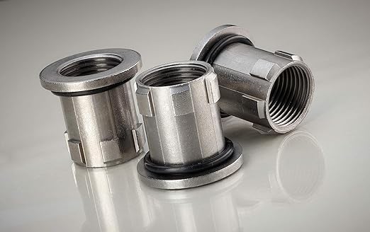

Since I was already using Lee's Breech Lock quick change system, I tried a bushing insert that would allow me to keep using them. I found that I could not move dies between the Breech-Lock only press and a press adapted to the Breech Lock with a bushing without changing the die adjustment. Especially since Lee changed to Aluminium LRE's, I've found the Breech Lock system frustrating because the LRE's gall and stick in the press head. They never did that with the steel LRE's. Lee's Breech Lock bushing insert is also stupidly Aluminum rather than steel. I also hate the stupid little plastic wrench.
So I decided to try Hornady's Lock N Load quick-change system. I bought a bushing and a 10-pack of the inserts. I notice they don't lock on the die. Am I missing something?
First, this means I need lock rings and LNL inserts. At least the Lee system eliminated the lock rings and gave all my dies a consistent grip.
Second, the die position is secured only by how much it is torqued into the LNL bushing. That's lame for two reasons: one, I have to torque the die before I know the final position. If I set the position correctly, it will be off once I torque it. Two, because the torque of the die in the lock ring and the die in the LNL bushing are opposing one another the die cannot be adjusted simply by unpinching the lock ring. It must also be untorqued from the LNL bushing.

I'm making up my mind that the original, steel, Lee Lock Ring Eliminators are the best die rings. Why? Not only are they quick-change, but they're also the only die rings that allow the die to be adjusted when it is torqued in the press. Every other lock ring or quick change bushing has to be un-torqued before it can be un-pinched and adjusted, and differing amounts of torque from unprecise "finger-tight" to wrench-tight aren't consistent. Because the LEE LRE's only have one set of female threads, unlike the LNL's that have the female threads on the lock ring and an opposing set on the LNL insert, once the LRE's threads are unpinched, the die turns smoothly even with the bushing torqued in the press.
The reasons I'm getting rid of the LNL is because they require additional lock rings, and the die must be loose in the LNL insert or it cannot be adjusted.
Hornady should fix this so the LNL will pinch the die -- problem solved.
The reason I don't like the Hornady or other cross-bolt lock rings is because they also require the die to be unscrewed from the press to relieve the opposing torque so the die can be adjusted.
Either system means either finger-tight dies with a vague stop or backing the die out before adjusting the ring and then torquing it again.
With the Lee LRE, it has a positive stop on inserting it in the press and I can just unpinch the die and turn it smoothly. It's just a pity they started making them in Aluminum-on-Aluminum so they gall and turn to crap.
The only system that is better depends on the Bonanza Co-Ax press. With it, quick-change is also possible and a single set of female threads can be unpinched to allow smooth die adjustment.
