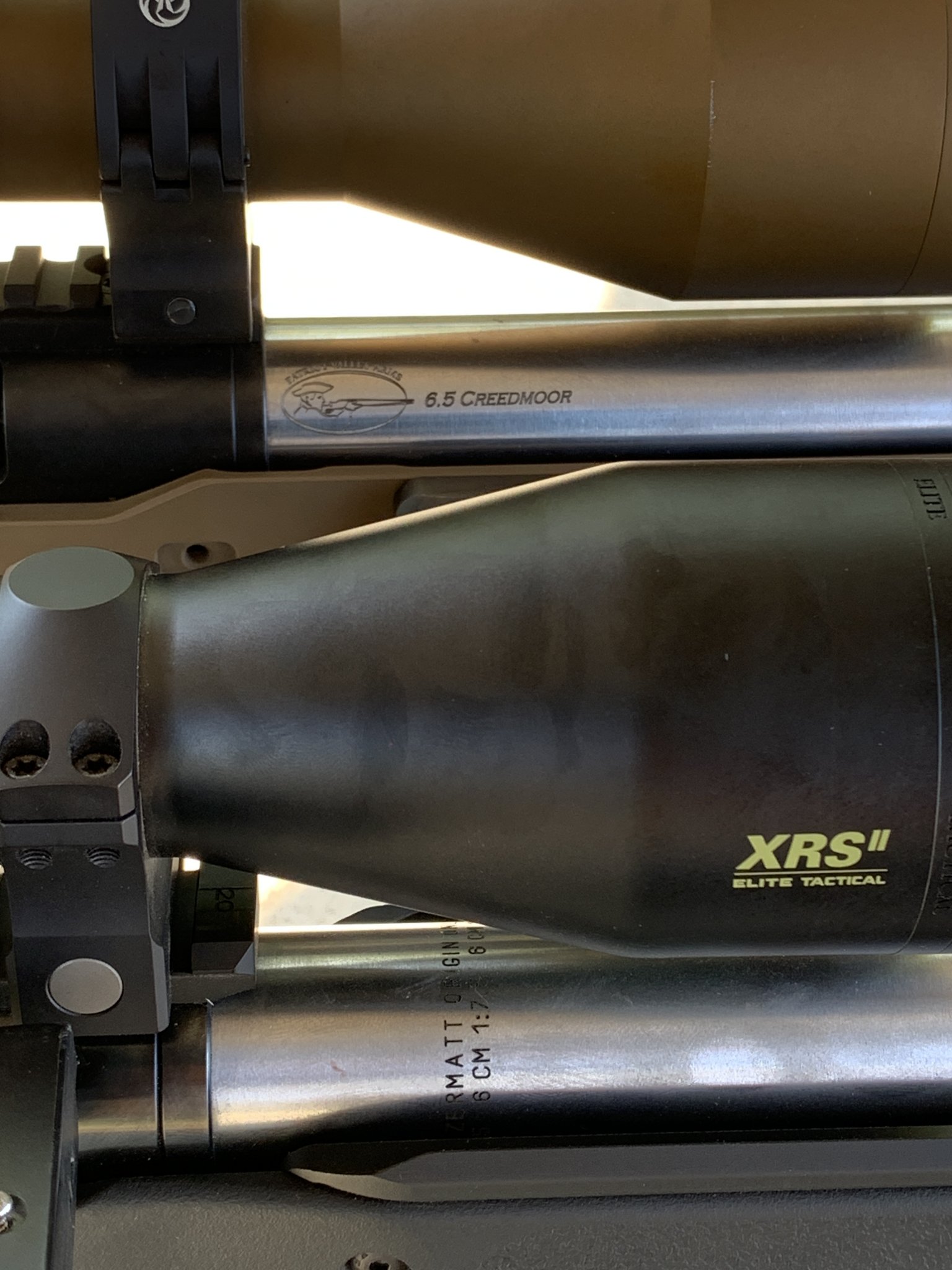

Shot a new 65cm build in a prs match yesterday and prob shot my best ever string of 7 stages before the wheels came off. I for one prefer the lower velocity and higher energy on plate to read information after the trigger squeeze. But I'm running the heaviest bullets available and slow. My wind was still inside the dasher/gt shooters. I def say 65cm. Plus currently if you ever get into reloading, 65 bullets are available, 6mm shit is vapor ware, sold out before the in stock notice hits your email.
