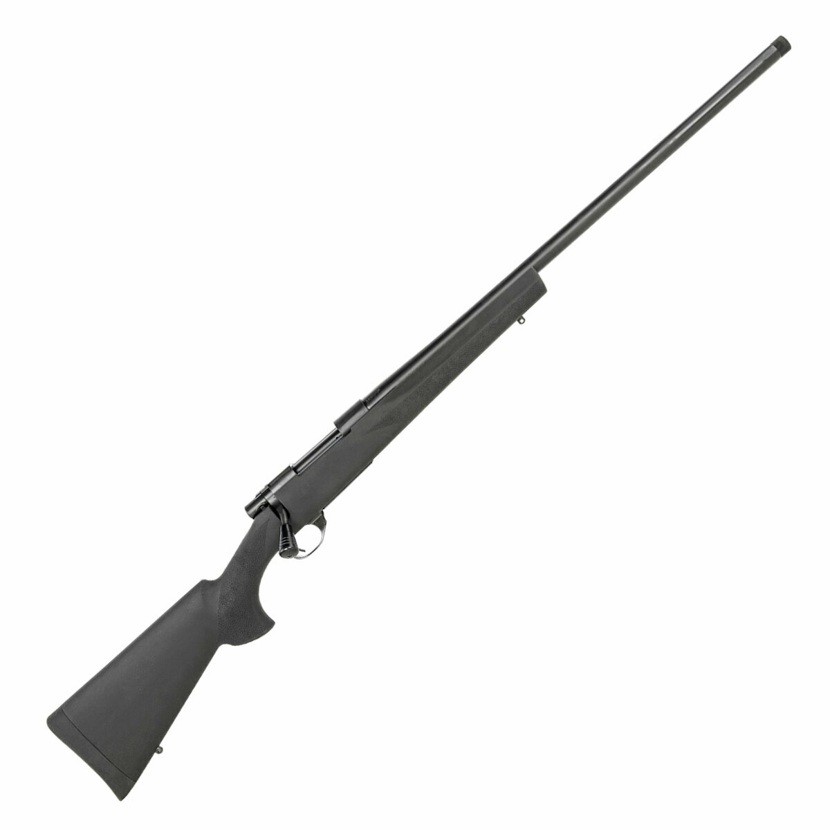

What one person considers inexpensive doesn't necessarily coincide with what another one does. It's all relative, that's why I asked what his budget is.
Inexpensive but very good and upgradeable:
Add an Arken 6-24, Bob's your uncle.
Amazon product ASIN B0BFGK727V
