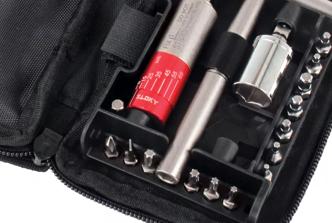

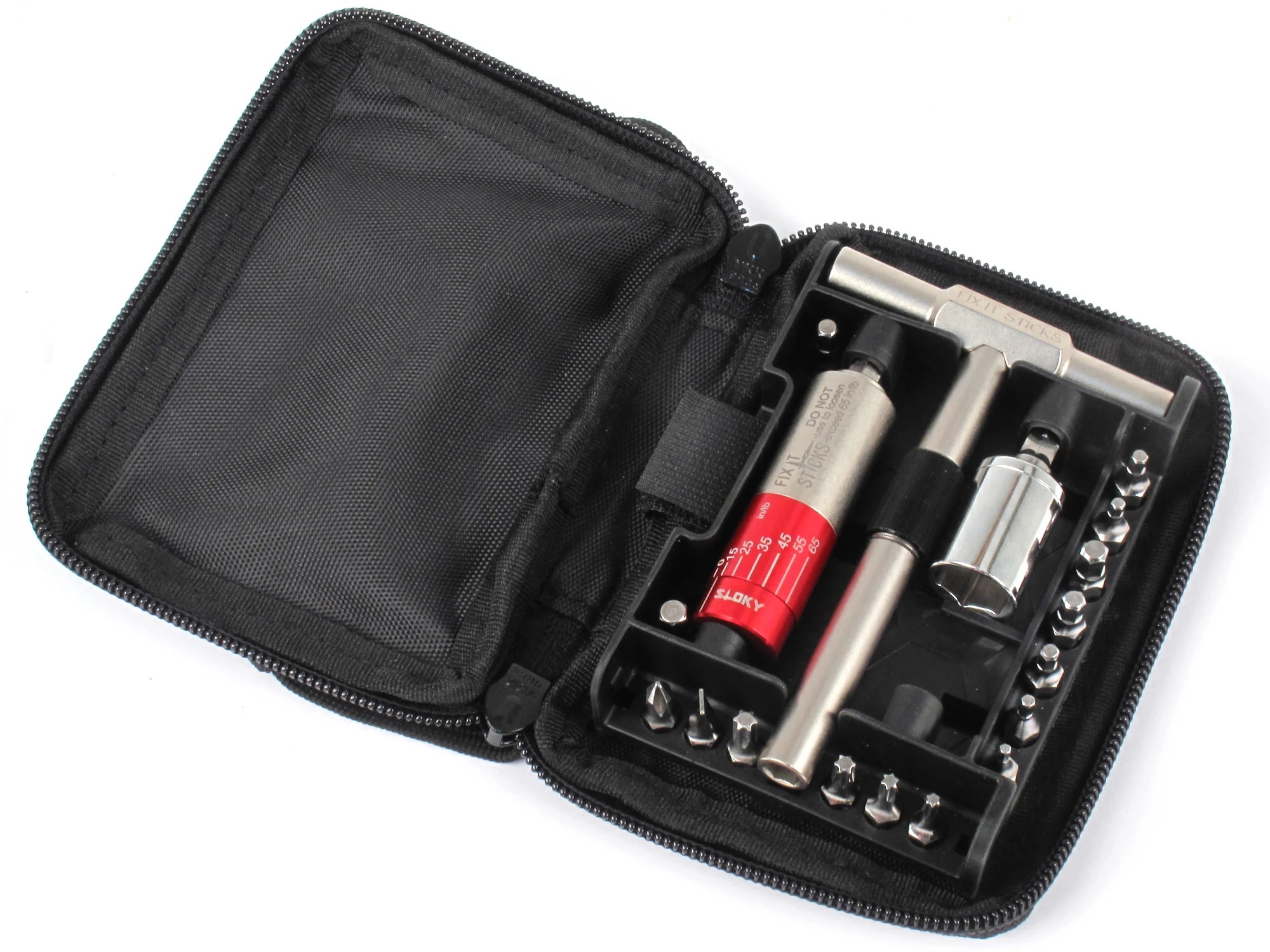

    I'm getting a Fix-it-stick kit but not sure what the big difference is between these two.... besides $60. The top one is $100 - the other $160. These are both from Cabelas. Any advice?

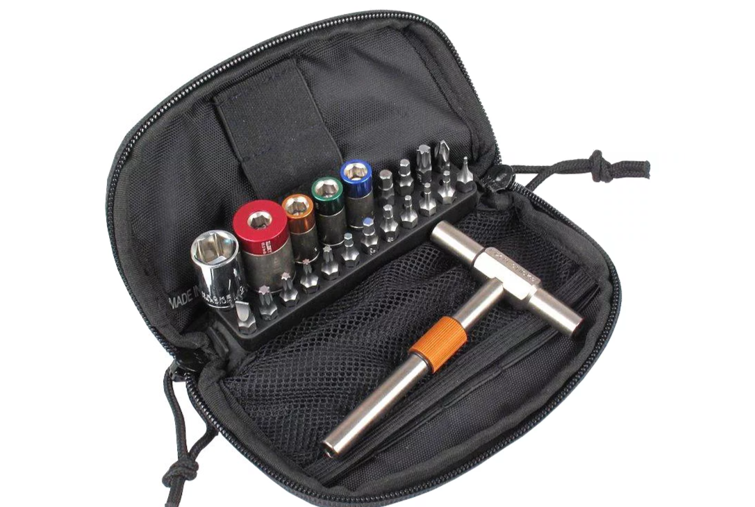

    I use both types - the all-in-one limiter for my range tool kit, and the individual limiters for my workbench. Both work fine, but my preference would be to use the individual limiters whenever possible since they are basically foolproof (assuming you don't grab the wrong one).

    I far prefer the torque limiter over the all in one, “ did I hit the my mark accurately” type.

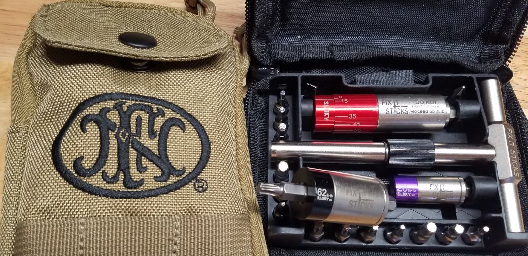

    I went the top All In One Kit, I liked it because no swapping back and forth between limiters. Put together 3 full rifle systems in one afternoon from barreled actions thru mounting of scopes and didn't have to swap out limiters.
    The having to position yourself to line up for the right torque value is a slight PIA but not real bad. Major upgrade from the Fat Wrench.

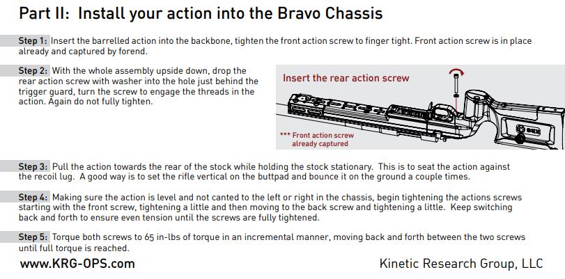

    I bought the lower kit in your image from Mile High when it came with the 4" extension. Works great for removing the action screws on a KRG Bravo
    I have the extensions as well. Pretty much a must have for action screws.
    I got the variable limiter, it’s smaller and cheaper and I can use whatever settings I want and so long as you’re not completely illiterate you shouldn’t have an issue hitting your desired setting.

    Perhaps the most important thing to understand is that the top one is NOT a limiter. It's just a torque wrench where you turn it until the number you want is lined up. A limited will "give" and click when you reach the marked torque number and not go any tighter. It will just give and turn, give and turn, give and turn..
    So which one do you need? THe limiters are more expensive and you will need one for each torque you use. The more you do the same task or install the same thing over and over again, the more useful this becomes. If you're just installing one-off pieces of gear, a scope here, a RDS there, etc, then the all in one torque type is a lot more economical.
    Also realize you're not limited to the small size tools the torque devices come with. Yuo can use them in other tool sets where they become very useful. Personally I have the top one in my range bag, I doubt I'll be fixing more than one of anything while at the range. But I have a complete set of limiters on my work bench at home I use with larger extensions and handles because I do a lot of work on guns.

    The All-In-One accuracy is +/-10%.. plus any reading error by user, torque range 15-65 in-lb. The fixed limiters are +/-6% with no reading error, cover only specific torque values. I have both, very satisfied with both. Barrett ships Fix-It-Sticks with the 140/65/45/25/15 in-lb fixed limiters with their MRAD MK22 for SOCOM. NOTE: Which ever you select....NEVER....NEVER....NEVER....did I mention NEVER.... loosen fasteners with a torque tool of any design. They are not wrenching tools, they are torque applicators.
    Army First, you might want to re-think using a torque application tool as a wrench to loosen fasteners.......a NO NO.
    The extension is a must have for action screws.
