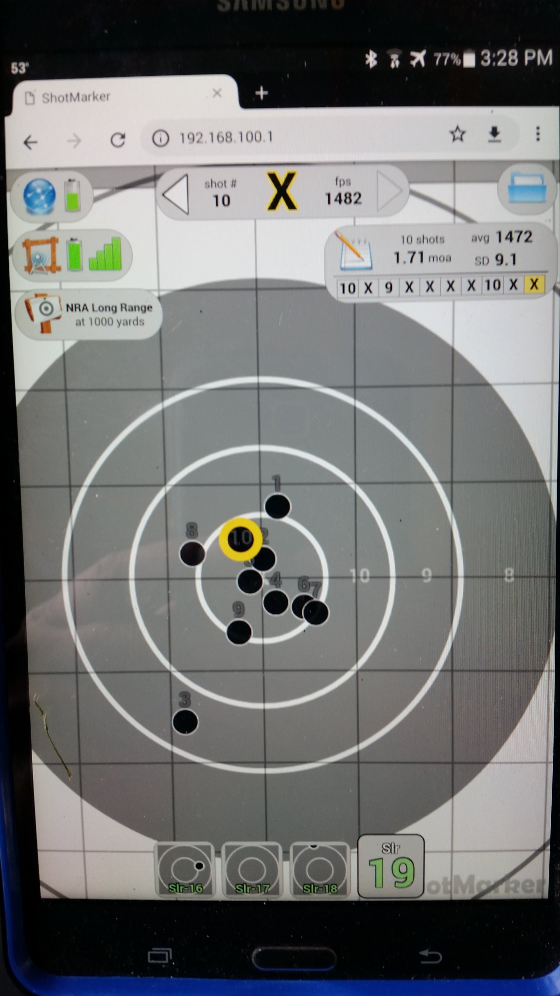

I shot this group at 1000 yards with the original prime 6.5 creedmoor with my 22 inch factory jp lrp07. It is a great hunting bullet also on elk, deer, antelope in my experience. It's all I shoot now in my JP rifles

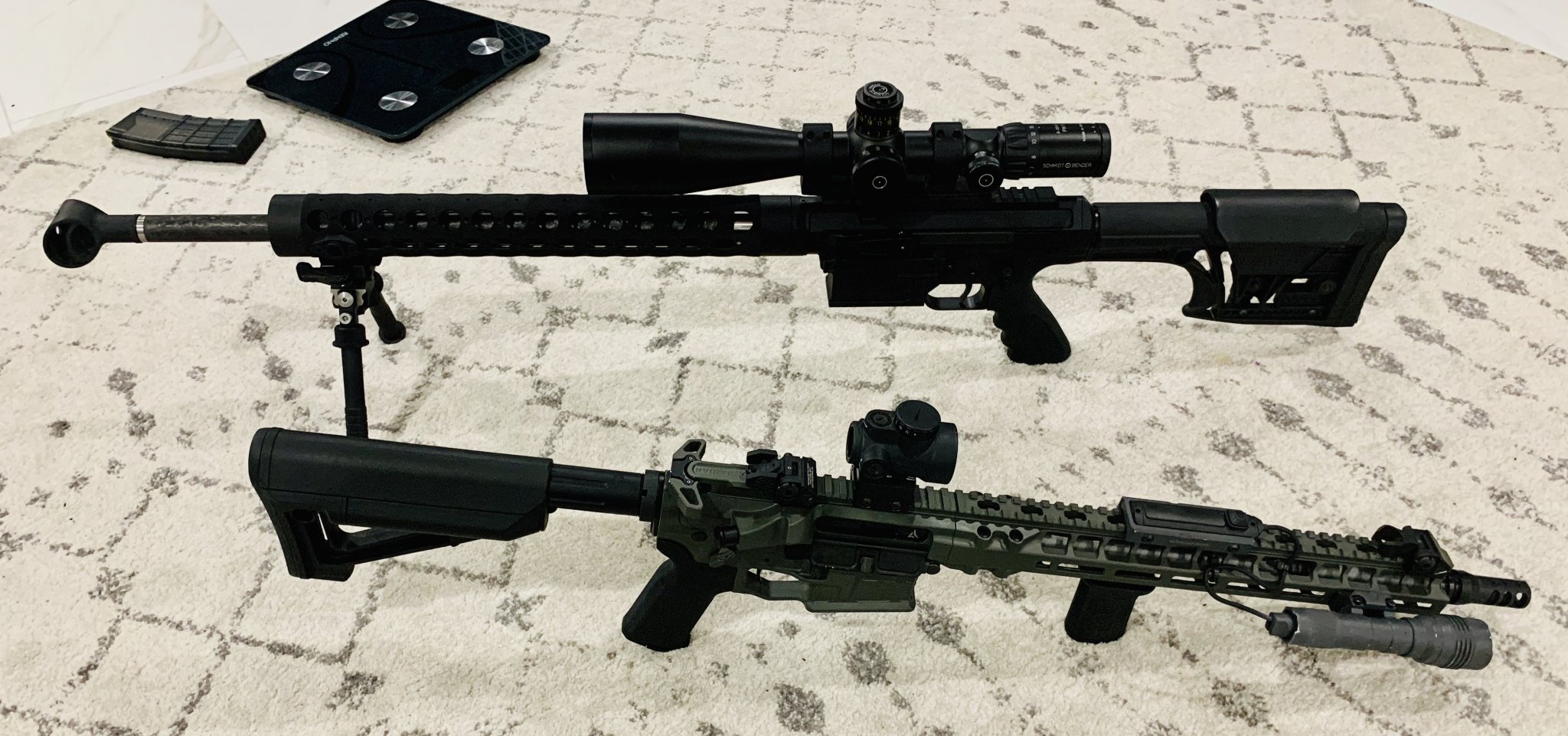

I went with proof CF barrel but some people may want steel barrel because of the heavier weight, less muzzle jump! I don’t feel much muzzle jump on my JP maybe because of my muzzle brake. After I put anything in the rifle without ammos and weight about 12.25lbs!
Reactions: HillBilly n TX

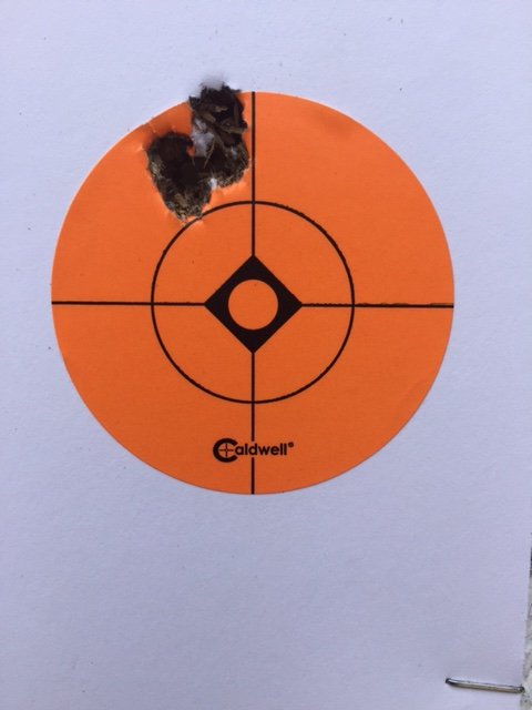

I shot this group (5 shots, 100 yds) with the following:
Hornady 130 gr ELD-M, 40.5 gr VVN-550, Hornady brass, CCI primer. Velocity was 2745 fps. This was a very mild load. Quickload says 44.5 gr would be max at around 2900 fps. Been meaning to work up the charge to see how it does at higher velocity, but haven't gotten around to it yet. Sierra 123s and VVN-550 have also proven to be very accurate. This was with a 22" JP barrel.
