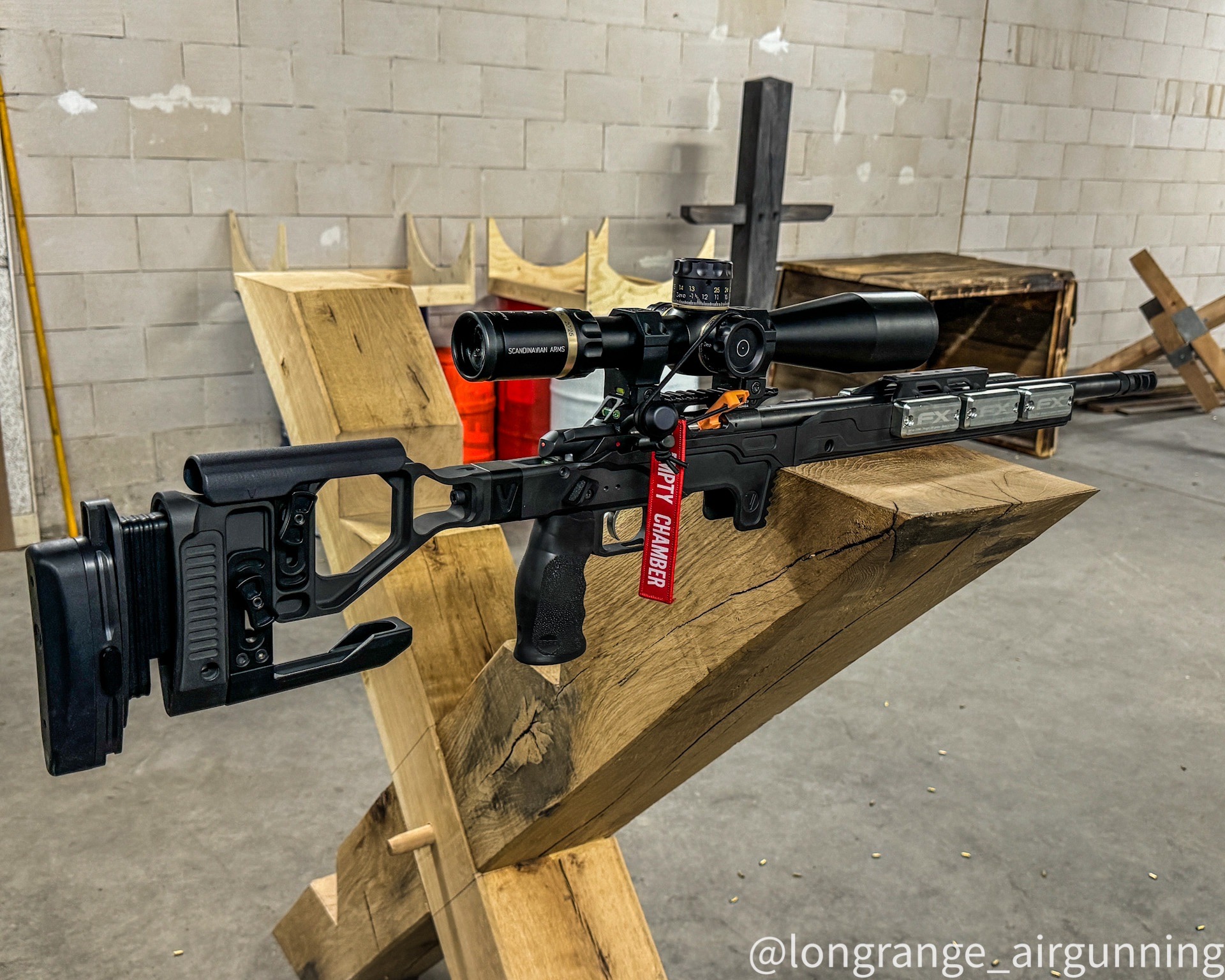

I realized I never replied to my own question with what I eventually bought. I was able to get a good deal on a CZ457 MTR with the 20" barrel and decided to place it in a Vision PRC chassis
I'm still waiting for some parts to finish the looks but in terms of shooting behavior I really like it! Shot my first indoor PRS match with it last week and managed to take 5th place there so pretty satisfied so far! Have shot about 600 shots in total now so it is still going through it's initial wearing in of the bolt etc. Once it's completed as a build I'll post some pictures to finish the thread :)
