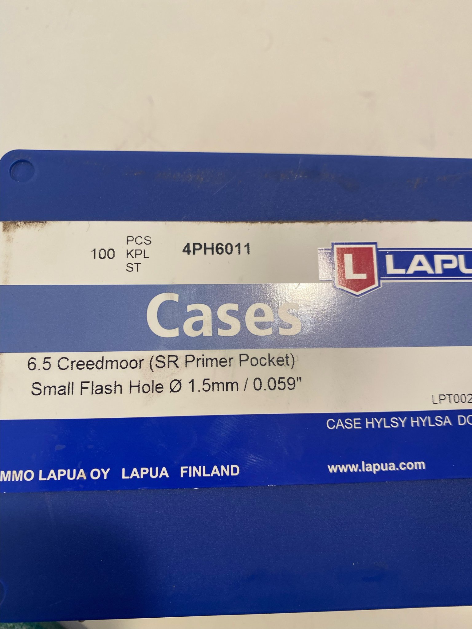

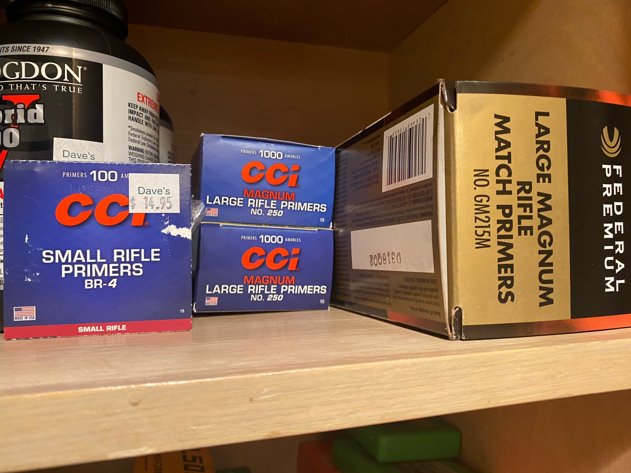

HI all - I am trying to do my first handload for 6.5C. Using Lapua Brass (SR primer pocket) and 147 grain ELD M from Hornady.
In my cupboard I already have three primers (see picture as well): 1) CCI 250, 2) CCI Br4, 3)Federal GM215M.
I am a bit confused as to which all primers will work in my brass. Can someone who has the knowledge help answer three questions:
Q1: Out of these which primers will work for my specific brass (Lapua 6.5C SR primer pocket)?
Q2: If more than one will work, then which one is better in your view?
Q3: Is there any other better option of primer that I should consider?
thanks for your help !

I use Winchester WSR in my Lapua small primer brass for 6.5CM, with no issues. But I'm limited to 500 yards, so don't know how good they are for the long haul.
The BR4 mentioned below is something I'll be checking out if primers ever become available again.
