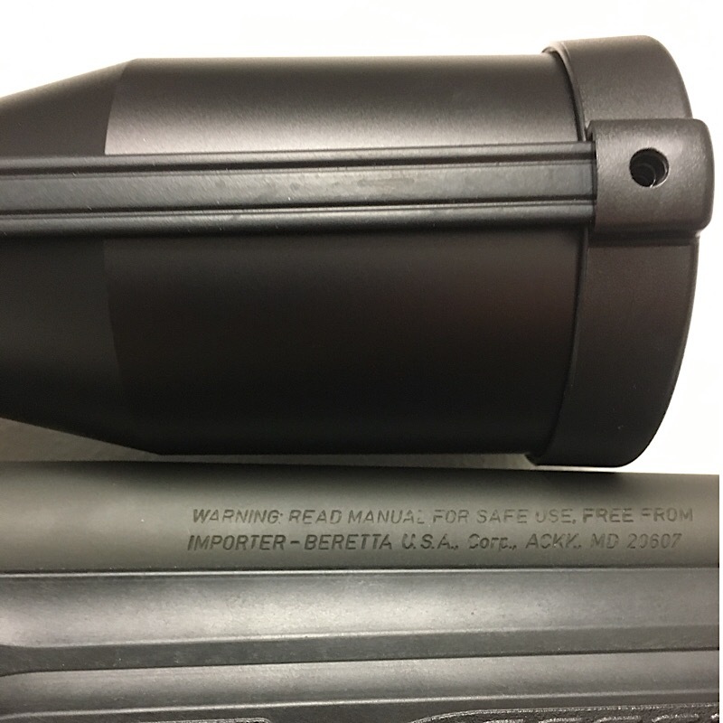

i had to buy Seekins Medium rings .87" for a Vortex PST. Lows the bell was touching the barrel. keep in mind this is still very low but not touching. for hunting purposes you may want to go higher
I have a factory Tikka T3 Varmint stainless, with Ken Farrell 30 MOA base, Steiner 3-15x50MM T5Si with Tennebrex scope covers, and mounted in APA .950" standard 34mm rings. I wouldn't go lower than 0.92" with this combination....
Seekins 30mm lows, 20 MOA Seekins Picatinny rail, R700 LA, Shilen #4, Premier Heritage Light Tactical 3-15x50
Farrel bases are higher than most, I had 24mm ARC rings that worked well 28's with defender caps.
