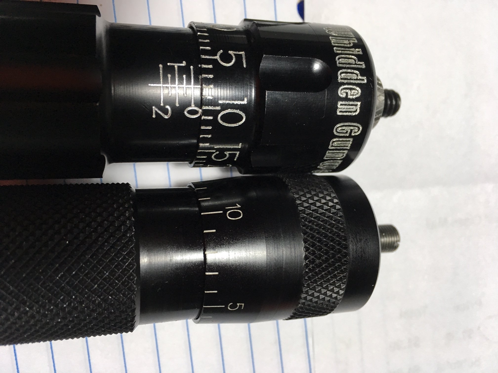

I’ve seen a couple guys here say they like the Forster seating die better.. what are the differences in the forster vs Whidden seating dies?
The Whidden seating die is a dressed up copy of the Forster die. Any meaningful performance difference is due to seating stem angles and such. I have both and see almost no difference, I look to Forster first based on price alone.
Reactions: dbenner1184
I have both and the forster is easier(the markings are wider on forster) to adjust for me (my opinion). Whidden dies are quality die and excellent.
