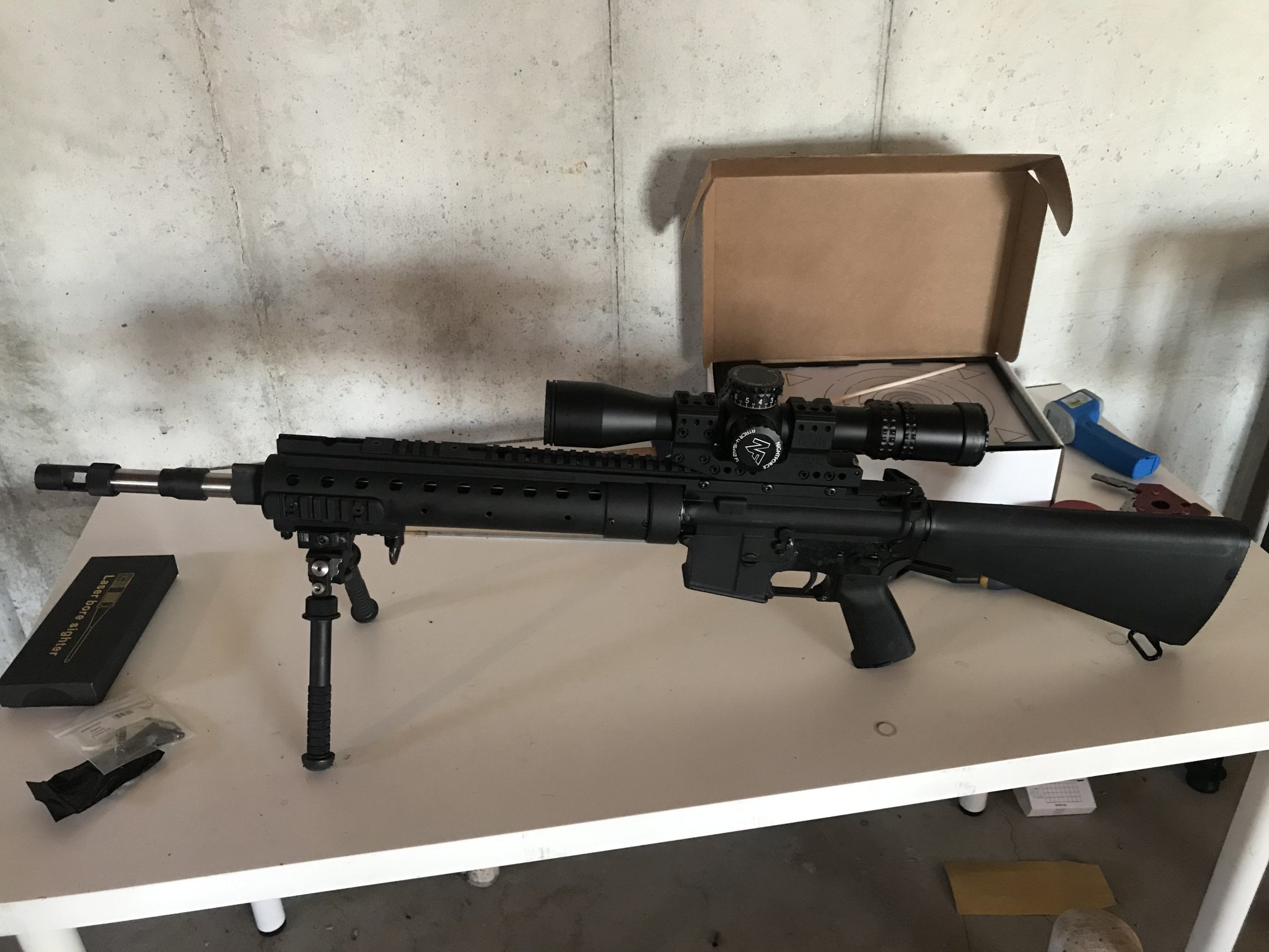

Just shot it for the first time today. About 30 rounds of 62gr FMJ and a couple mags worth of my 77gr SMK pet load. Very happy with the accuracy and the build. Shot MOA or better with the SMKs and 1-1.5 MOA with FMJ. Now I just need to get an OCM5 for this.

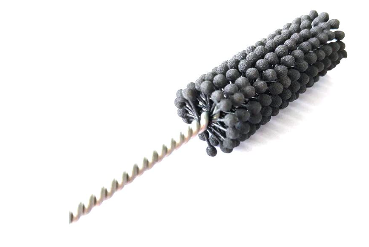

Just ordred a WOA barrel and a Forward Controls Designs gas block. Planning on using this to polish the inside of the gas block vs polishing the barrel. Feel like polishing the inside of the gasblock will be easier to make sure I'm taking off material evenly, and the gasblock is a lot cheaper! Got this on amazon for $17. Will see how it works out. 320 grit and designed for 0.75 inch bores.
Why are you planning to do any of that?
Reactions: TheOE800
Check out post #29 in this thread
I worked my WOA SPR barrel over with some emery cloth and when my patience wore thin I just tapped the gas block in place with a wood dowel. It was a tight fit but not horrible, and I now have 0 leakage between the barrel and gas block, which I am guessing is exactly what one wants. Dont overthink it.
