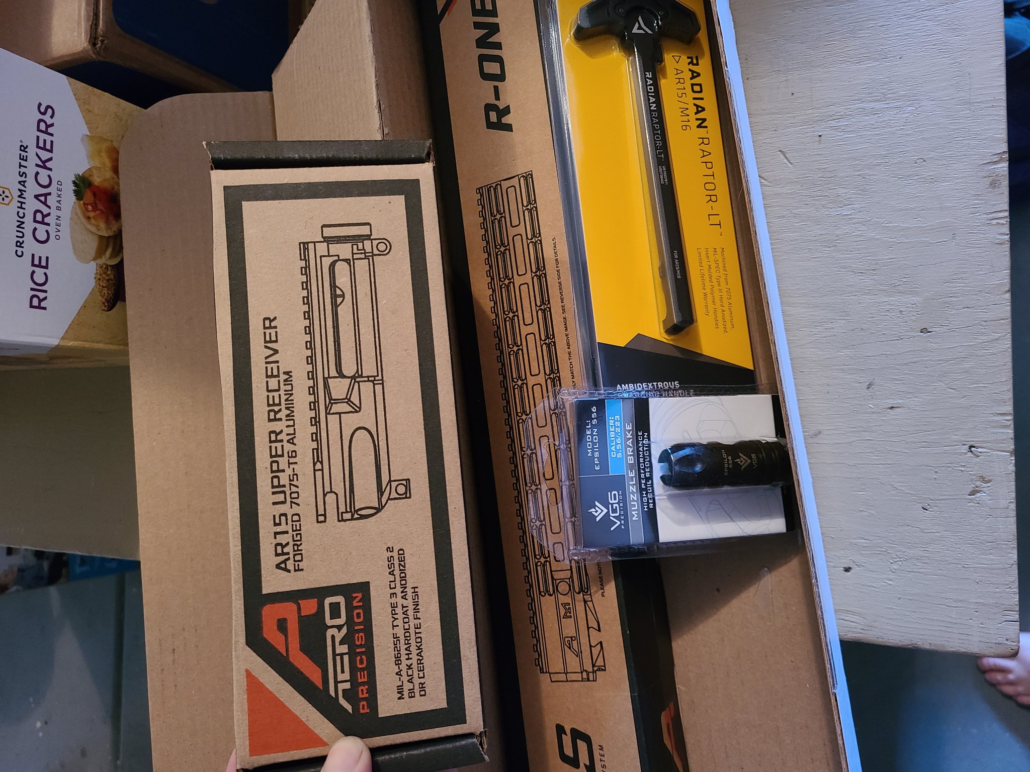

Would a WOA and a basic Aero Precision upper make a decent precision upper? I have $500-700 to spend.
I'll let you know in bout 2 weeks ,that's exactly what I'm going to be using for my white oak barrel.
That is what i used. I bonded the upper and barrel with green locktite. It shoots great. You should be quite pleased.
