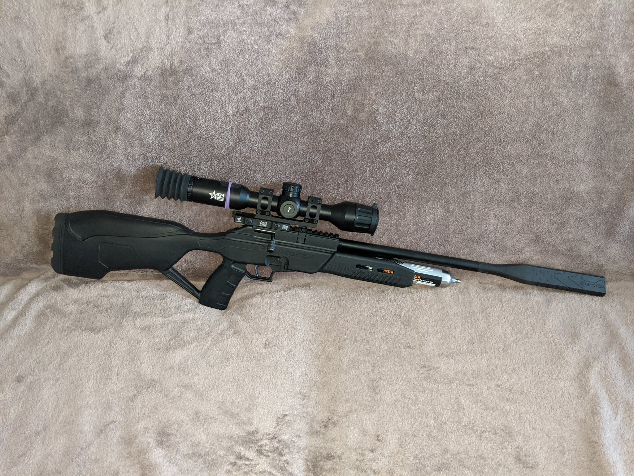

I've always had a couple of springers around, but their noisy.
A few years ago I ventured into the PCP world with a marauder .22 and then a big bore 9mm rifle with a clague LDC for hunting bigger critters.
I sold the marauder as it was too much rifle for what I needed it for and bought a Umarex Fusion 2 .177 cal co2 rifle that I semi converted into PCP for smaller pest hunting.
After varmint season ended I mounted my backup Adder thermal on it and have been wreaking havoc on the mice and smaller pests.
The Fusion 2 has been more than capable at the short ranges I shoot and it's deadly accurate with JSB diabolo RS pellets.
Maybe when it shit's the bed I'll upgrade to a real PCP rifle, but the prices for new PCP'S these days is freaking crazy.
I don't really need a high powered rifle for the 10-15 yard shots I usually take and I don't want to worry about ricochets either.
