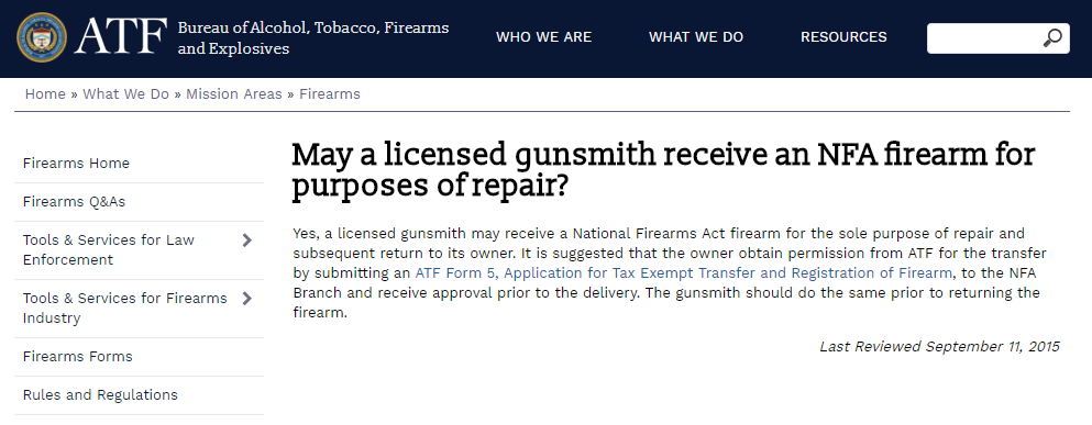

Just in case anyone wants the word from the horses mouth.
