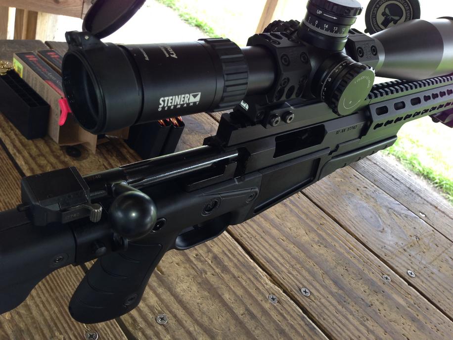

A while ago I was finally in a position to purchase my first high end scope. Without being able to compare the top 5 and choose, I settled with a Schmidt and Bender(Not that I would consider that to be settling by any means). A while after I ran into someone who had a Steiner mounted and had the opportunity to compare. Immediately I noticed a difference in the eyebox and how much more comfortable and forgiving it felt to me. As for quality of the glass, I would not consider myself at the experience level to have been able to tell the difference so there was no difference in that aspect to me. Not too long after I was presented with a very good deal to sell my Schmidt for a Steiner and pocket $1000, so I did. One mistake I made(clearly a rookie mistake)was while comparing I did not engage my target at max(25x) power with the Steiner. Now I notice it every time I max my scope and even have a tendency to lower the power to obtain a thinner crosshair. I will start shooting past 500 when a new range opens down here next month and will clearly find myself bitching about that reticle, especially having shot the P4fine on the Schmidt. Now I would probably do as much bitching if I had to deal with a less forging eyebox again considering I believe Steiner's is the most forgiving. So what I would like to know is would anyone know of a thin reticled scope like the P4fine with an eyebox as forgiving as the Steiner. Ultimately if Steiner had a thinner reticle I would not be posting this. Hope to hear some good news, Thanks to all.
OK, So yes the Steiner has the best eye box, no doubt. But as stated at 25x the MSR is annoyingly thick, as well you might notice some little burrs on the reticle itself. I have most of the high end optics and really at that level I fool myself in thinking I can tell the difference in glass quality. Really they are all very close, too close to tell most of time. I love my SnB p4f 25x but I really find that between eye box and nice reticle at high power the Premier 25x GEN2XR is the best of most worlds. It is hard to fault for me.

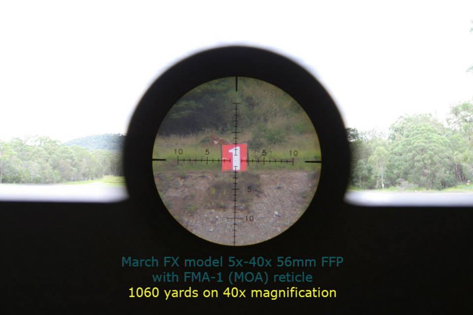

We'll see in a week how this one looks up close. March FX 5-40 FMA-1 moa reticle with full illumination. Simple, easy to read. I think this is what I'm looking for. Fingers crossed.
You should be pleased with the March FX 5-40x56. I own both the mil and the moa version. Glass is excellent, turrets track true. The reticle is very well executed and the floating dot allows very precise aiming point. I own or have owned all of the scopes mentioned in this thread (sold the Steiner). I could have said this for several of the other scopes mentioned here, but you made a good decision in my opinion.
