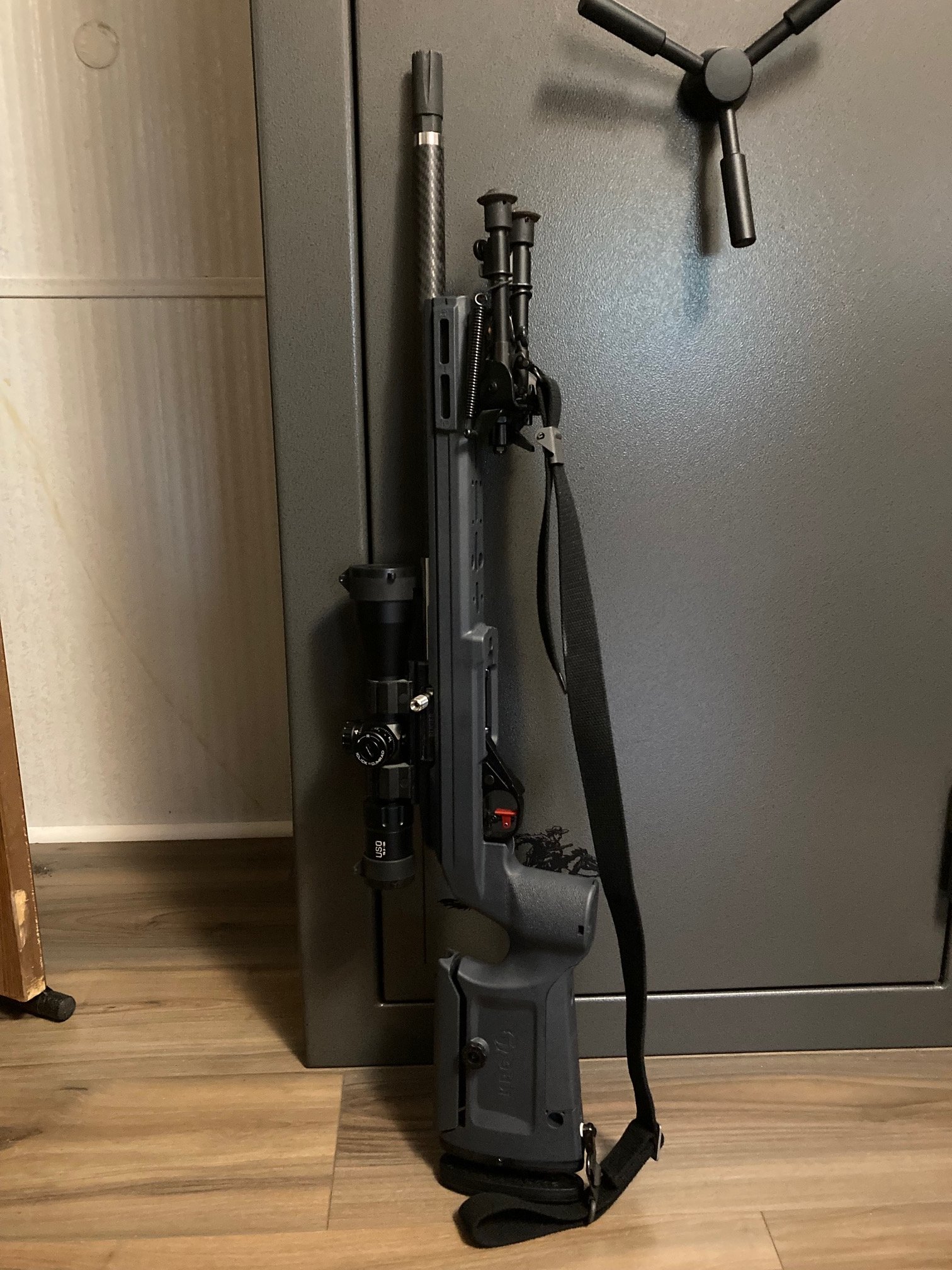

The only things factory left in mine are the receiver housing & bolt body. Everything else is Valquartsen…
Reactions: johnnyvw and Franko

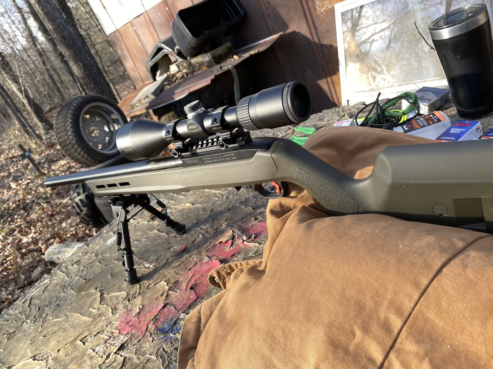

I got a barreled action that had a green mountain 20” barrel already installed from a buddy of mine and dropped it in a krg bravo and put a bx trigger in it so my kiddo could have a rifle to learn on.
I have found myself taking it to the range more than a lot of my other rifles because it’s so easy to shoot and gets way better groups than it deserves to for how much i have into it.

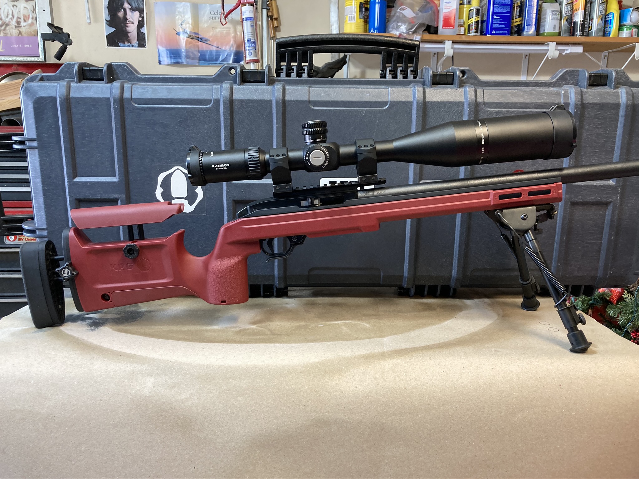

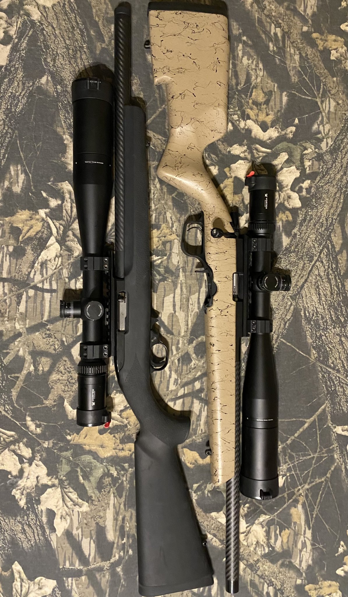

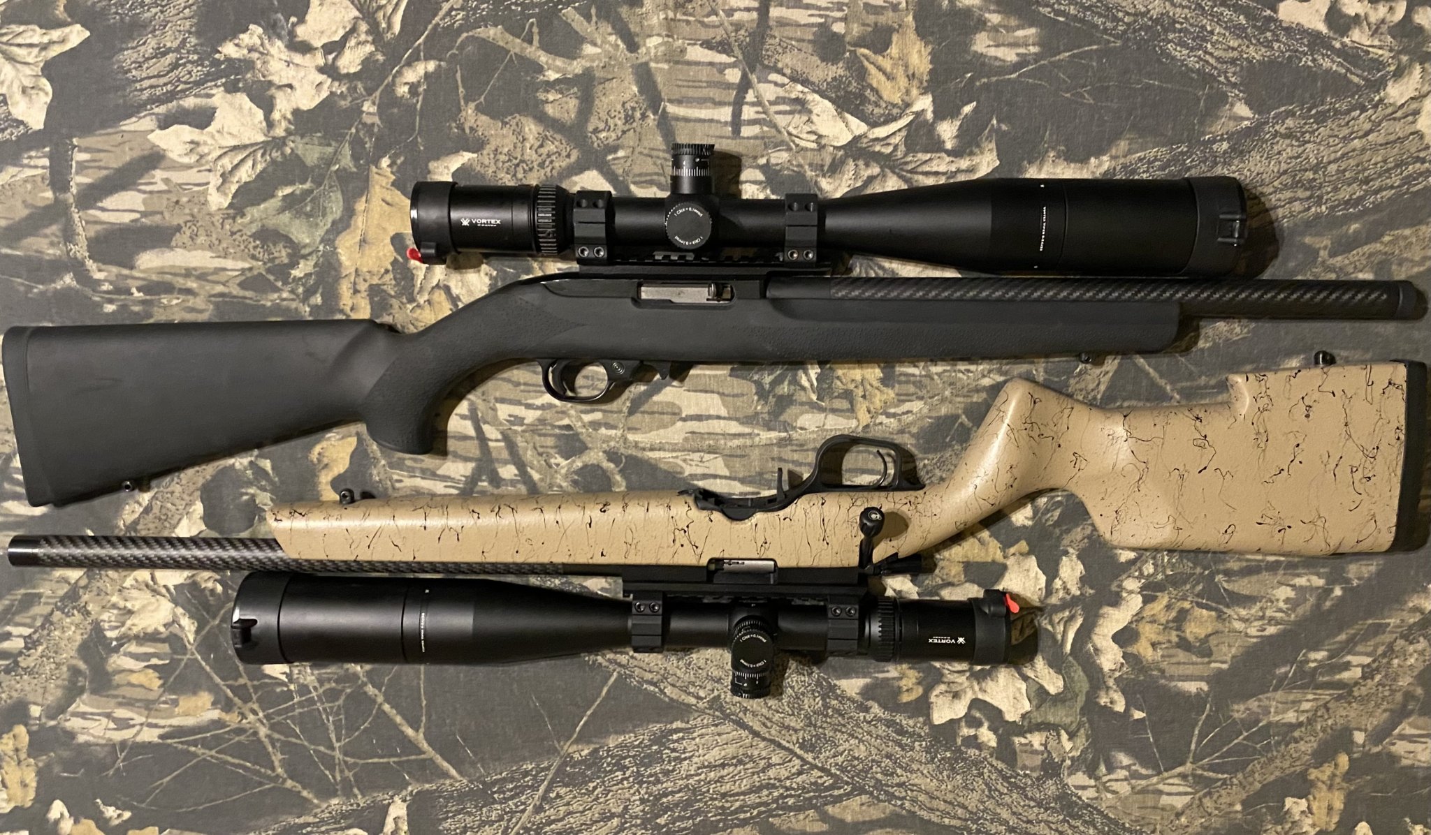

This started out as a basic wood stocked 18" carbine. Like you, I wasn't impressed with the accuracy.....good enough for plinking, and it did get me a few Appleseed scores in the mid-230s, but compared to any of my other rifles, it wasn't up to snuff.
VQ tensioned carbon fiber barrel, Timney Calvin Elite trigger, KRG Bravo chassis and a few other doodads. Everything was purchased on Ebay a little at a time over a few months. Now this little 10/22 can almost keep up with my B14R.

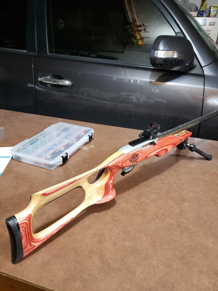

I used JWH bolts on the rifles I built for my nephews, they have their initials on them, pic is above. Those stocks worked well, pretty sure I got them on Ebay. I added a brass bolt that indexed with the rear cleaning hole in the receivers and added pillars when I built them. Now I'd probably get the titan or Bravo stock. The titan indexes with the trigger group to act as a second anchor. With a wood stock you can always cut it down if needed. I found a couple sites selling used receivers, both bare and complete. For a kids build these would be fine, polish up the stock bolts and the inside of the receiver, send the triggers to Brimstone to clean up and and a buy a Green Mountain barrel when they're on sale. You can go hog wild but it's not necessary. A barrel and better trigger gets you most of the way there.
Reactions: Franko and The D
Awesome info, thanks

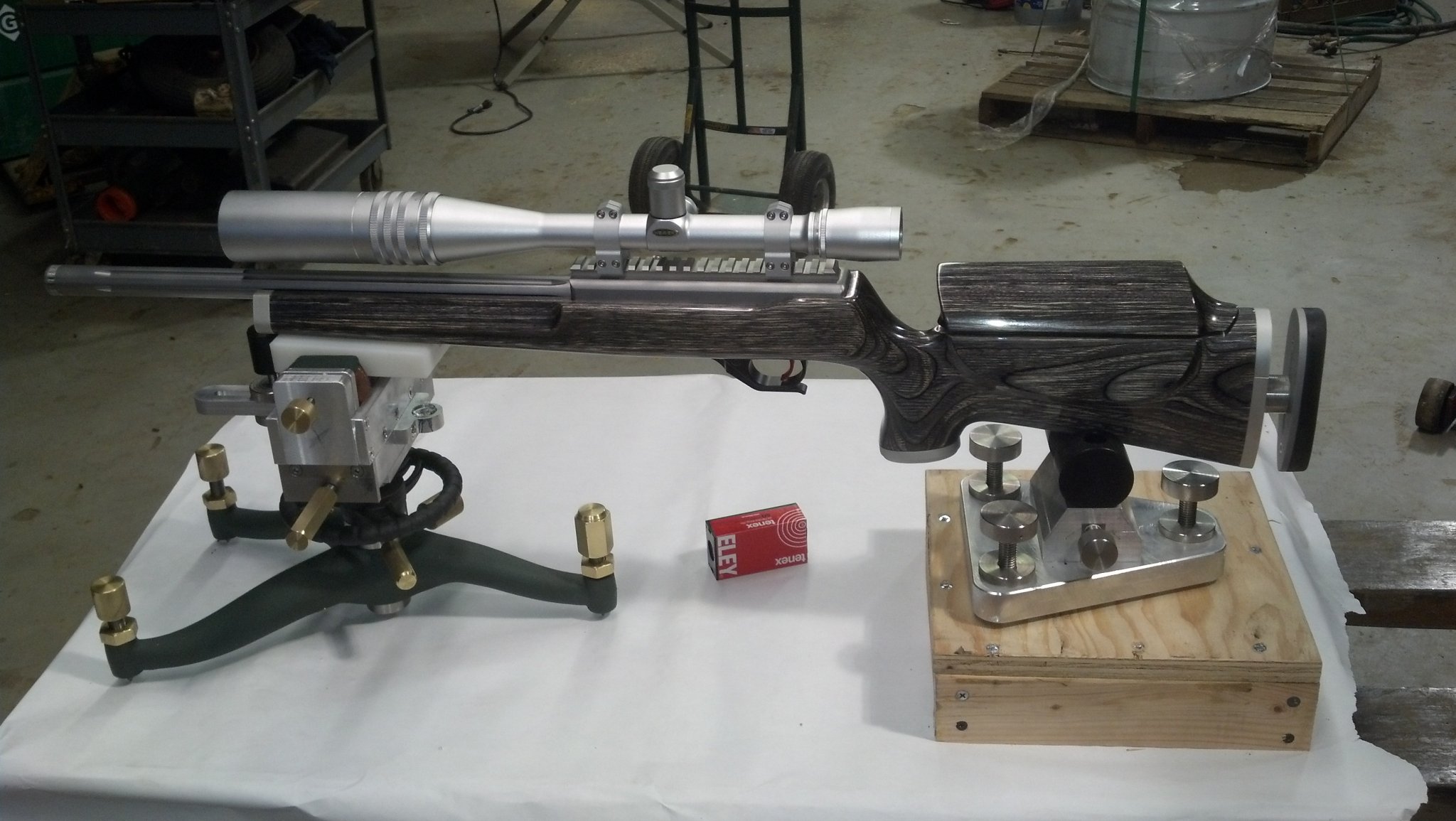

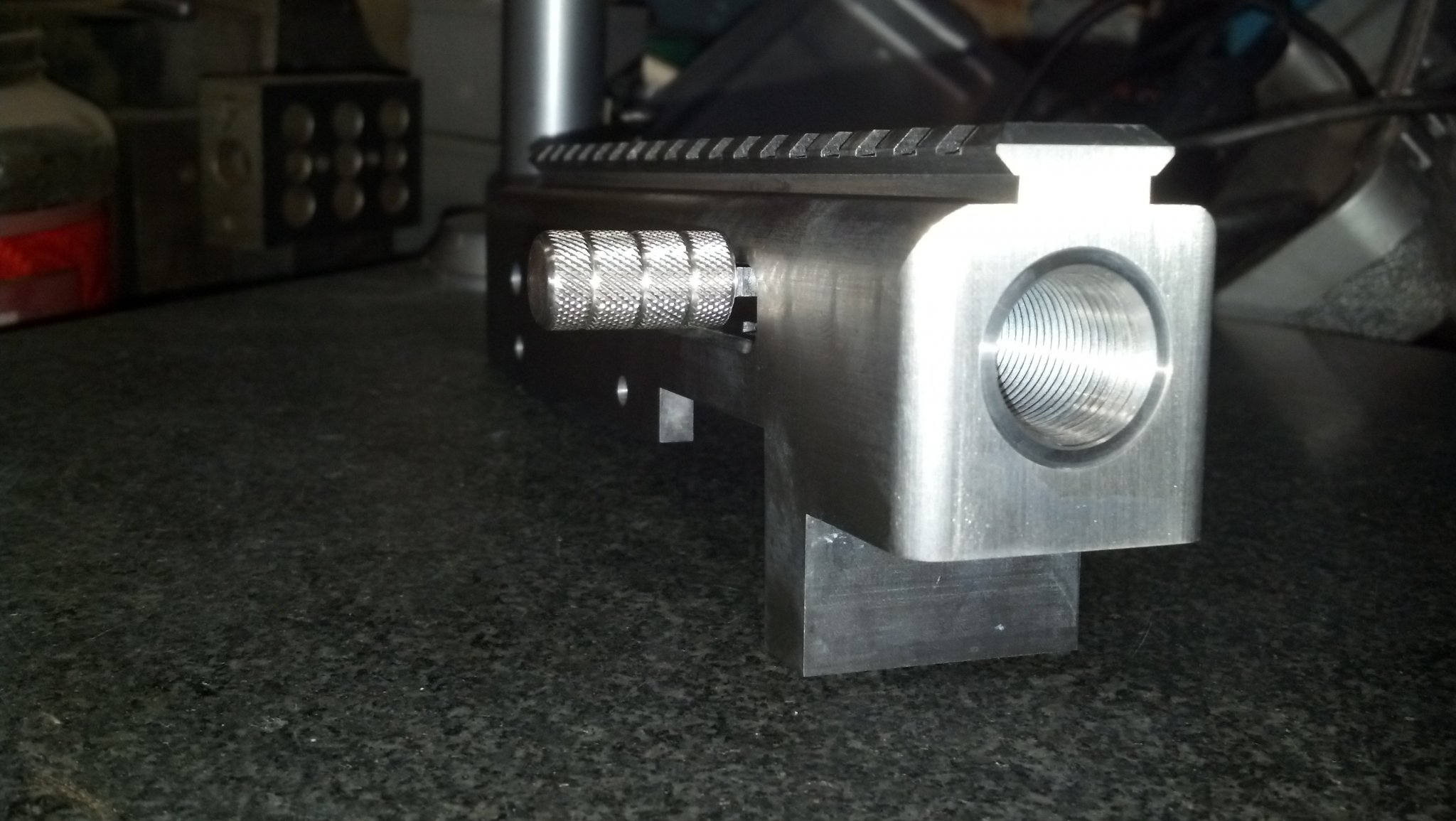

I have two of them that I have done 100% of the work on. All that remains Ruger is the receiver and the bolt assembly and I trued and head spaced the bolts. Truthfully if some one were to hand me a brand new 10/22 and say "It's yours as long as you don't change in any way" I would hand it back and reply "Thanks, but no".
Reactions: Dank27 and Franko

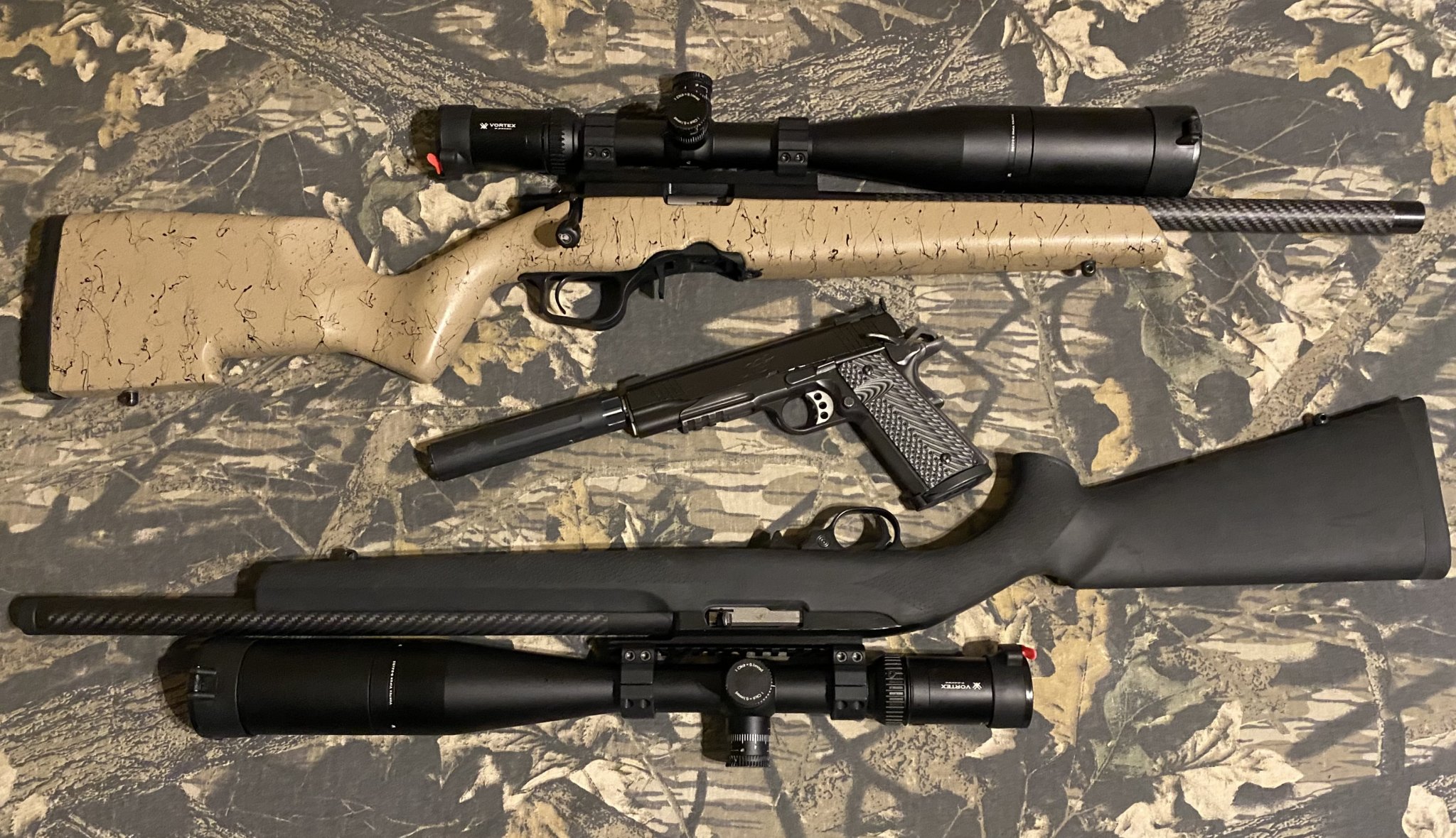

Reactions: Franko
I have decided to keep it as is for sentimental value and as a general purpose beater for friends and family. I'll just save up some money and go with a full Kidd build without messing around with "mix and match".
