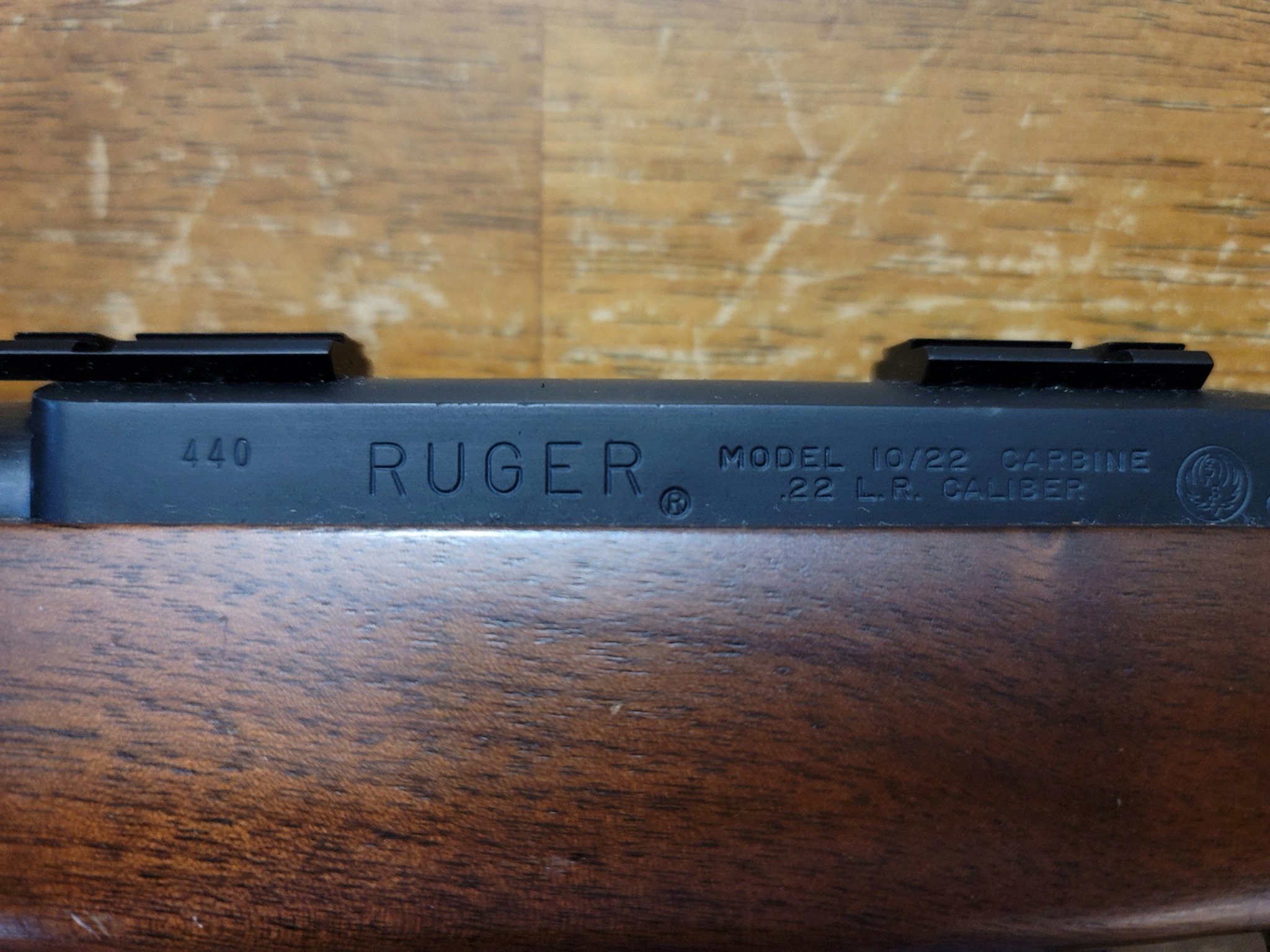

I own a 10/22 that I don't shoot because it's not particularly accurate. Usually I would sell the gun in this situation, but will not because I inherited it from my grandfather. I am now looking into upgrading the heck out of it to make it into a super accurate lightweight plinker (he used it to hunt squirrels so I want to be true to what the gun was used for by him) . Here are my questions:
Kidd (ultra lightweight or lightweight) or Volquartsen (carbon fiber barrel) or something else?
I am looking at a KRG Bravo stock, is there anything else I should be considering?
I expect to upgrade most of the Ruger parts to Kidd parts. Are there any parts made by Volquartsen (or anyone else) that are better than the Kidd version that I should be considering?
Thanks all.

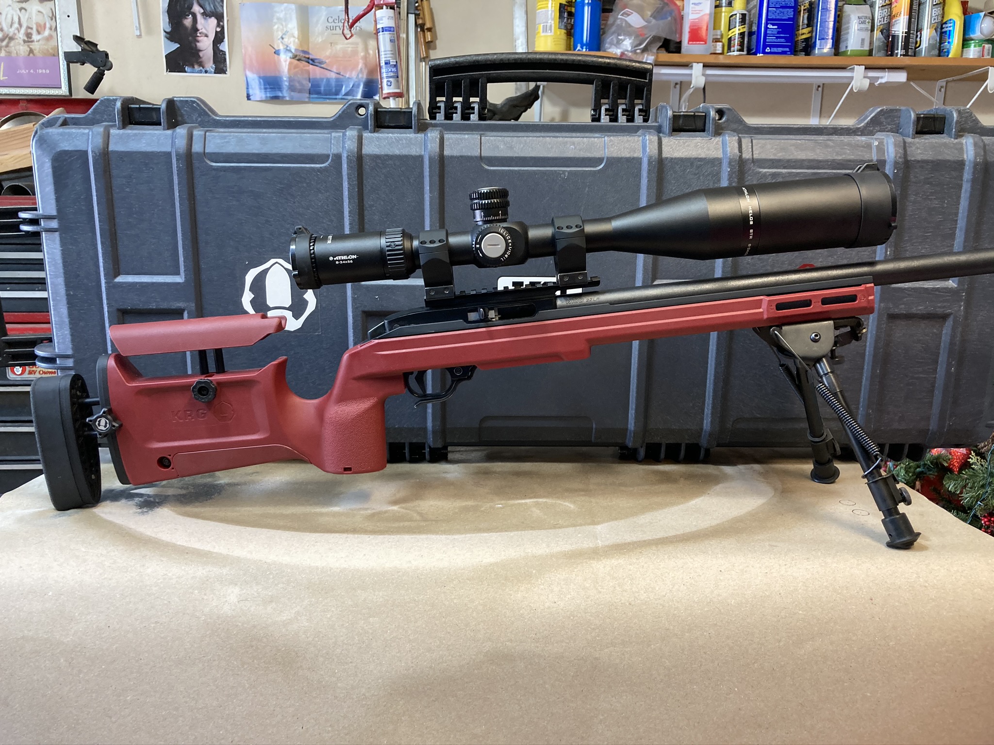

I just started one, so far I have reworked the factory trigger to 2.5 lb pull, installed a Shaw match heavy barrel 20" and a Magpul hunter stock, started breaking the barrel in last week i expect it will be close to the same hole at 50 yards in the near future using wolf match ammo. Good luck have fun
Did you do anything yet? It sounds like you probably already have some more precision oriented rifles. I'm not keen on 10/22 precision builds. If I had one, I'd probably still shoot my Tikka or I wouldn't have one at all because I sold it to fund a Vudoo.

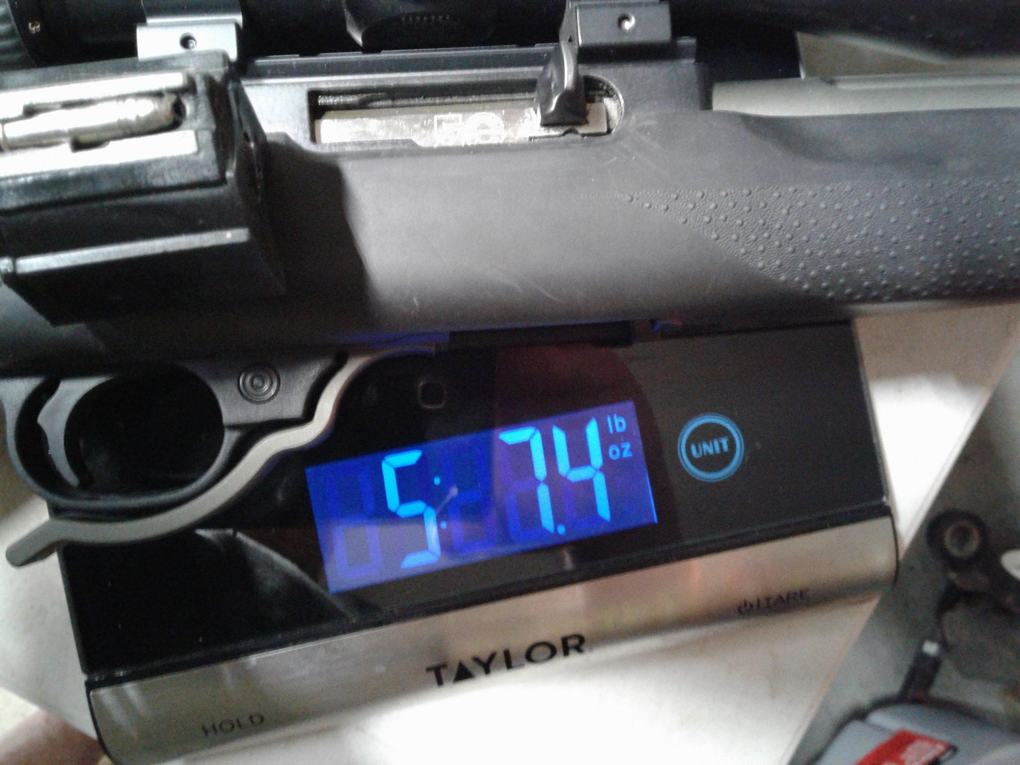

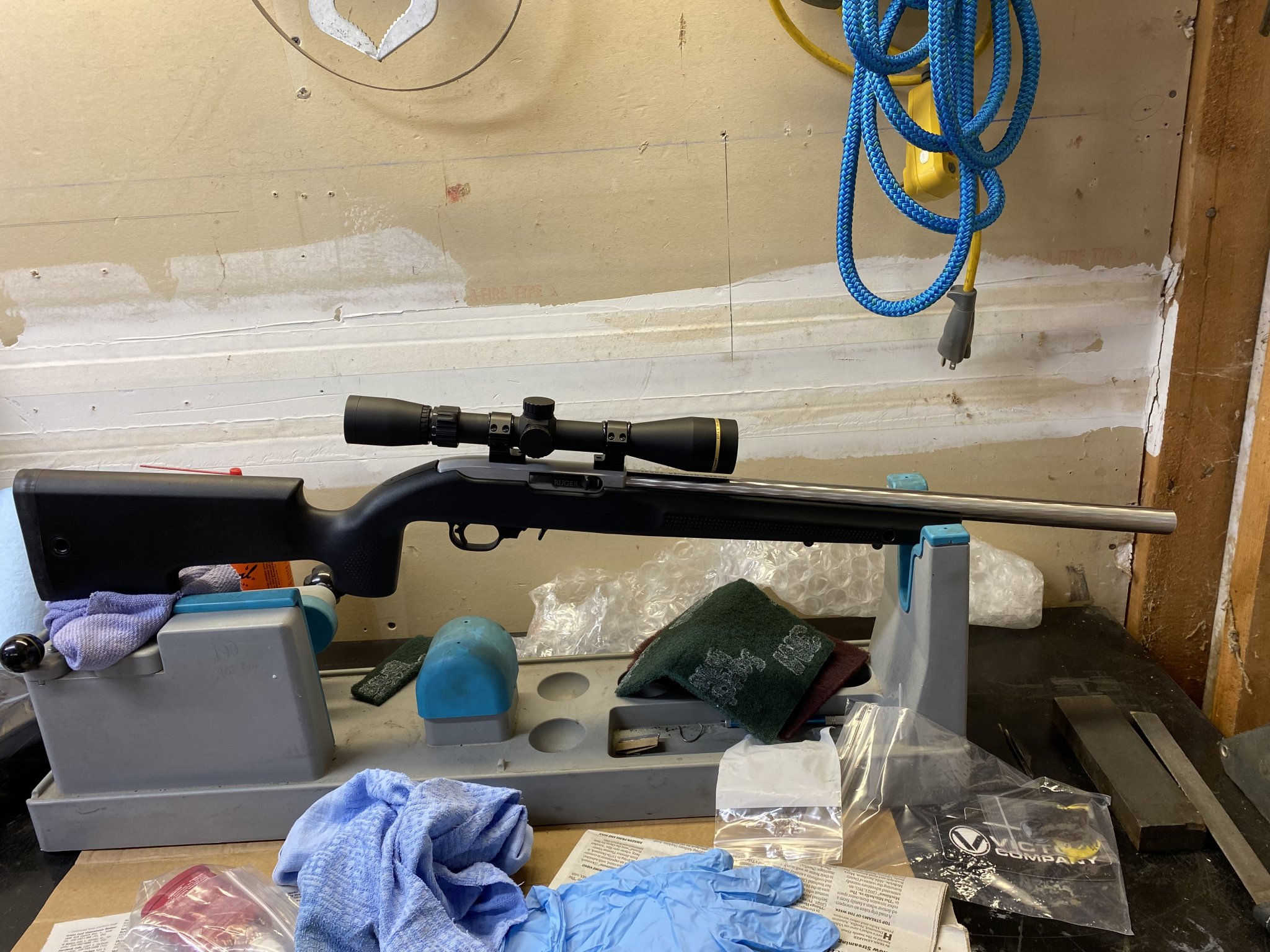

I recently upgraded mine with a Shaw heavy match barrel, new Leupold scope 4x18, Magpul Hunter X22 stock. I filed and ground the trigger myself ( very simple) 2 lb pull and polished the action. And it shoots good ammo as well as any of the others and bad ammo good. I shot last week at a local IBS rimfire challenge and shot a 250 with 7x. There was a guy next to me shooting a full blown Kidd and he shot a 250 with 3x so unless you are going to strictly shoot matches why spend more than you have to ?

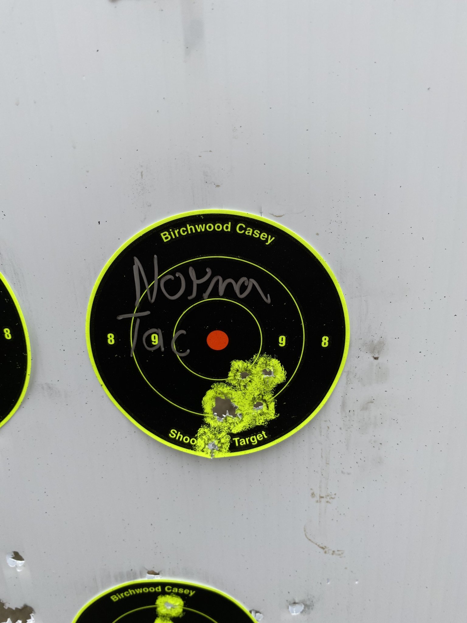

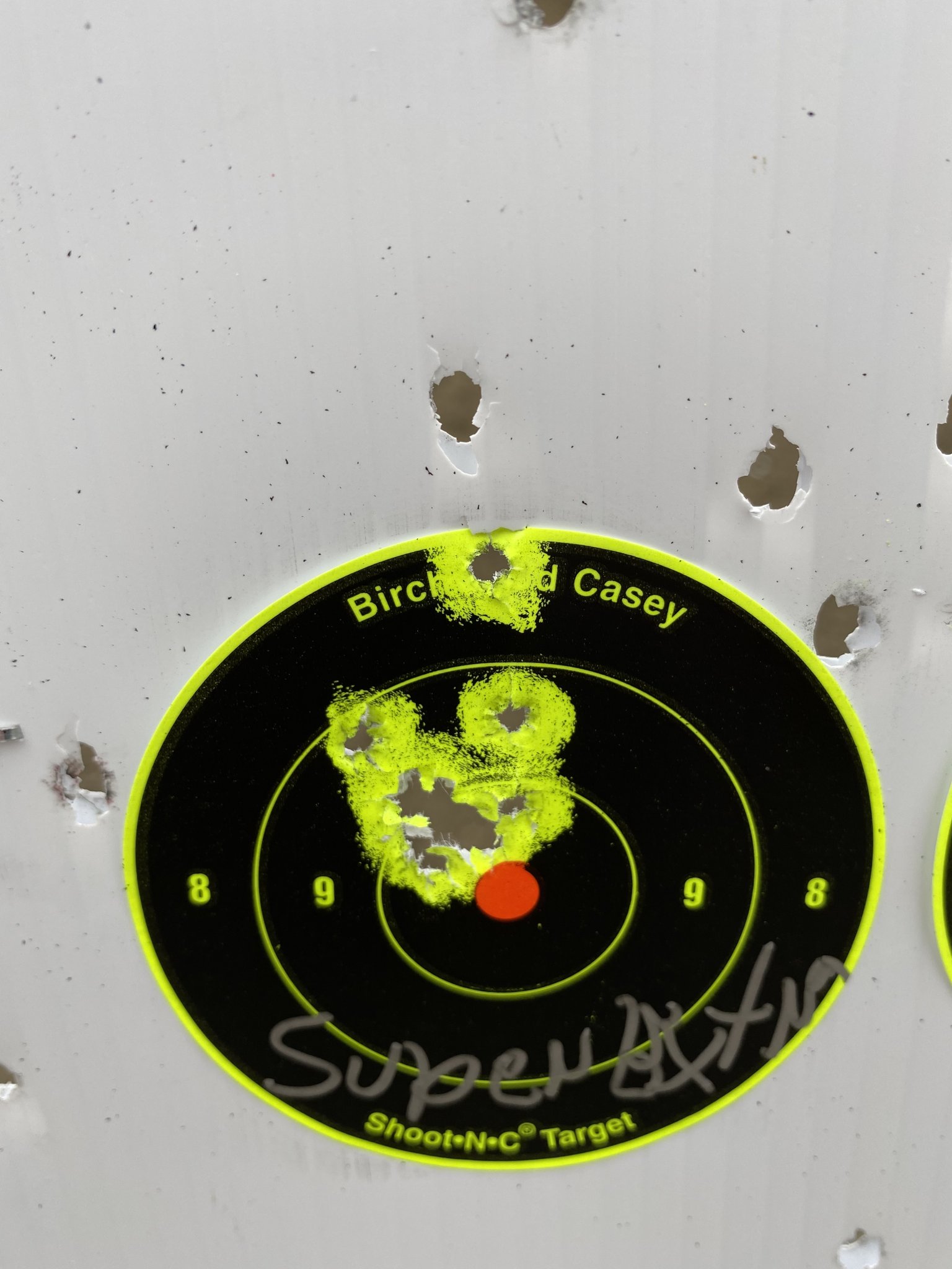

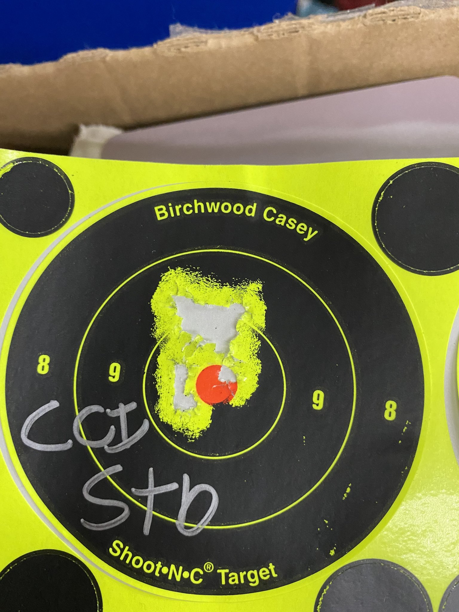

Update: Finally tried a few Eley ammos all under $8 a box(my imposed limit to not get hooked on pricey stuff). Eley target got me three 1/4” 5 shot groups at 50yrds in a row Eley force was close behind. With a 3-9x scope and it was a little windy that’s perfect to me with a factory barrel. Don’t give up on your target model Randy builds an excellent combo for dollars spent.

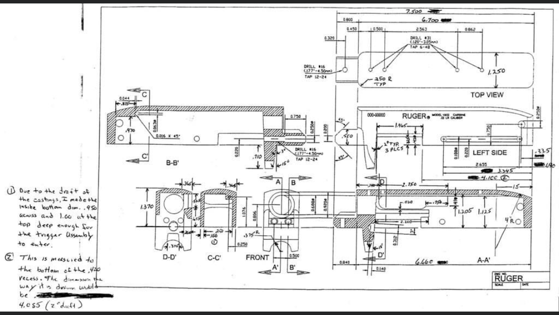

Do you know where I can get the drawings of the receiver?
I found one online when I built mine plus I was taking measurements from a 10/22 and then adjusting them to fit the bolt tighter. The outside dimensions I just made larger to fit my liking because I knew I was making a custom stock.
I have and it is worth it. His page will tell you what he does.

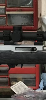

Are these bases OK, or should I go with a one piece base for better accuracy?
Unless there is some dimensional issue with them it's not going to effect accuracy. The reason(s) for 1 piece rails are to allow more optic positioning options or to allow greater elevation adjustment range with an inclined rail.
