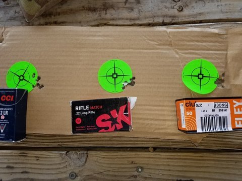

I like mine. Im satisfied with cci sv, but for a a few cents more Eley Club works a little better (pic @ 50yds). The Tenex was stupid good the one time i tried it.
