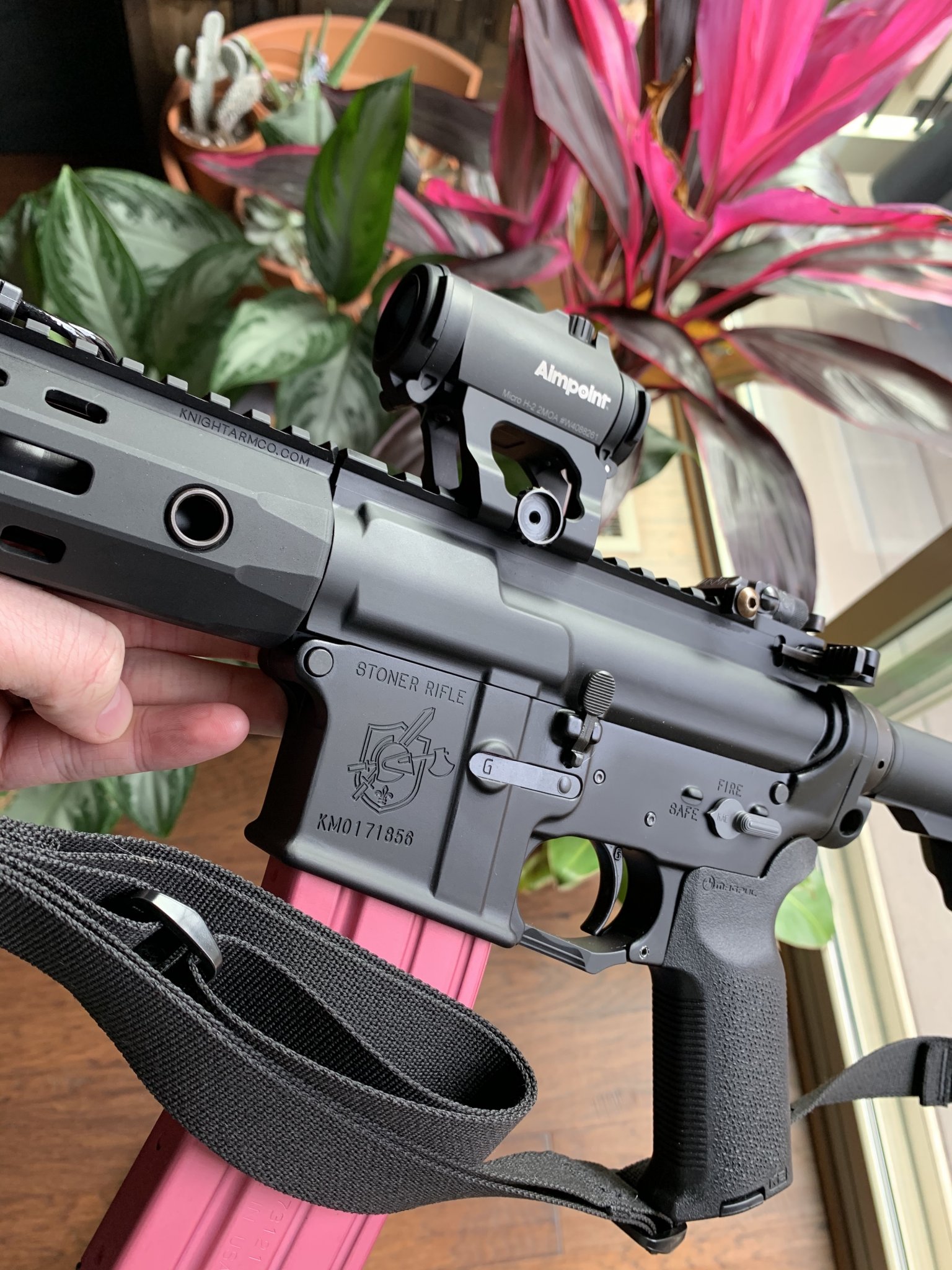

My limited experience with Noveske indicates they may be tight. Gen 1 forged set is what I have. Could be what DD uses for barrel extensions. Rainier Arms logo uppers are or were Mega/Zev made. The forged uppers are money.

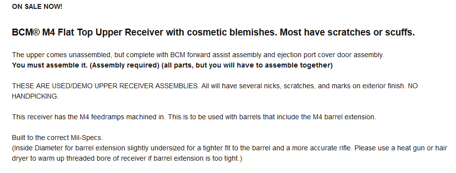

I just ordered 2 x BCM blem thermal fit uppers for $127.00 & free shipping. 1 is slated for a 350 legend getting ready to go together.
BCM is the only upper I've ever seen that puts it in print that it's undersized and will require heat to assemble.

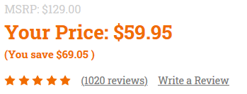

There are 1020 reviews for the "Blem" thermal BCM uppers and it's 5 star.
