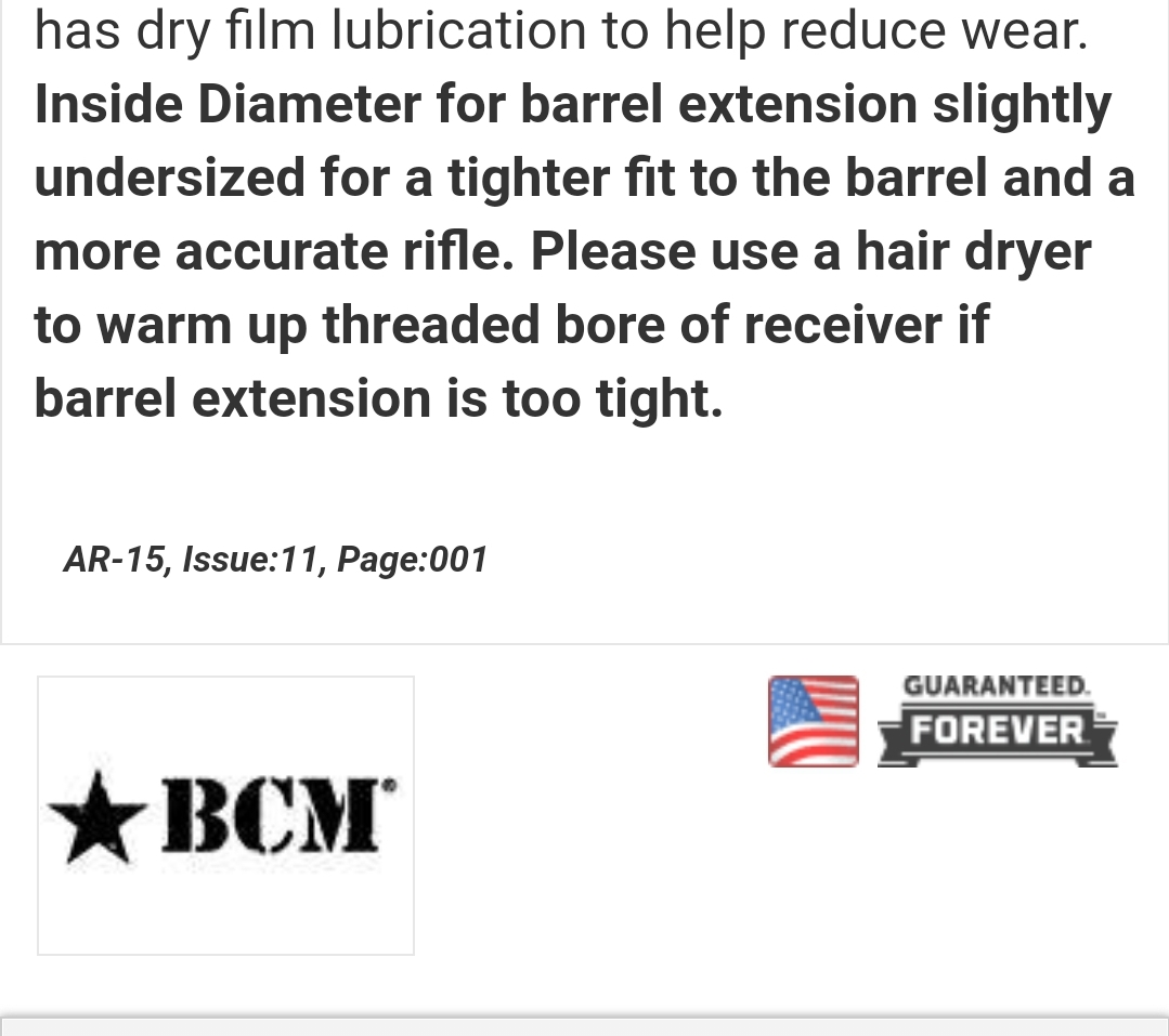

It depends on the barrel extension. BCM are absolutely on the undersized/minimum end of the spectrum and MOST of the time require thermo-fit, but not 100% of the time. I've had 3 different barrels the past 2 years that had undersized extensions that slid right in on BCM uppers.

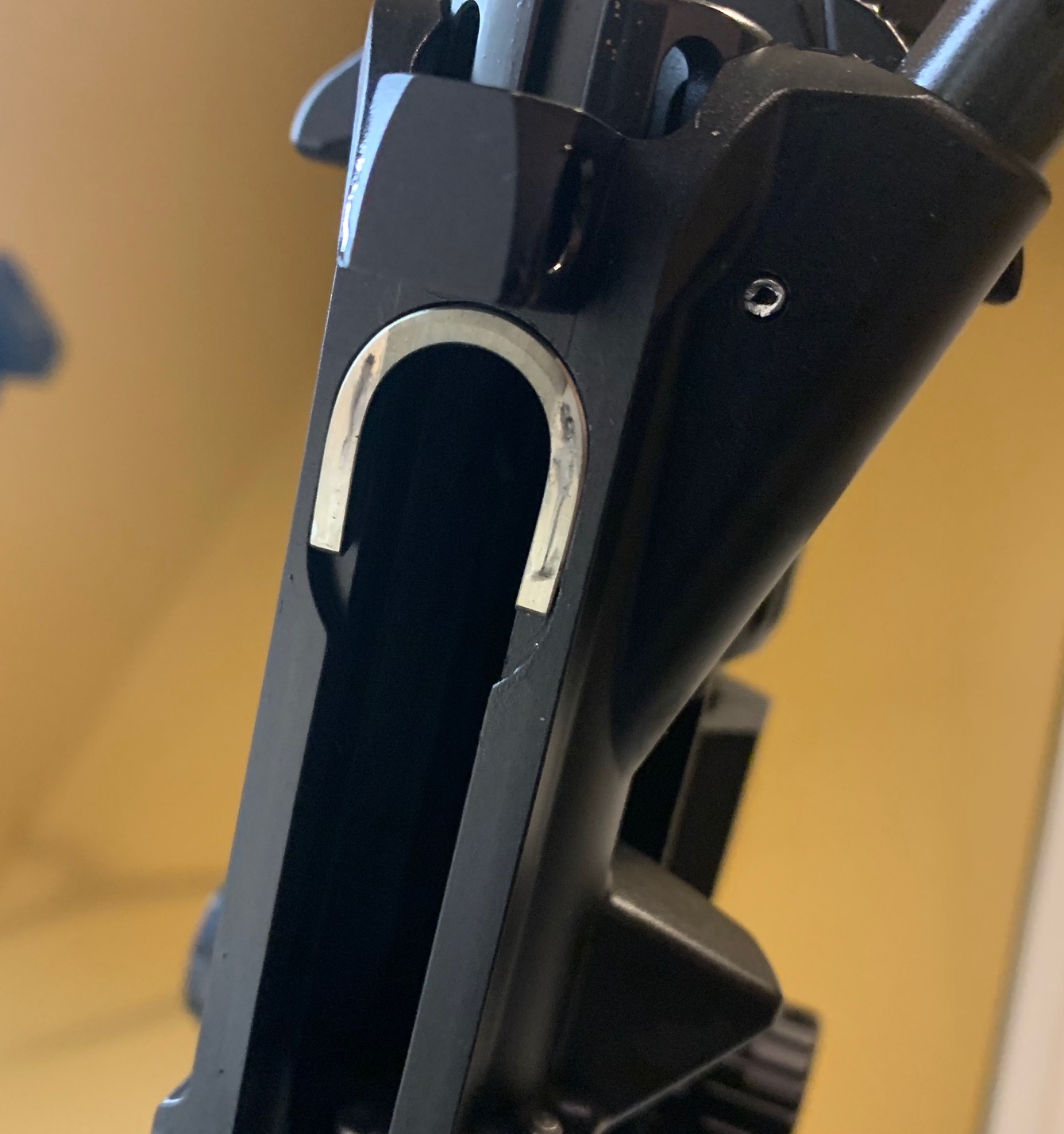

Bcm upper do have a slightly reduced barrel extension opening on thier upper recievers. All 6 of the uppers i have from them have had to be hit with heat in order to install the barrel. In fact BCM acrually inserts a small typed/copied note explicitly stating this.

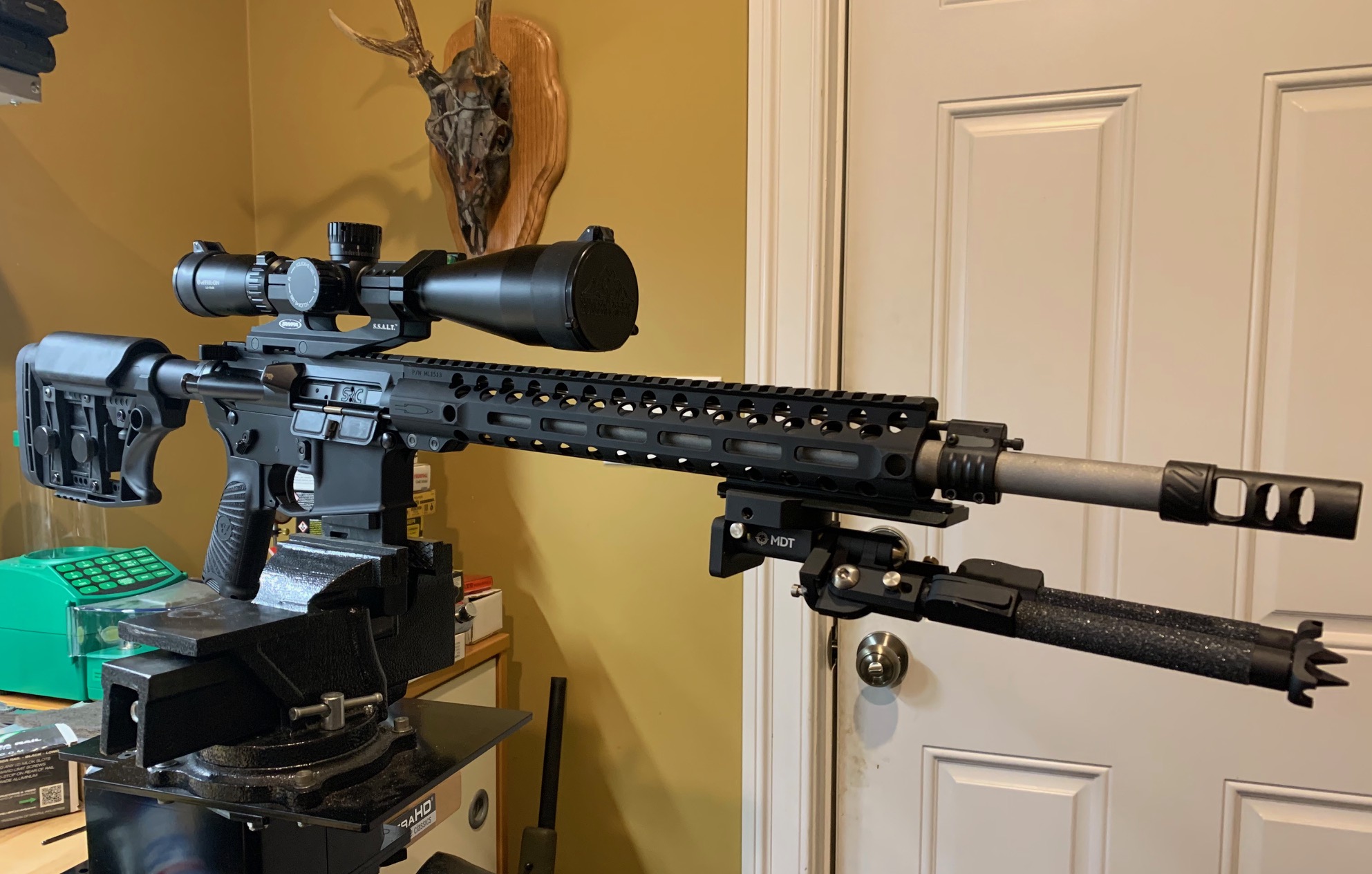

BCM - M4 Blem .224 Valkyrie 18" Craddock criterion 7T rifle +1" gas is showing some promise with factory FGMM 80.5 Berger's.
Shot using a Gen 1 Ckye pod, rear bag, & trigger is set @ 3lb.
FGMM 80.5 Berger's
Cheapo American Eagle 75gr TMJ
