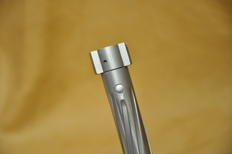

You can definitely see similarities to the Bergara bolt (Shilen pictured).
