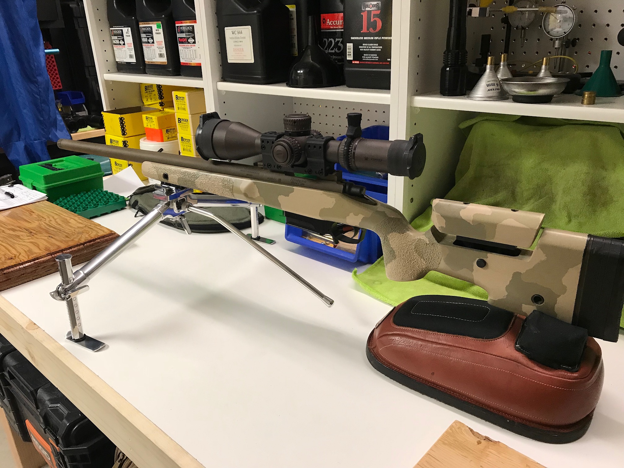

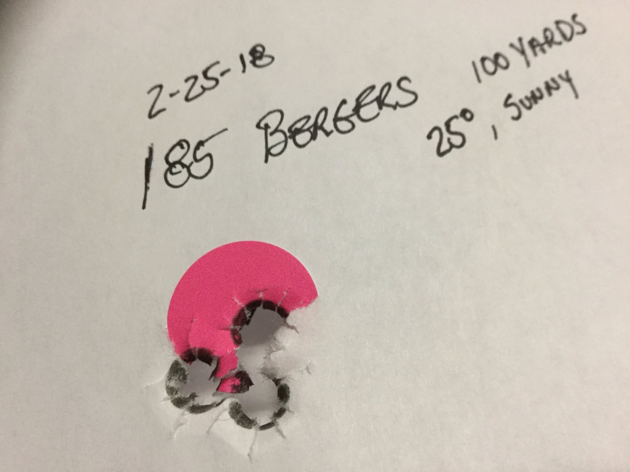

    I just came back from the range today with my 308, i run the bergers 185 jugs. I have a heavy varmint barrel 10 in 1 twist 24” cambered in national match, so it doesnt have a long throat. I use this gun for prs and f-tr matches.

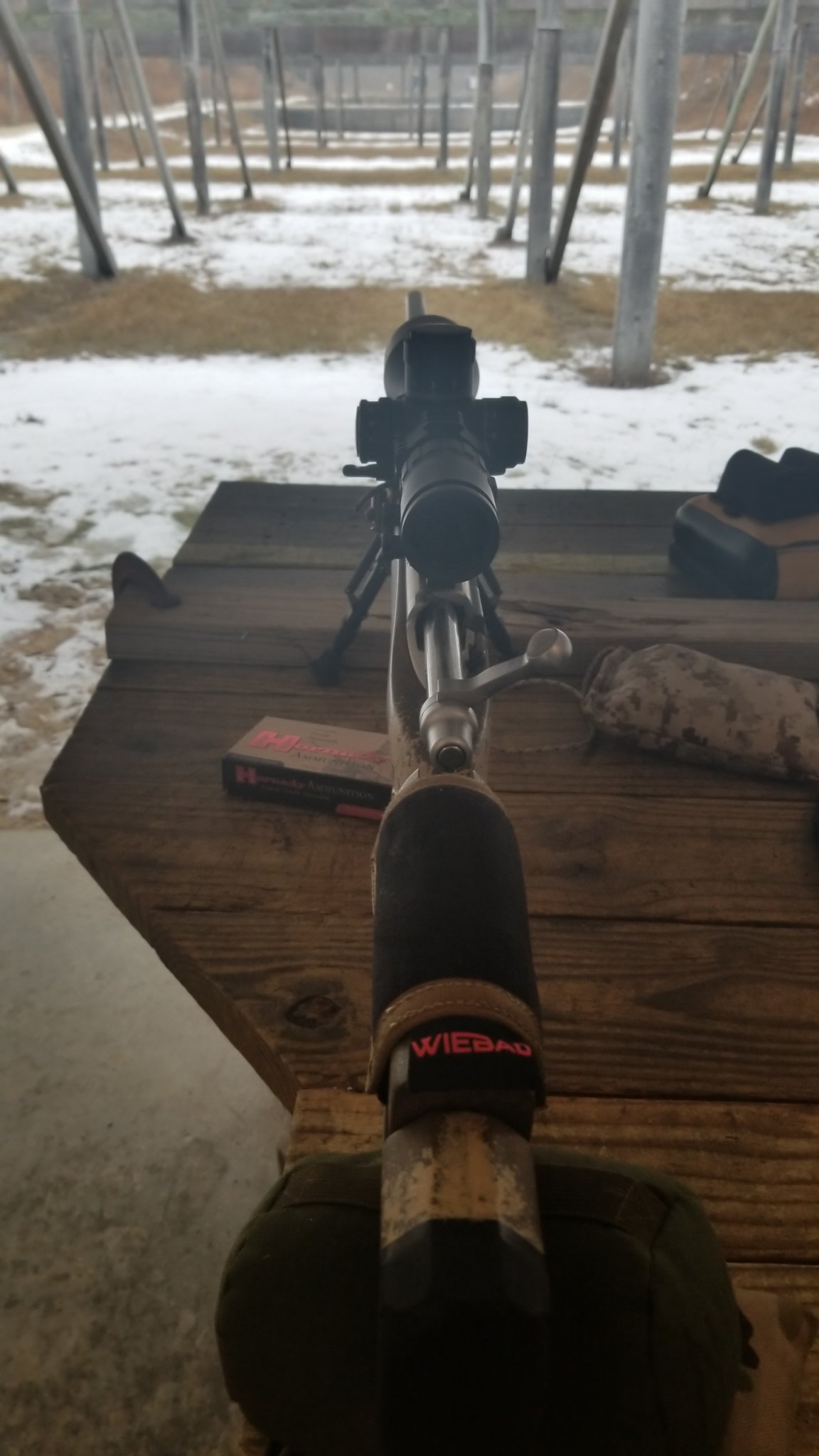

    Damn my 22” AXMC barrel is super slow compared to Franks. Im only getting 2664 FPS with 47.8 of 2000 mr. Yes it has been tested out to 1300 yards and is spot on with my LabRadar. I would say it’s 1/2 moa or better also.
