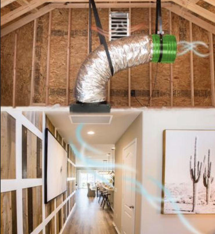

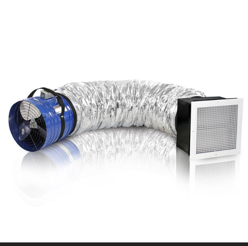

I've been looking for ways to reduce some of the power usage around my house. The A/C unit sucks the most energy during the summertime. The cost of solar still doesn't make it cost effective for me yet in my area.
Looking into whole house fans as an alternative to using the a/c all day long. I understand they are to be turned on when the temp outside is lower than inside. Also considering having an attic fan installed to reduce the temp during the daytime.
I found this company during my search https://quietcoolsystems.com
I don't know much about these so just wondering if anyone has any experience with these units. I remember them being loud when I was younger but wondering if technology is better nowadays.

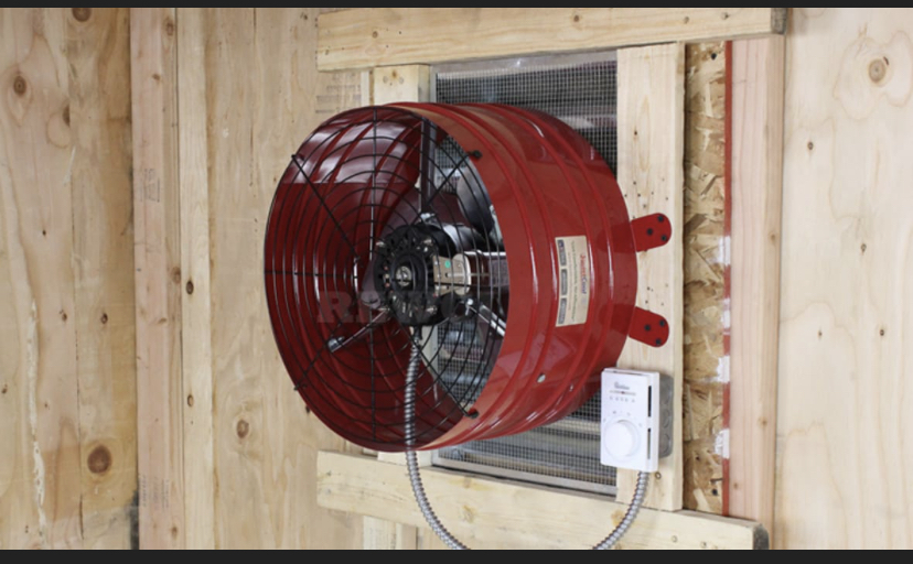

Just installed a QuietCool attic fan. Works great. Brings the attic temp down nicely and helps the AC ductwork to run cooler and more efficiently. Comes on automatically (high and low speeds) at temps I set with the app. Easy operation with WiFi. Looking at a QuietCool whole house fan as well. Several friends have them and are very pleased. Not looking forward to more time in my attic however...
I have installed a few. The quiet cool ones are pretty quiet and the way to go. They are nowhere near as loud as the old belt driven ones that sound like a prop plane inside your house.

OP, are you looking for an attic ventilation fan or a whole house fan? They are two different animals. An attic fan only exhausts the attic space with incoming air via soffit vents or other roof caps. A whole house fan is to pull air through your living space and is often a "heat exchange" device.
You can PM me if you wish. I'm a retired HVAC engineer/contractor and also was an advisor on a couple of code committees.
Sounds like he’s looking for whole house and has done some research. Some pics anyway:
Attic:
Whole House:
