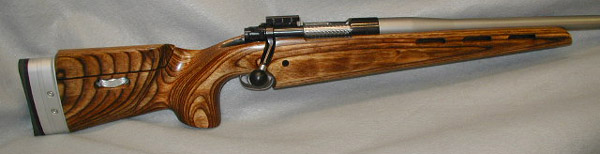

All that hardware is available for wood, fiberglass, and laminate stocks. The NRA sling crowd has had them on their rifles for decades.
Examples:
What action is it inletted for?
Bighorn TL3. Fit any round bottom 700 clone, just file the clearance needed on the ejection port if desired, bolt handle, and bolt stop or John-Kyle will do it if you ask.
