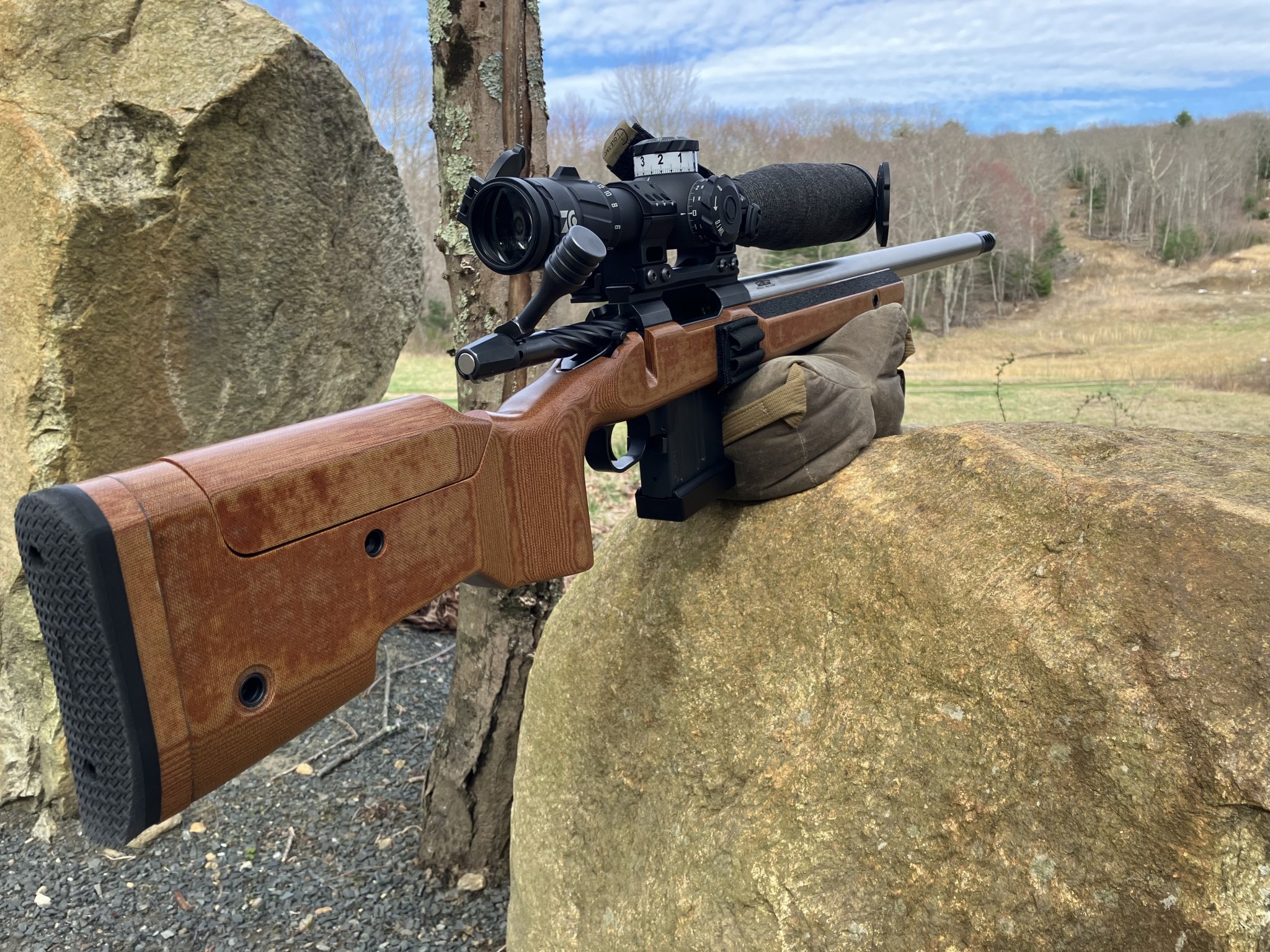

Makes the Centurion even better

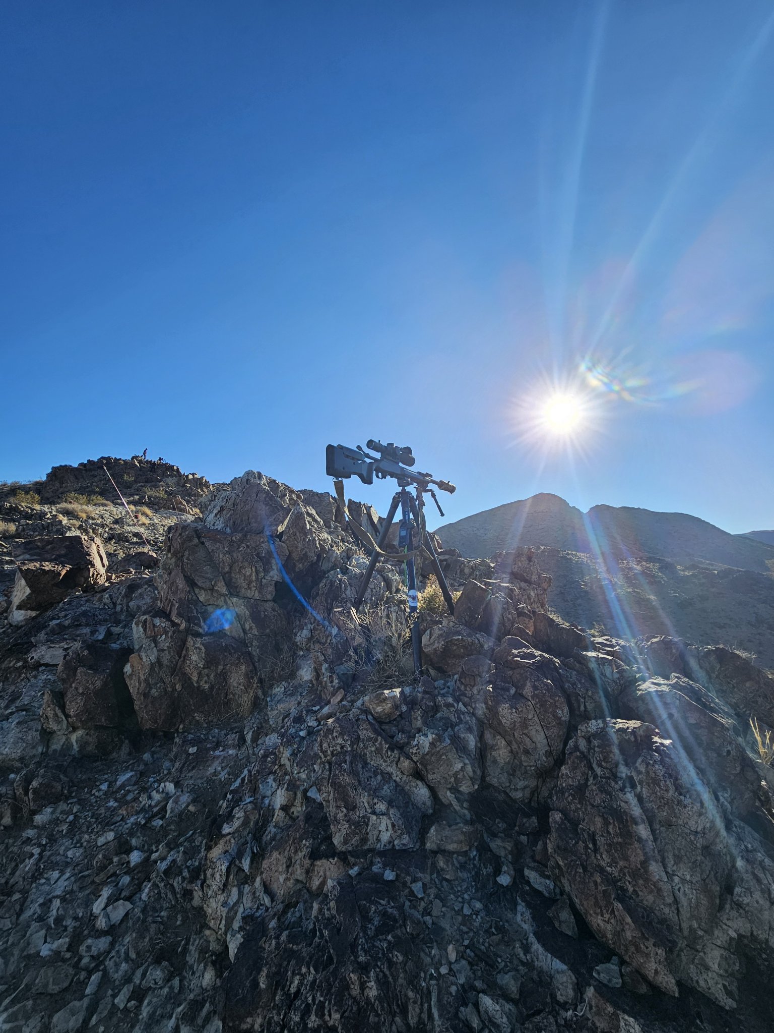

I love this picture... took this one at Max Ordinate Academy in December. Love my Foundations.

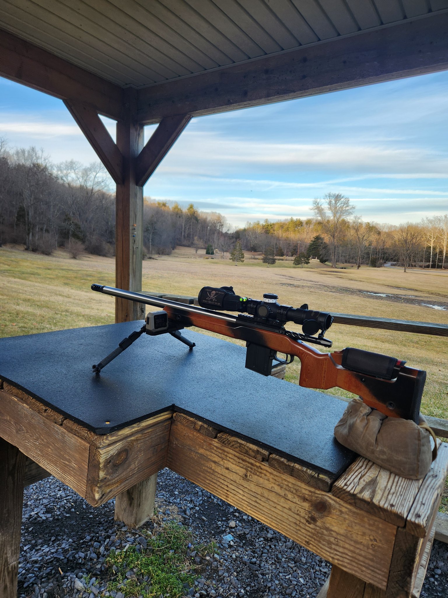

The Centurion balances great with MTU+ contour, VCC, or a 24-26" 1.250" strait. No weight kit required. It runs really well on a bag and deadens recoil to spot impacts/trace better than anything else I've used. Not sure why there's so much debate in this thread. You've either experienced it or you haven't...... No, it isn't as adjustable as a modern chassis........ that's the point and the allure. It's everything you need and nothing you don't. If multiple people aren't shooting your rifles and it's just being setup for you, then let's be honest you don't need all that adjustment, or for it to be toolless........... set your rifle up for a comfortable length of pull that allows for you to get a complete sight picture standing on a bag with the optic on max magnification. That'll work for all other positions and magnifications. Once the rifle is setup......... LEAVE IT ALONE.
FYI The min LOP with all spacers removed fastened with short screws on a standard centurion as it comes is 13.25" to a TT diamond with flat shoe.

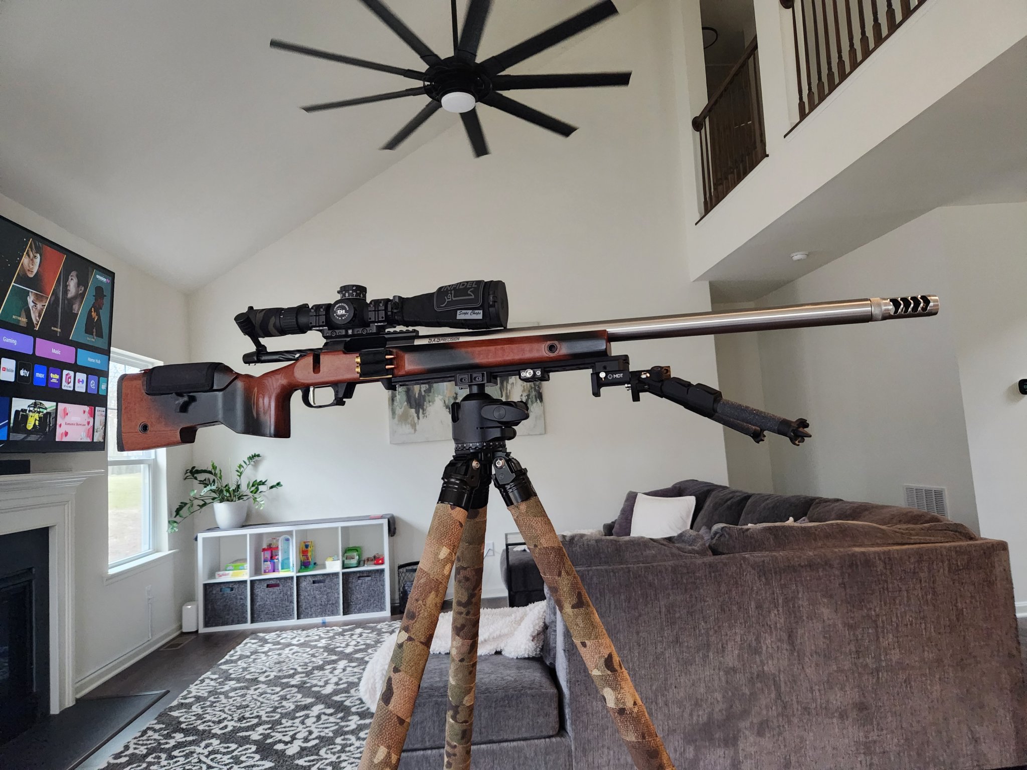

I was pleasantly surprised to get an email from Amy last week, my newest stock was getting shipped. It showed up yesterday so got her all dressed and weighted last night. I took a barreled action out of another centurion and dropped into this today, zero was spot on.
Another exceptional stock!

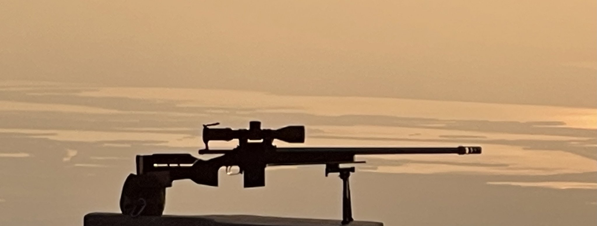

samson dark distressed inletted for CDG
