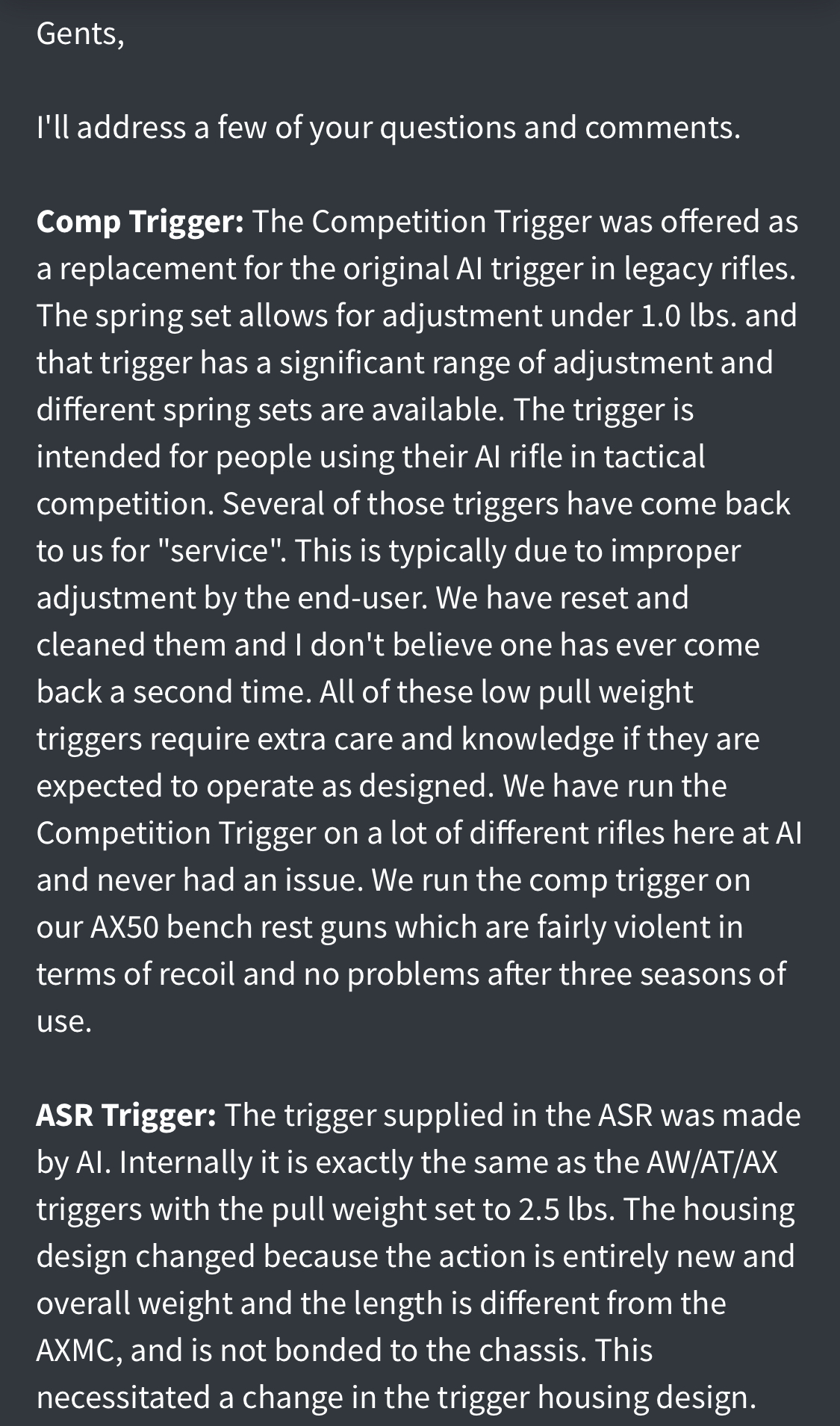

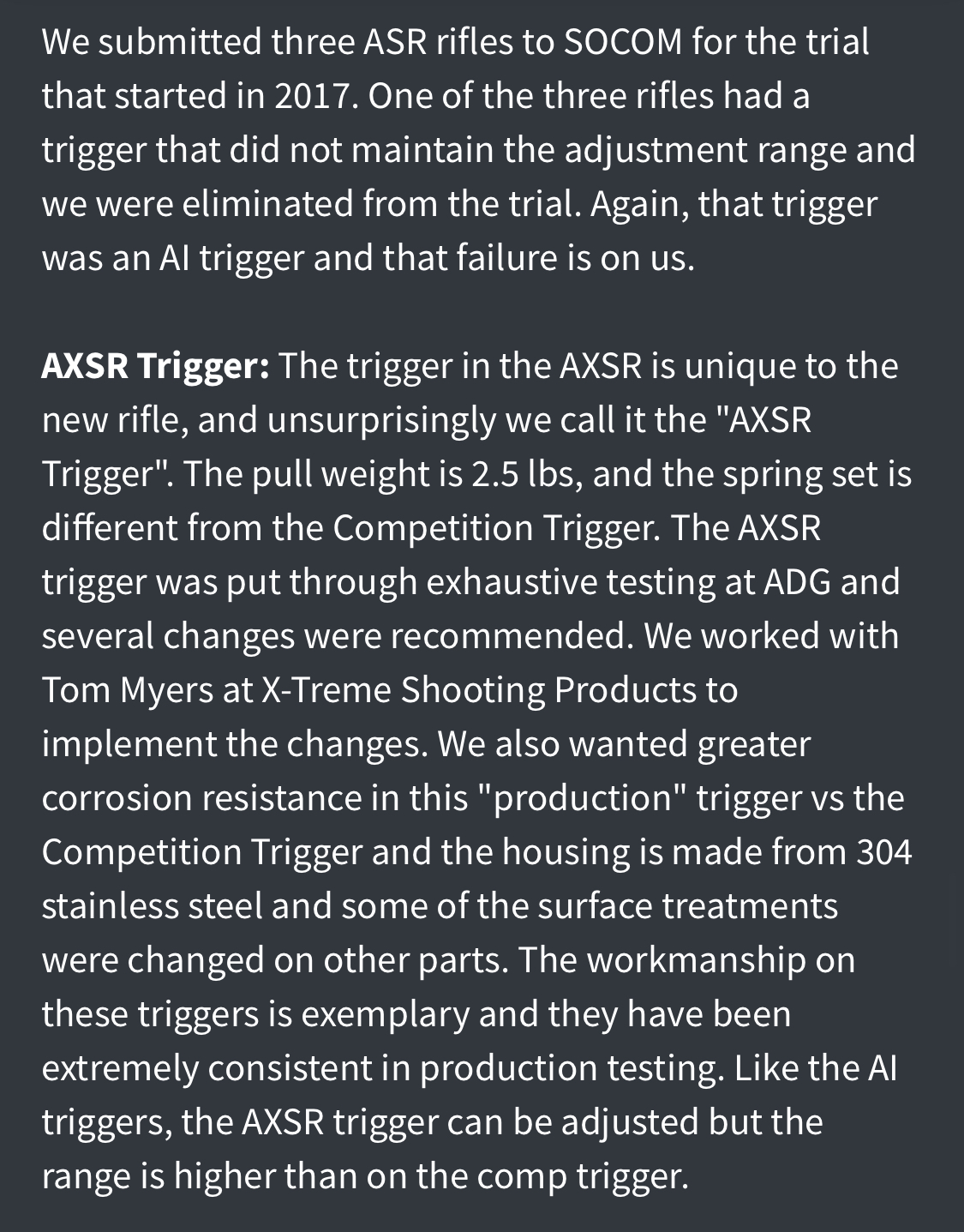

Pretty sure the comp triggers made the ASR fail the mil tests. So yeah hard no on that one
It was. I still have a comp trigger in my rifle, tuned as a lighter true 2 stage to keep bad juju from happening, but i always have the factory trigger in my fix it sticks bag, just in case. I have tried to make the comp trigger fail in this configuration tons of times and have yet to do it, but i know quite a few have in the past. Maybe not all, but most of the failures are those who made their triggers single stages.

From the man himself:

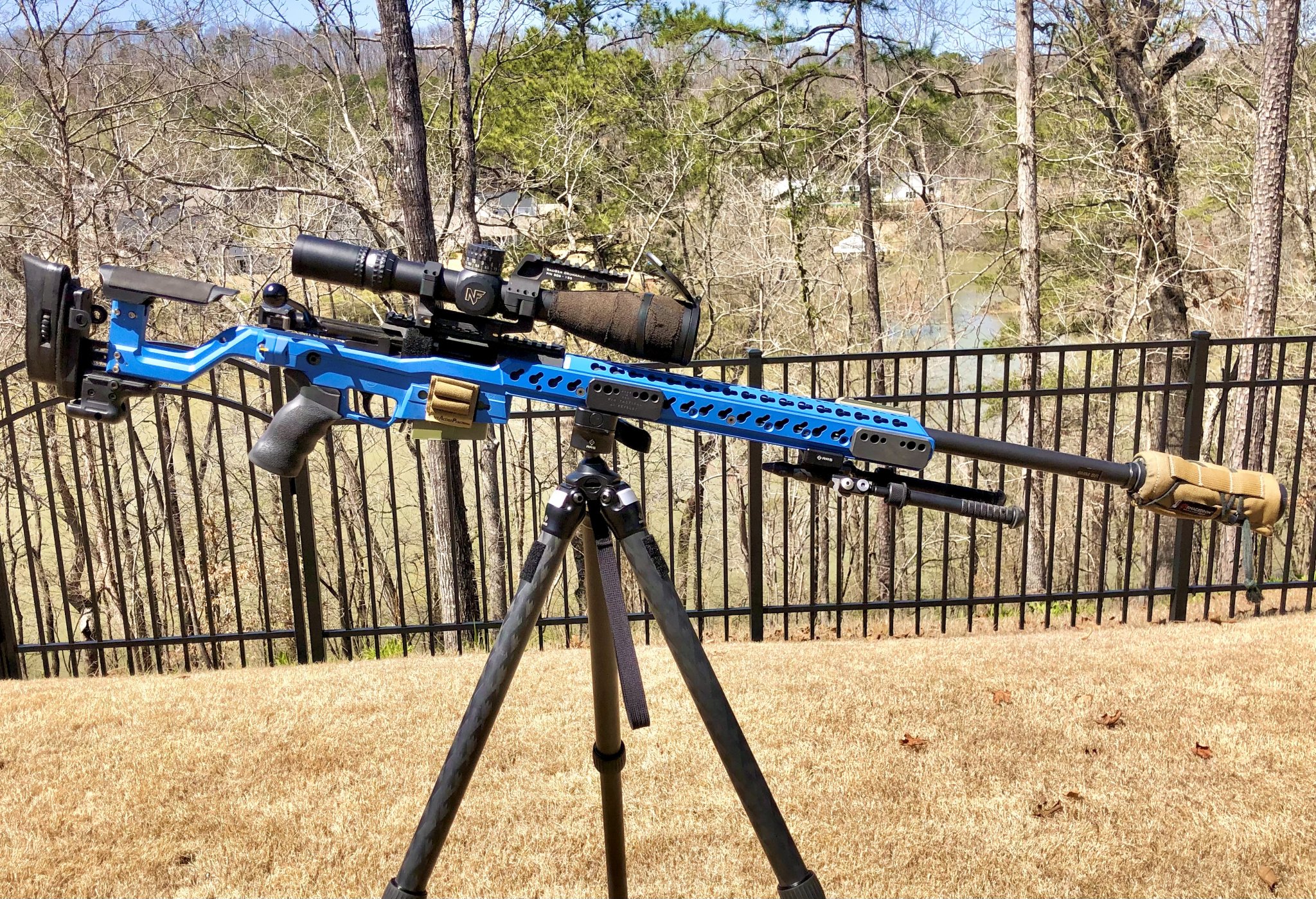

I built my dads old sako L579 into a complete prs/precision rifle and it blows almost every built 700 away in feel of bolt better than modern tikka, and couple other actions (popular ones) unnamed by long margin
Also don't think im comparing mine to ai cause in no way is it close to ai. Lol

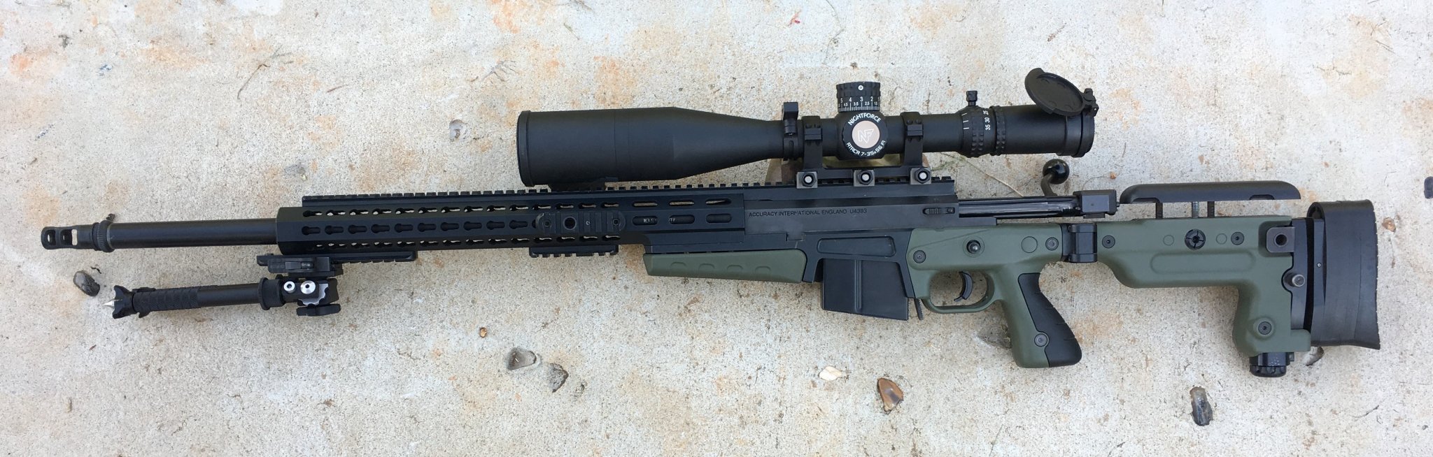

And now a confession. I have several Rem 700 rifles and some people talk inferior about these rifles but I like them a lot. Very good accuracy in several calibers.
The attachment is a Rem 700 VSSF with AICS stock in 308 caliber .
So people this is my statement . I own AW and REM rifles but the AW.....
It's the last rifle I would sell .

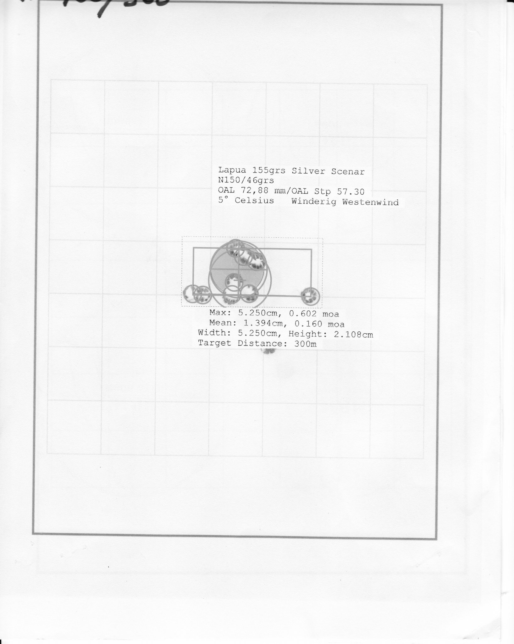

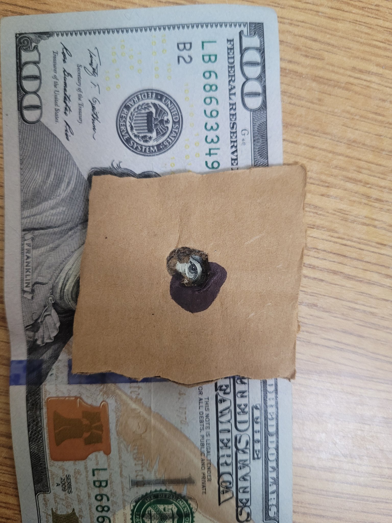

I want to add something to this post. On my previous post.
What I see on the most of the reply's is and I don't want to step on toes is the very magnificent pictures of extremely good looking rifles and i am convinced
that all these rifles shoot remarkably accurate but I don't see target results .
Its like going to buy a new car BMW or Mercedes or... for staying in the same price category......in a showroom but do they drive/shoot all as good ?????
The bottom line is and its my only personal opinion. As sport shooter and I can prove it the target results are more than once the same between other rifles factory's. All depends on how much you want to spent on it and how fortuned your wallet is .

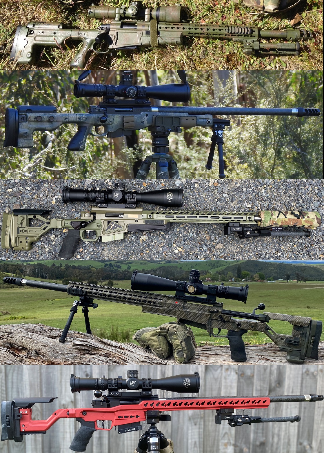

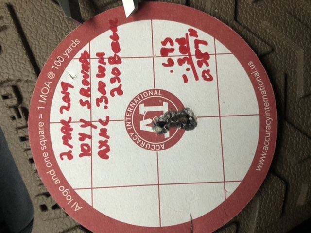

Plenty of targets and rifles to look at here...

Excluding a couple of other chassis (AICS 1.5 & AICS AXSR), these are the rifles I have owned. Currently using an AXSR, AT-X and AICS AXSR Vudoo.
The refined action, magazines, prefit barrels and company history are what got me initially.
Initially I had an AICS 1.5 chassis with the thumb hole stock was a classic... Didn't really like the thumb hole.
Next came an AICS AX fixed stock chassis pre-2014 (rounded plastic shell back end), that was excellent (top rifle), but was still a Remington, wasn't quite what I wanted.
Sold off a few things to fund an AI AT rifle that was absolutely outstanding, absolutely an excellent platform but wasn't the right shape for barricade use.
Swapped out the AT for an AX short action, big step up in terms of adaptability with the folding, paddle lever back end. Excellent rifle, same action and barrels as the AT... Didn't like the hand guard and ended up changing most of the rifle, in the direction of the AT-X (AR grip conversion, Arca front end, arca hand guard etc....) Fantastic rifle. Numerous podium finishes in the Australian PRS series ending up 4th nationally pre-Rona and taking a match in New Zealand. Out of the box it's great, with a few tweaks like the competition trigger, they really step forward.
Always wanted a magnum action AI, waited two years for the AXSR to arrive. 300WinMag, 300PRC, 6.5mm Creed, 338LM, waiting on a 308 16.5" carbon barrel. This thing is my favourite rifle, it's the first to come out of the safe. My primary hunting rifle now. The 300PRC with 210gr VLD Hunting projectiles SMASH everything in the mountains.
Shooting for Team AI Australia, we were very fortunate to pick up the first batch of AT-X rifles here recently. Got some weights not long ago, tuning that up. The in-built Arca rails, AR grip, cut outs etc. are all a big step forwards for PRS style shooting. It's an AT in a different chassis more suited to comps as everyone knows. Overall, outstanding.
AICS AXSR, sold a few things to fund this and the V360 V22 Vudoo action as a 'trainer' rifle. It's the most refined AICS to date, just really well built, you can feel the quality in the hinge and components. It's the kind of thing you plan on keeping for decades.
The appealing thing about AI is that things are refined, clean, simple, rugged and just simply work.
