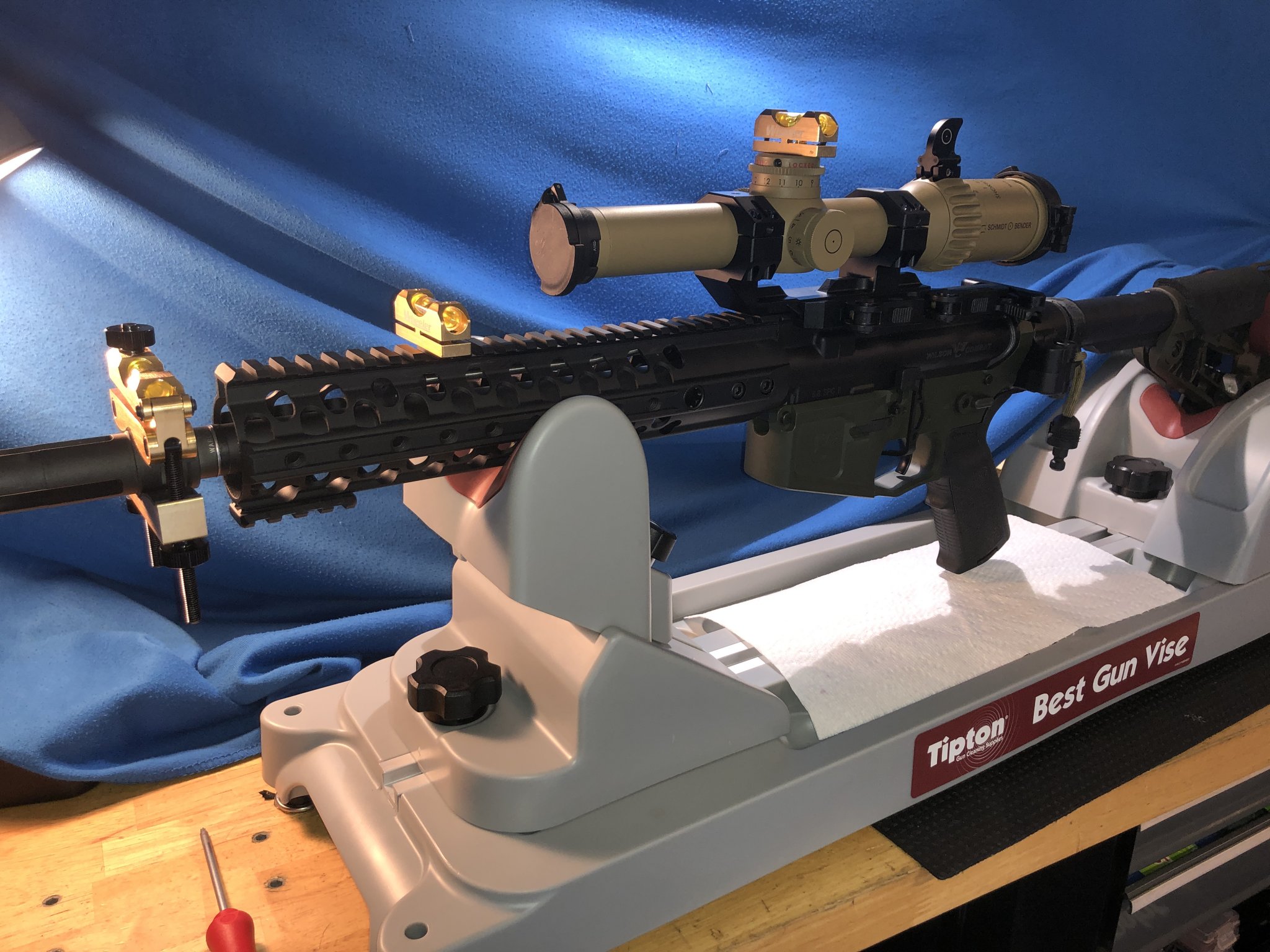

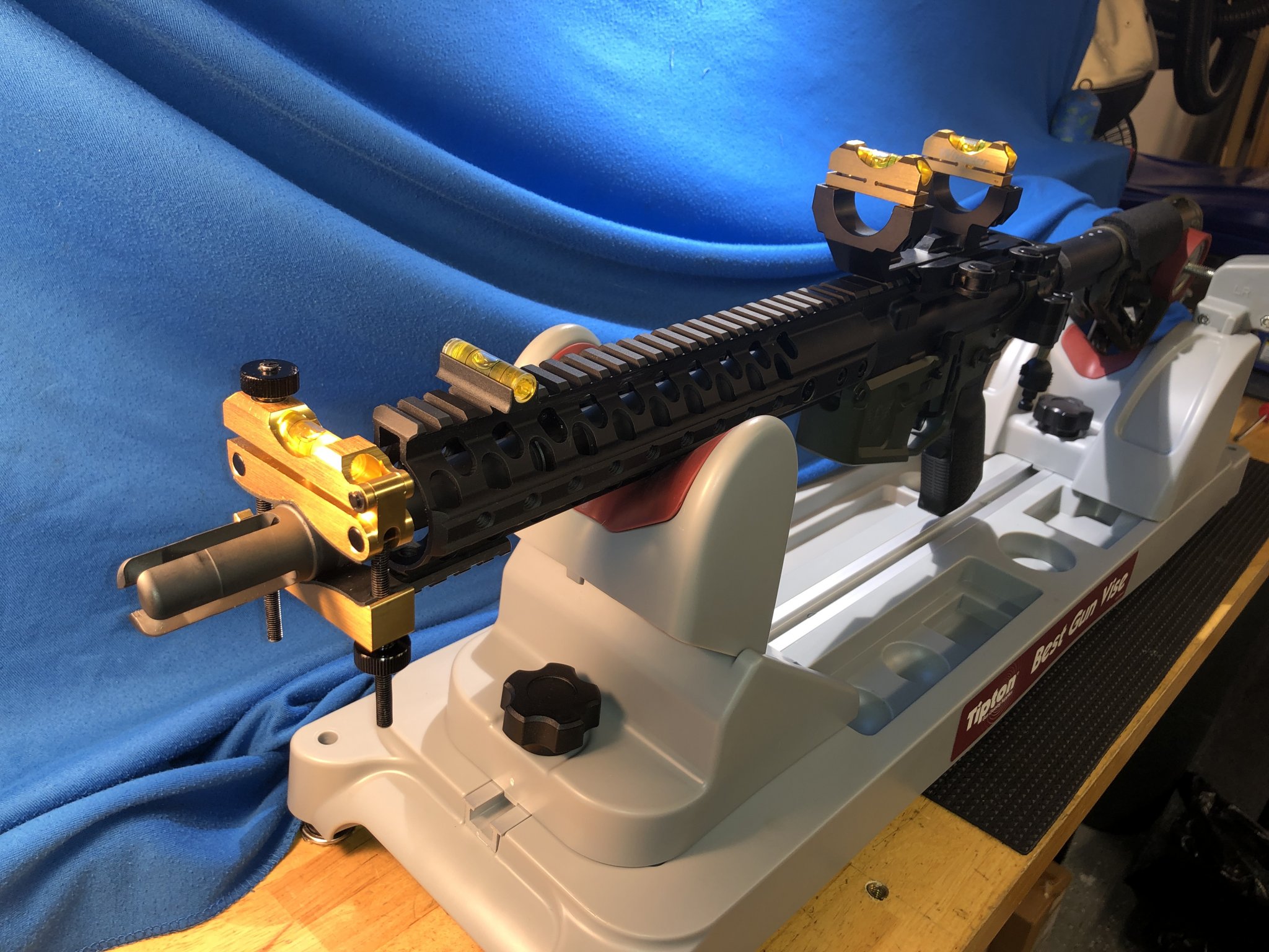

As to leveling. Yes, I do get that the errors down range from small leveling errors may well be inconsequential. I don't care, I level to the gun anyway. I was an aero engineer, USAF pilot, and later a program manager in very high tech. To me, things are either completely and utterly right or they are wrong. Yeah, I'm kind of binary that way.

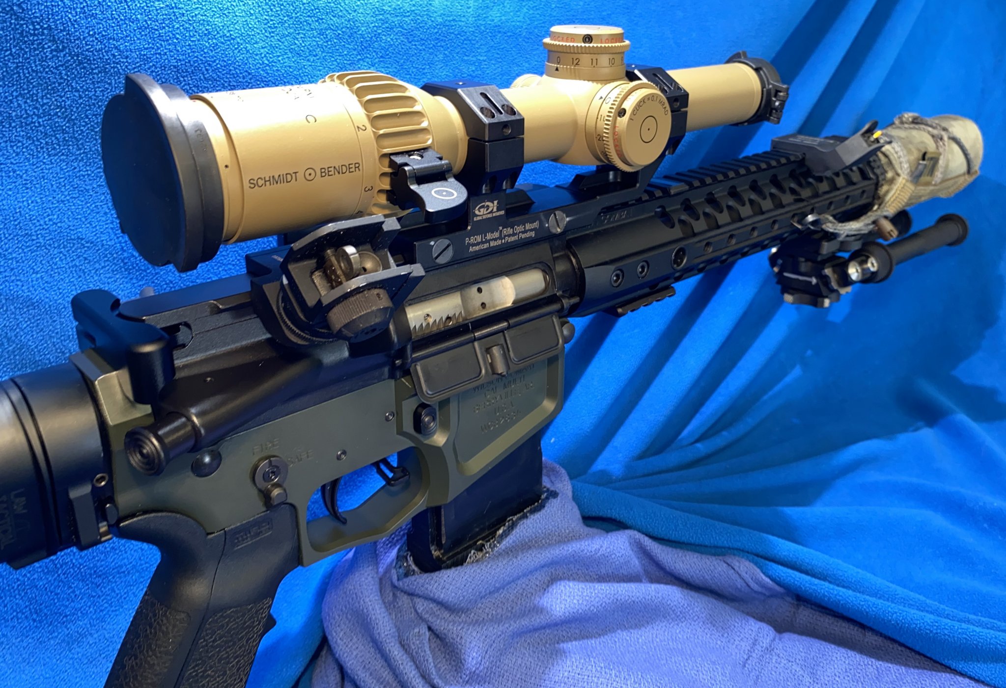

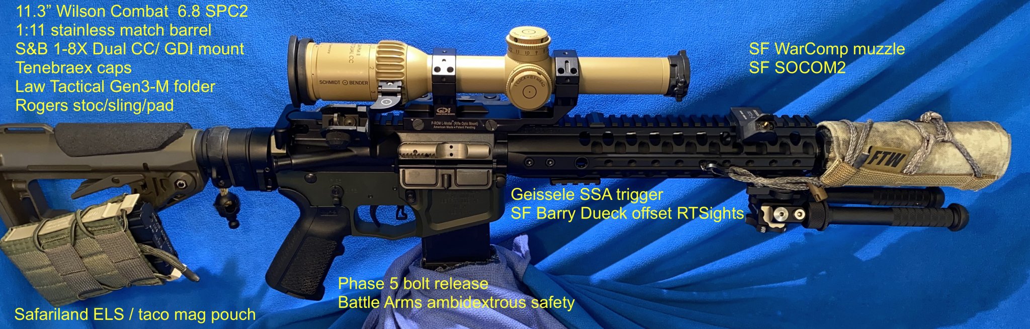

Why the high dollar QD but no irons ?I just installed a S&B 1-8x24 Dual CC scope into a precision GDI quick disconnect mount and experienced similar observations. It was hard to rotate the scope in the not-yet tightened rings without the whole gun moving. I triple bubble-leveled the rifle / scope during installation but when I was done, the gap between the upper / lower rings on the right / left side where not symmetrical.......drove me nuts, I am pretty sure it doesn't make a bit of difference however released the screws and incrementally tightened them so the gaps where equal when torque setting reached. I chalked it up to just really close tolerances of parts.View attachment 7074344View attachment 7074345
