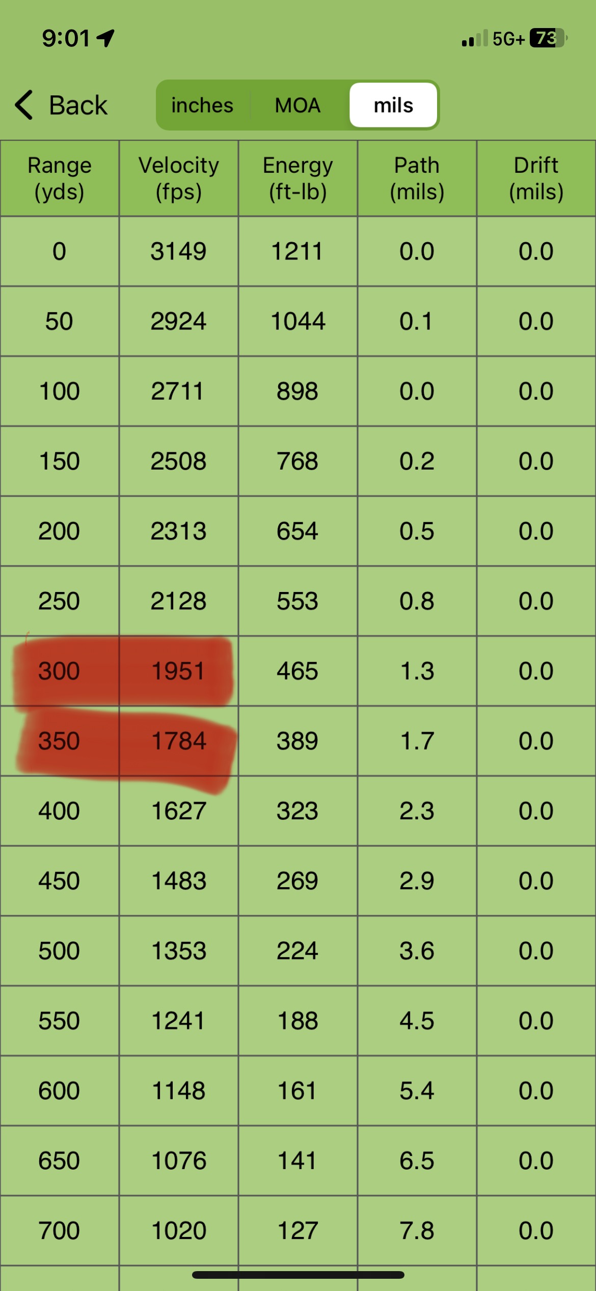

This example would need a significant velocity boost to be effective beyond 350yds. With the previously stated upset velocity.

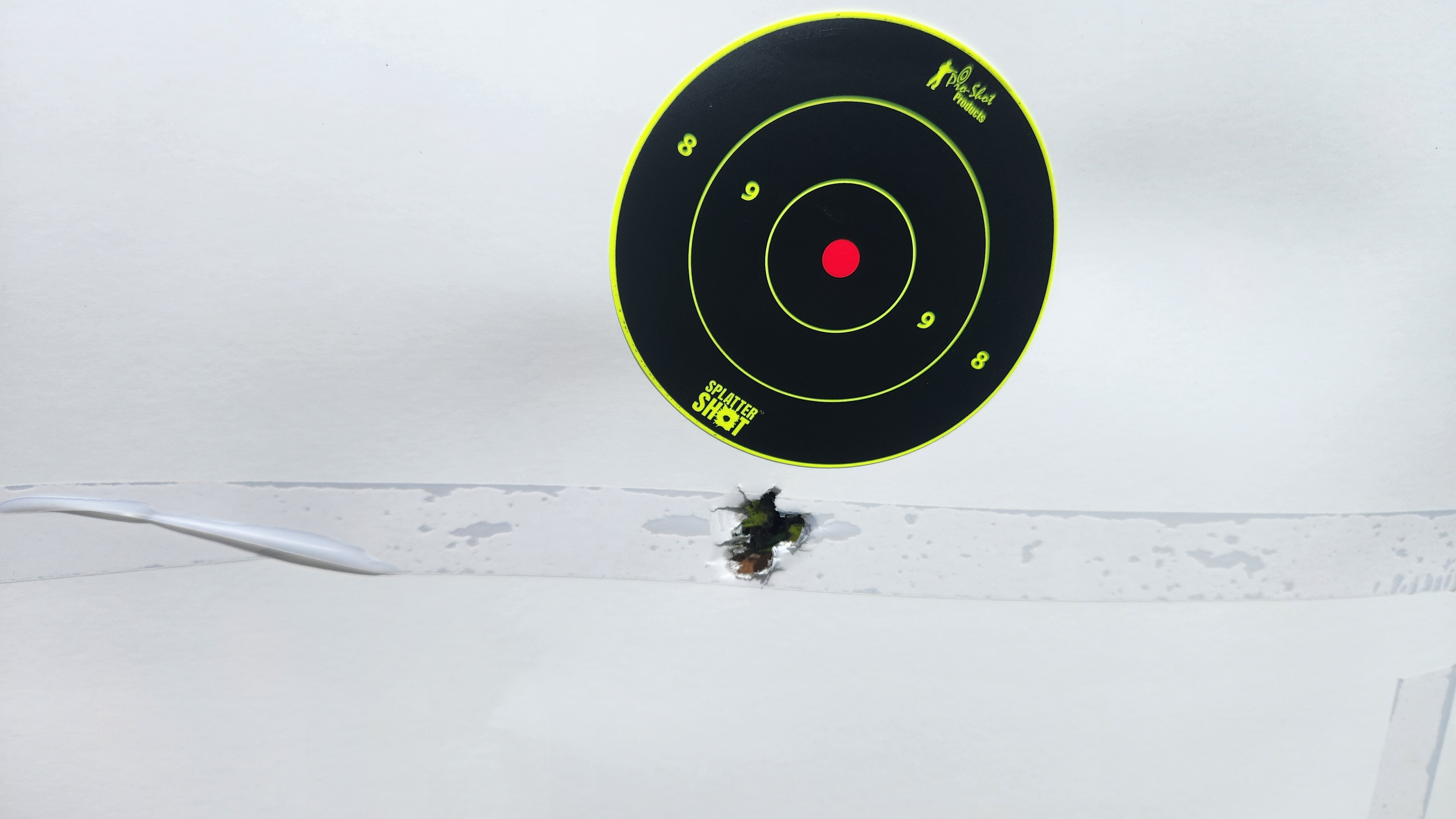

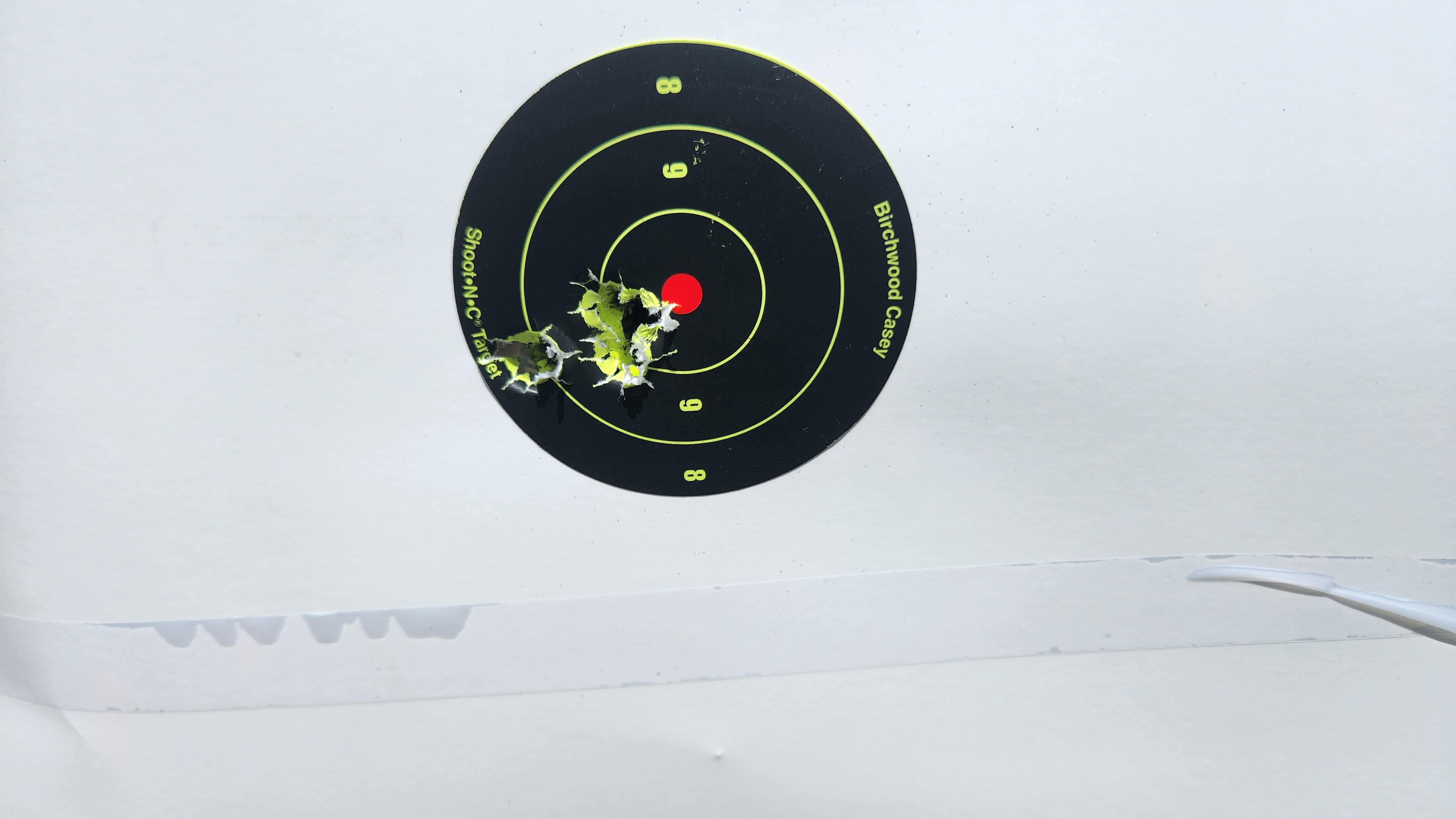

I am gonna put some of yall into apoplexy.
These two loads are from a 20" 308 win at 150 yards today.
#1- 178 ELD, Alpha SRP brass, cci 450 and Varget. Average 2816fps.
The left hand hole is the cold bore (literally) since there is a 22 degree difference from where the rifle/ammo is to the outside where I shoot.
#2- 178 ELD, Alpha srp brass, cci 450 and Power Pro 2000MR. Average 2749fps.
These pieces of brass have 12 firings on them. All over book max. Still running strong. Annealed after every firing.
Is the POI that diffrent between the two loads?
I would be interested to see the actual pressure on the varget load. 😳😳 Mine will ejector mark lapau at 43g with the 178 a max at about 2700 in a 23".
I hardly mess with my 308. I need to rebarrel it to a good caliber. It's just not worth 44g of powder to lob potatoes. 🤣🤣🤣
Yes the two powder have different POI mostly due to the speed difference
