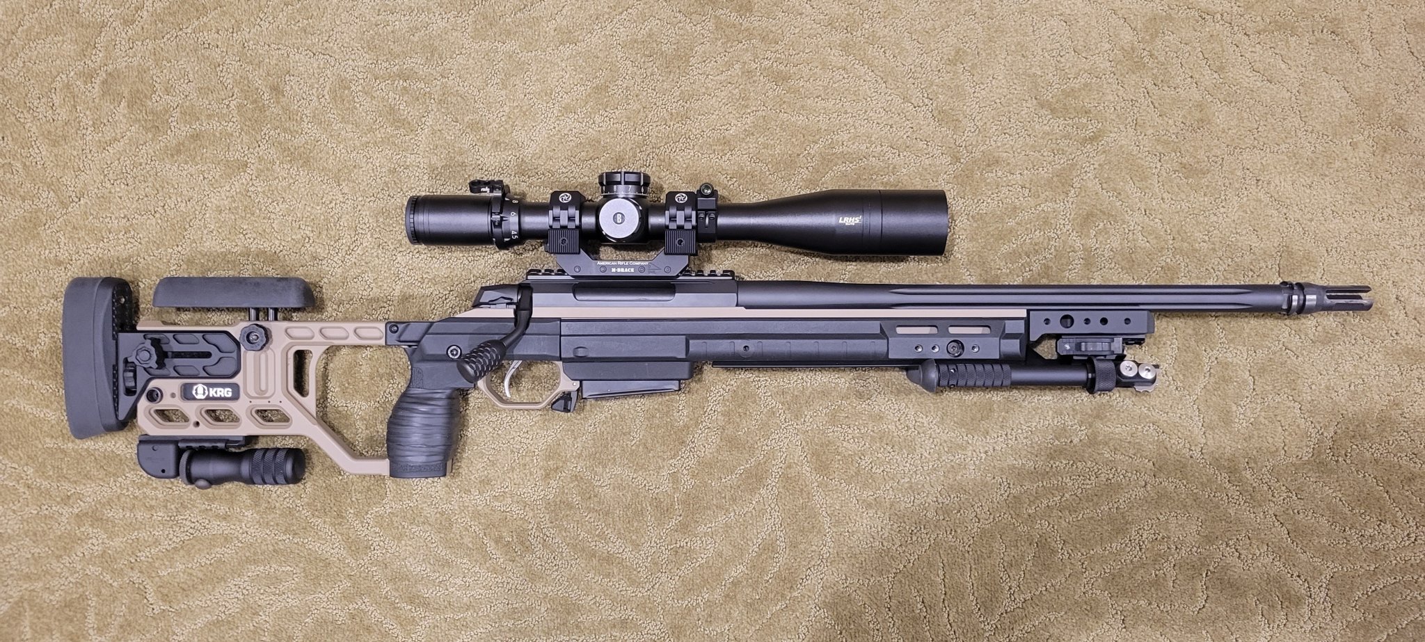

You're correct, balance point shifts with the W3. I had the XRay. The W3 felt better in that regard. Adding a monopod to the Xray will also help .
I've had both. At one time had identical barreled actions setup in each. The w3 felt better and seemed to hold steadier when shooting prs. I've since sold the w3 though to try other stocks/chassis and still have the xray with a w3 forrend and really like it.
