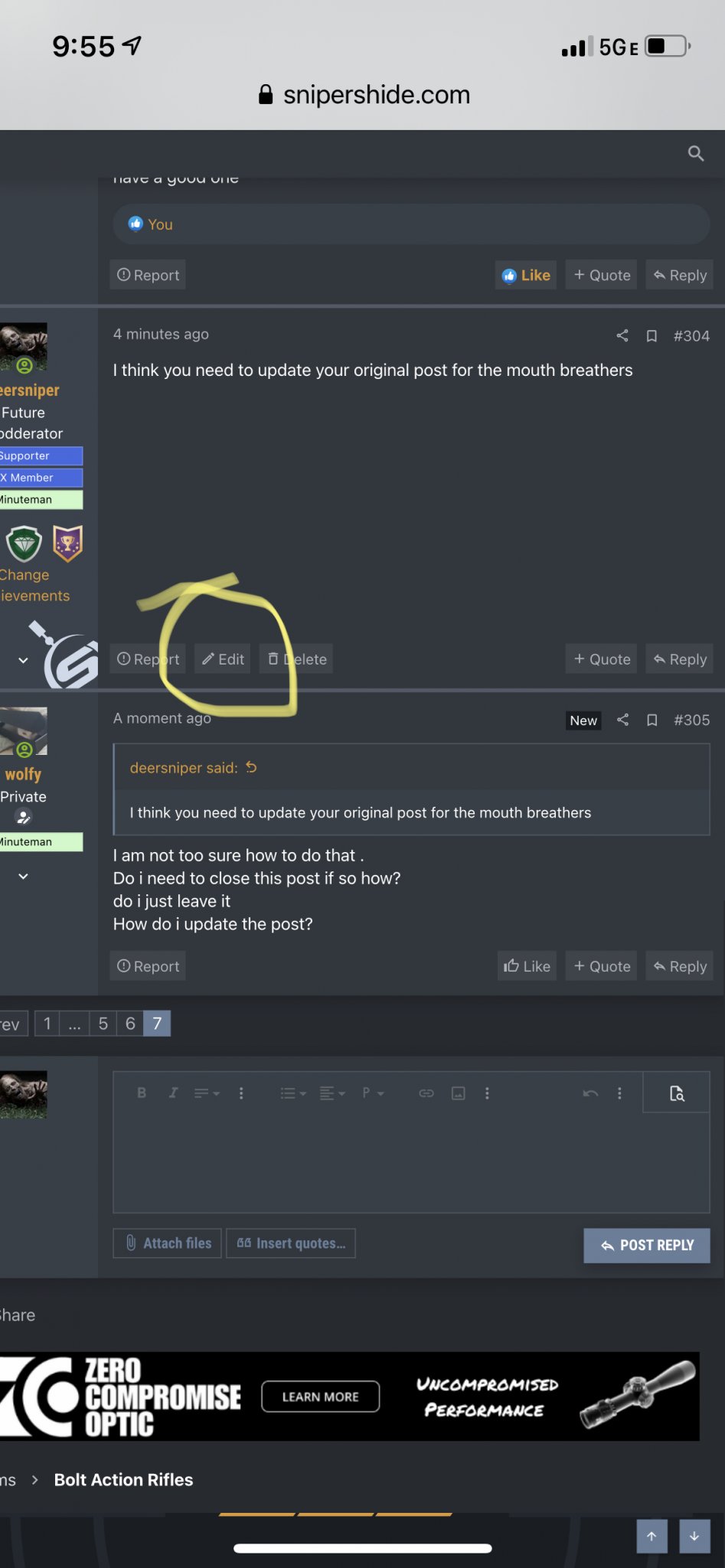

You could just hit the edit button if your first post. Or maybe not lol let’s see how many more people post that it’s the shooters fault lol
