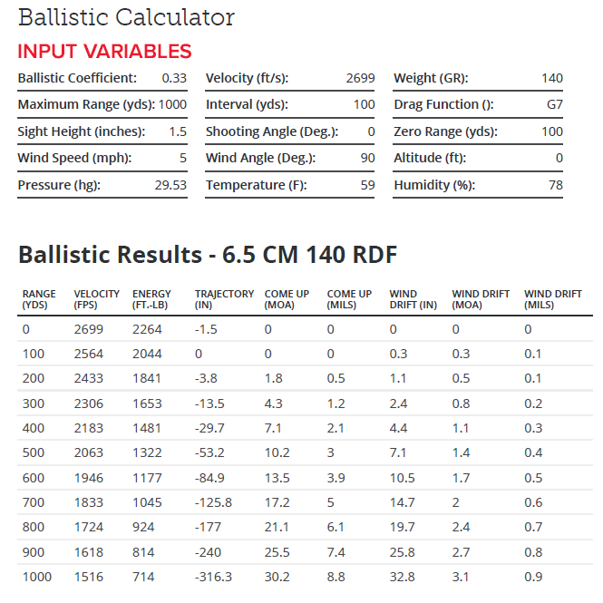

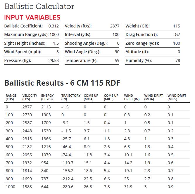

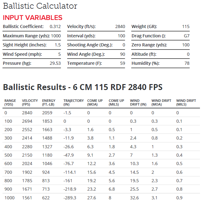

Noob question here. This has been baffling me for a while. A 6 CM with 115 RDF can outperform a 6.5 CM with 140 RDF in it's trajectory and barley beat it out on wind drift. The only options for ammunition that I can find for a 6 CM are Prime and Nosler, and the only bullets I can find are DTAC, Nosler, and Berger.
  • Why aren't there more ammunition and bullet options there that feature 115 grain bullets?
  • Are there more options for 115 grain 6 CM ammunition that I can't find?
  • Is there something I am not considering in my calculations?
  • Am I overthinking this?
The calculations below were done using Hornady's ballistic calculator, and the velocity values were obtained using Nosler load data using H4350.
Anything above the 105/108 gr bullet class just about requires a faster twist than 1-8, and I'm not sure how many rifle manufacturers are making a 6mm with anything faster than a 1-8? Many people wanting to shoot the new heavier bullets are using custom rifles, and often with 1-7.5 twist.
The ammo companies want to market to the masses, or maximize their profit margins based on larger sales, instead of a nich market.
Like anything there is a 'Law of Diminishing Returns'. Faster and heavier isn't always the best answer. Most of the competition shooters using 6mm's, I've seen or read about, prefer the 105 to 108 grain pills for long range.

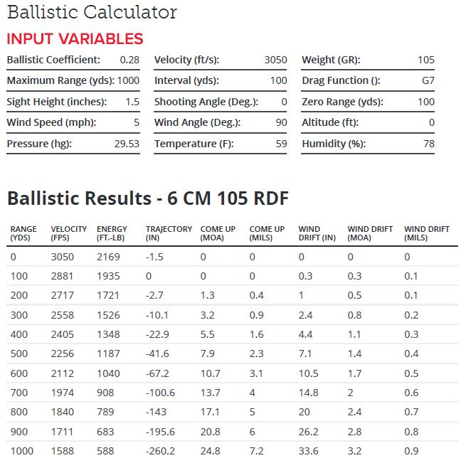

According to this if you go to a 105 RDF you get a 7% improvement in trajectory and a 5% increase in wind drift, so which is better 7% better trajectory or 5% better wind drift?
If I know the ranges I want less wind drift, if distances are unknown I’d lean towards trajectory.

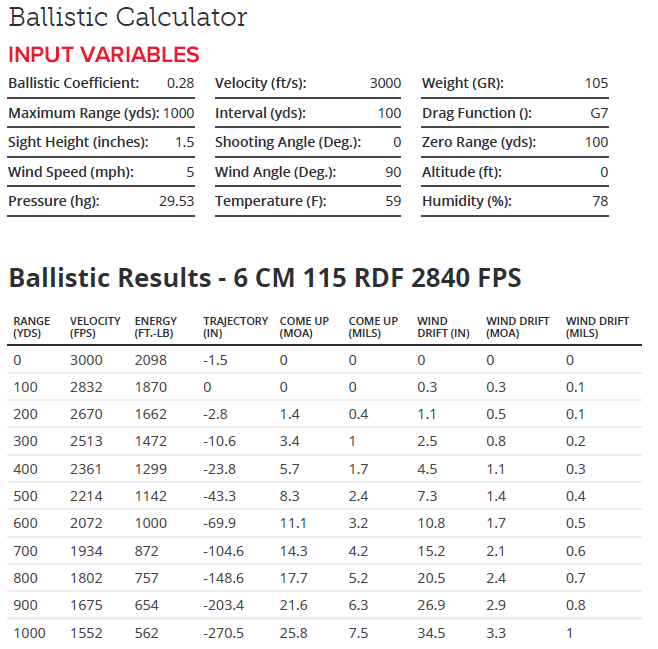

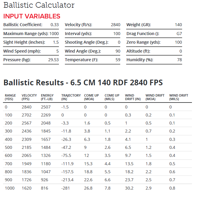

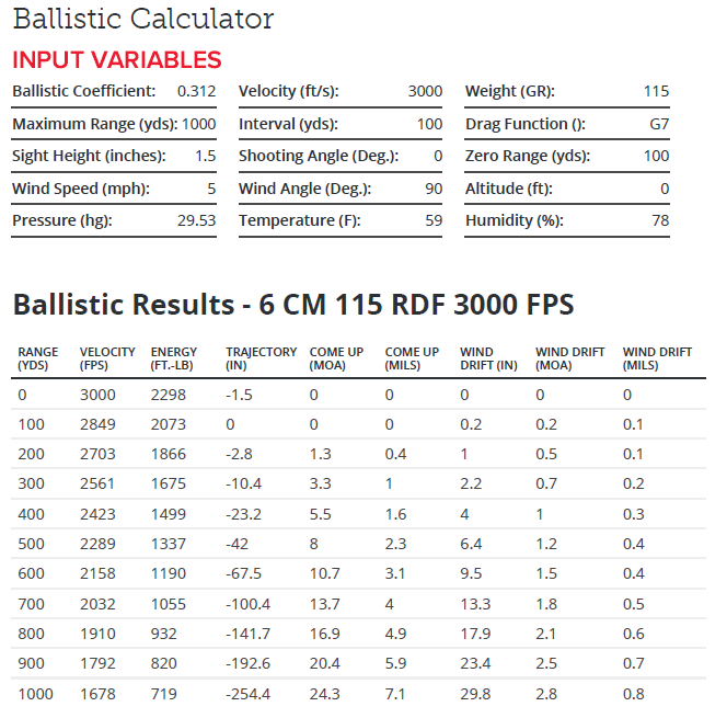

I think I've been overthinking this whole thing, at 1000 yards you only get a 2" advantage in wind drift (5 MPH crosswind) with 115 vs 105. I doubt my or many others shooting skills will be able to exploit this, which is probably why we haven't seen a huge following from the ammo manufactures.
Sorry I misunderstood, I thought you were talking about the 115 and the 105. If you compare 115 vs 140 at those speeds the 6 CM has a 9% improvement in trajectory and a 4% improvement in wind drift over the 6.5 CM, which is still so close I won't be able to shoot the difference.
