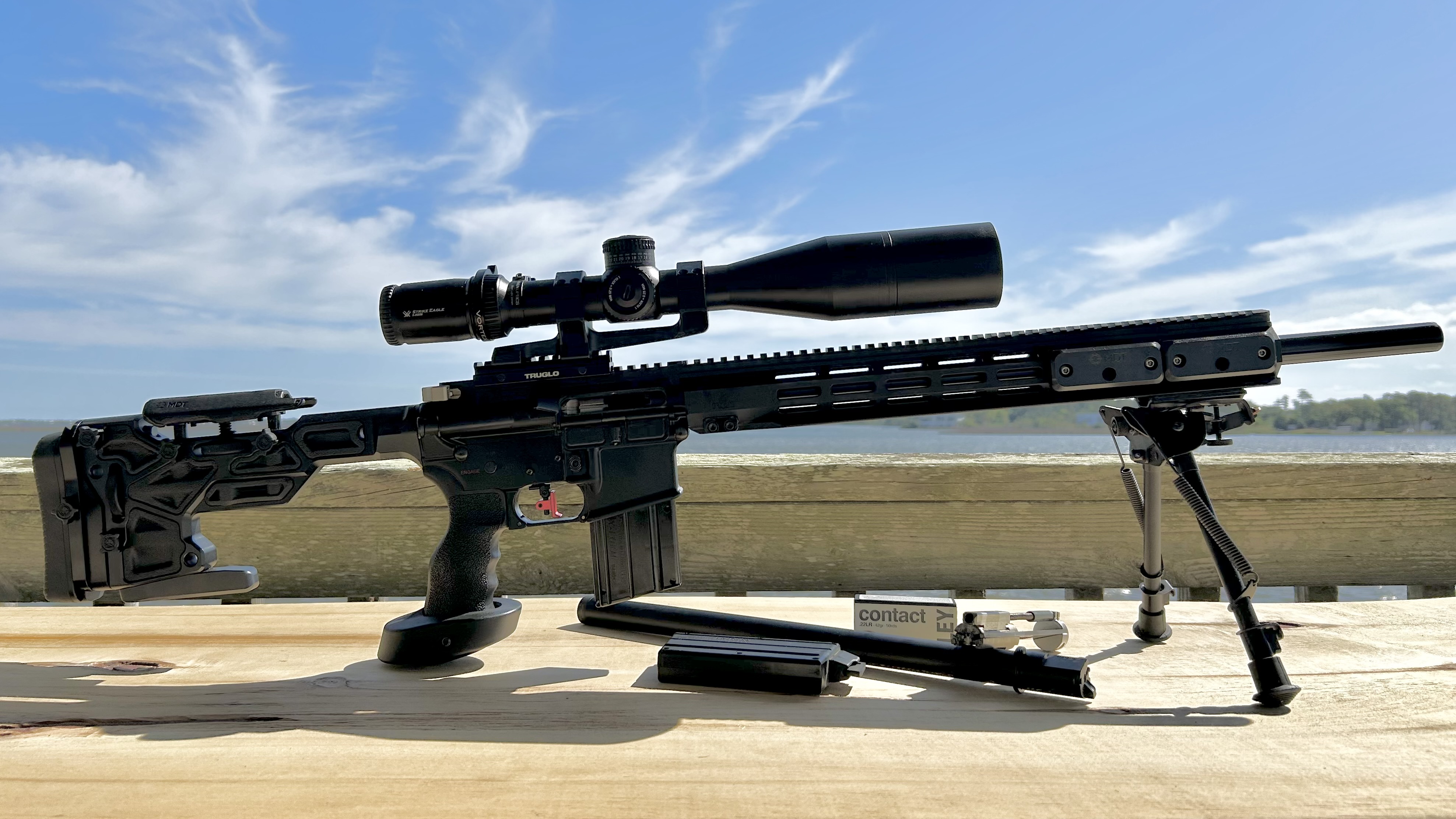

I’ve only fired my build in a couple of matches with zero failures, however just like the warning on custom 10/22 barrels, it won’t always manually extract an unfired round (just like some bolt actions.
This build wears a slightly modified Sako P94S Finnfire Range/Varmint barrel (23” 16.5T) and I had fired 2 of these barrels side by side to establish an accuracy baseline. I believe accuracy potential is fully there, and have proven to myself that the system is quite capable at distances out to my 400yard range limit.
