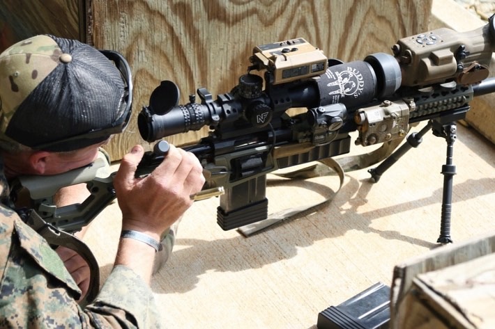

Question,
What's the tan cube on the bottom rifle?
... What's the tan cube on the bottom rifle? ...
HPR102
H=Heading (a.k.a. azimuth)
P=Pitch (a.k.a. inclination, displayed in cosine as well as degrees)
R=Roll (a.k.a. cant, displayed in degrees)

304102e3-8d5d-4f90-9b19-a50a6f7f817f-jpeg.7063770
Oh boy, can we play "name the cool sh^t !!??"
Let's see the RRS mount is actually below the MRO in this pic ... and in front of that a PEQ-15(LA-5) with the raised adjustment knobs ... and then above and in front of that is a DRS SPARTN ... don't see many of those around where I am :D ... .and then behind that a NF scope, though not sure which flavor, but will guess a 5-25x t3 ... and on top a RAPTAR looks like an ES model without the ballistics module.
And the rifle is covered up ... but the butt stock matches my AIAX rear end.
Oh and an Accuracy First "cant" indicator, probably with the tritium vial.
