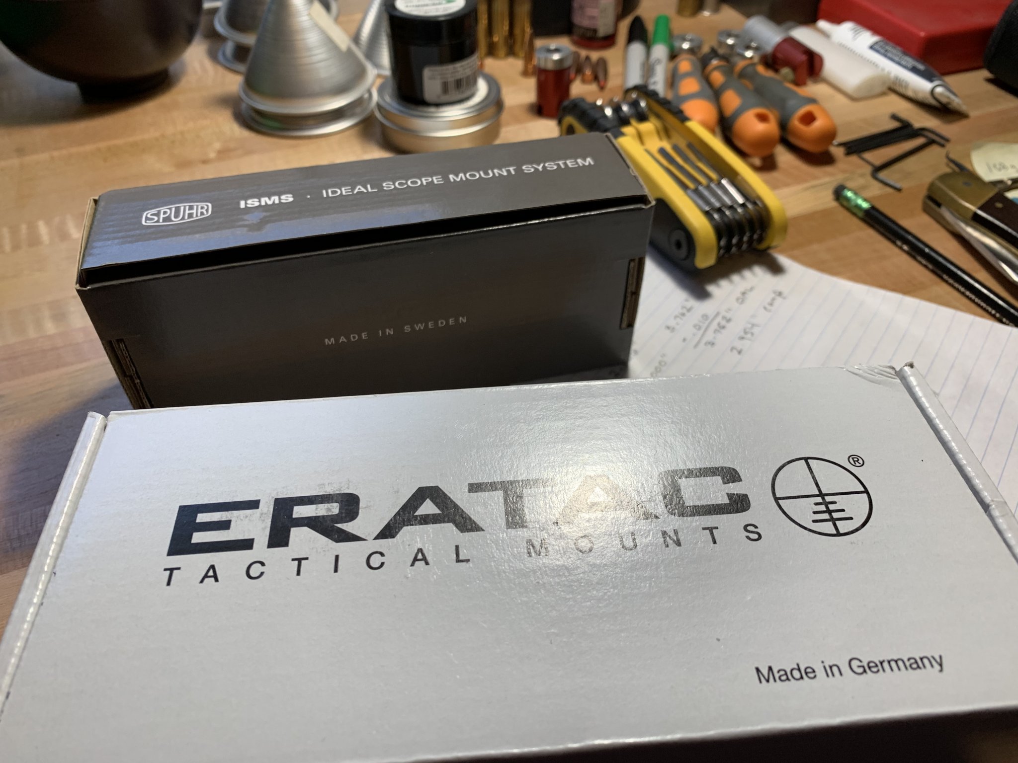

Spuhr, Sweden all day long. ERA-TAC, Deutschland!

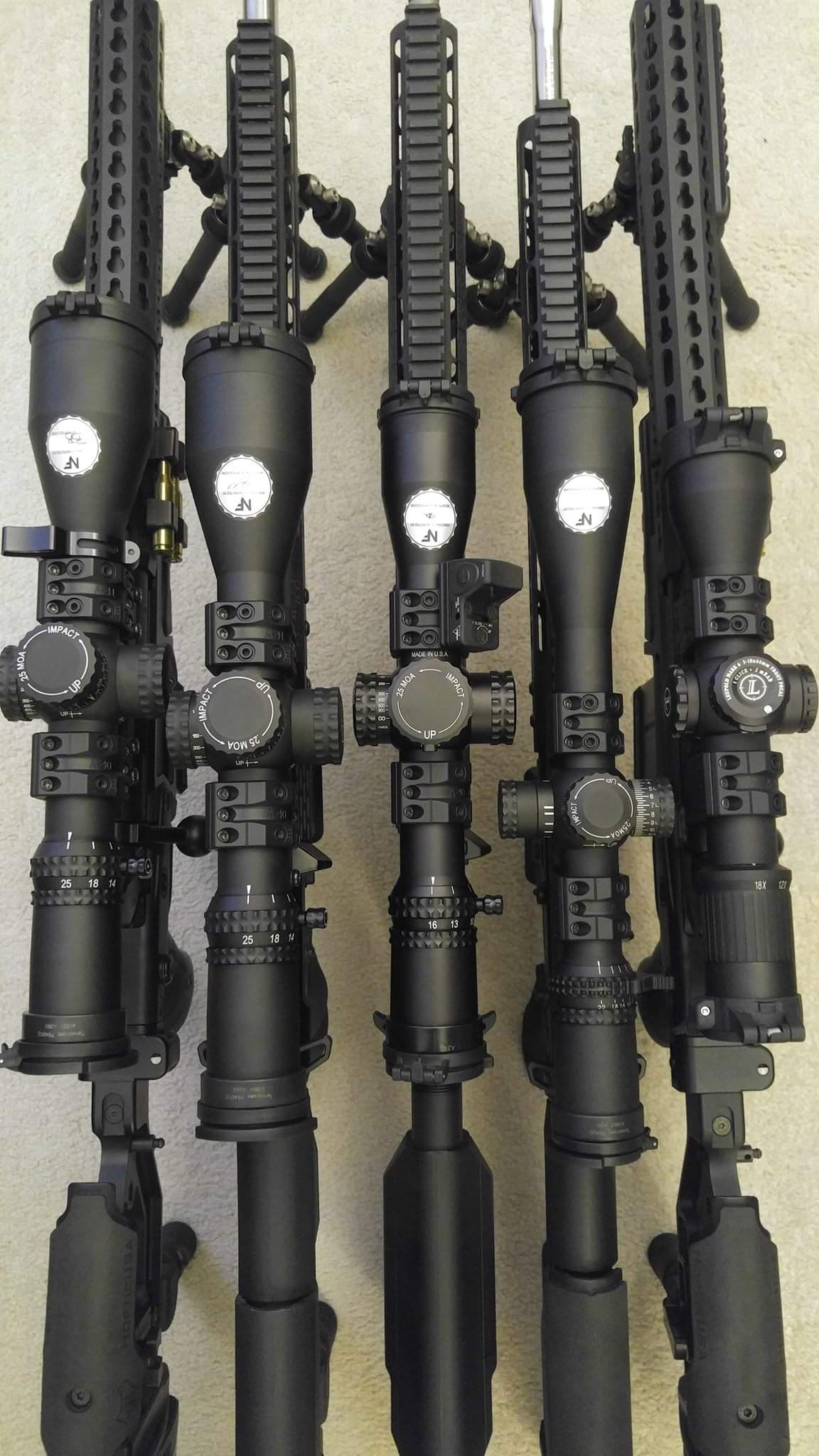

Pretty much all of the obvious benefits have been stated. For me, it’s the bomb proof over engineering and absolutely flawless machining.
I’ve had a few of the competing mounts and honestly it’s worth the few extra bucks for me to simply like the product more.
