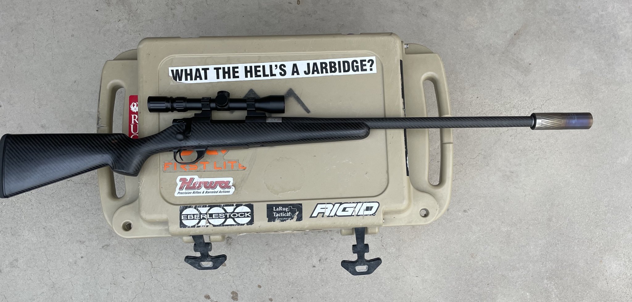

    I have looked around everywhere. I got this scope on my ultra lightweight 6.5 creed and leave it at 10x. I only have around 50-60 rounds down the pipe and like it.
