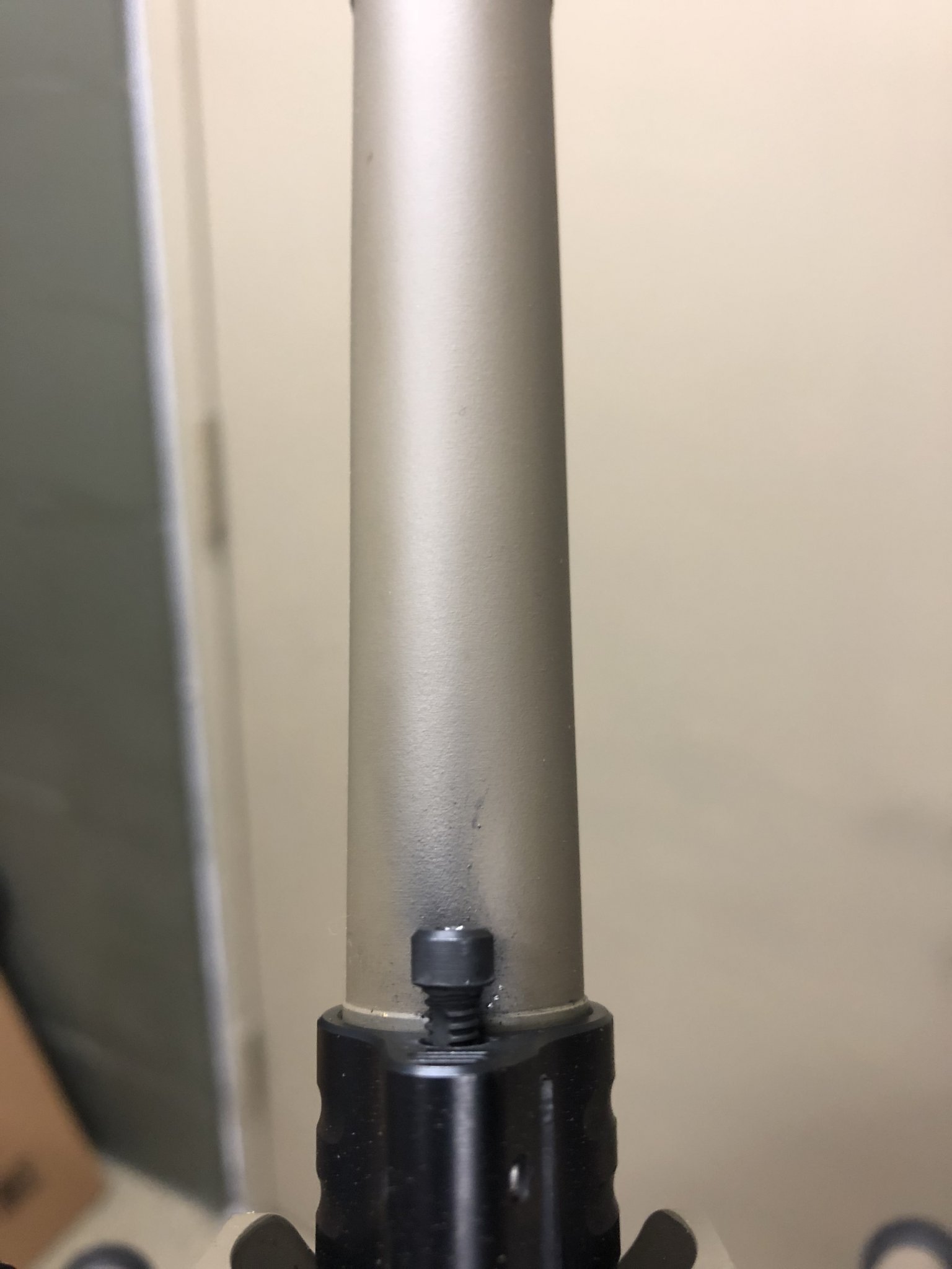

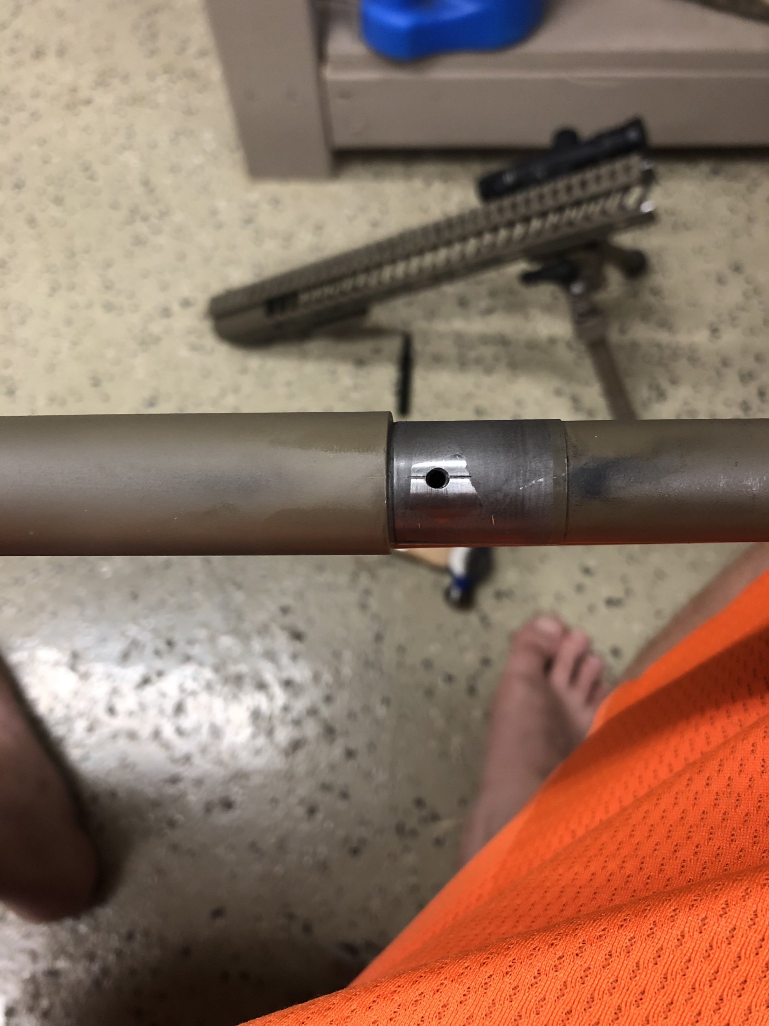

    I’ve been battling a gas issue with my 20” +2 Valkyrie barrel and I’m just questioning why there’s a consensus that this cartridge needs extended gas. Glancing at pressures it doesn’t seem all that different than 5.56/6.8/6.5 Grendel.
    I’ve got a 20” Wilson Combat barrel on the way with rifle gas to see if my current barrel is the problem. With an adjustable gas block and JP SCS, I cant see why the standard gas system would cause an issue.
    Obviously a bunch of guys here are running +2 gas on the Valkyrie, I’m just interested in why that was adopted as the go to right away.
    Troubleshooting is telling me I’m undergassed. Wide open on the SLR, I’m not reliably locking the bolt back. Factory ammo, book max reloads, doesn’t matter. I’ve swapped lowers, carbine vs rifle buffer tubes. Basically taking parts from working ARs to isolate the issue. Potentially my gas port is undersized or not centered. If the Wilson barrel runs reliably, this barrel is going back to the builder to get checked out.
    I was just looking at all of my various ARs with rifle length gas systems in 204, 5.56, 6.8, .308 and just had a random thought as to why the builder of my Valkyrie barrel insisted on the +2 gas.
    I know the 6 and 6.5 creedmoor gas guns do well with longer gas (I have 2). Comparing the Valkyrie to the Creedmoors doesn’t make the case that they need the same gas length.
    No gas is used to move the bolt unless the bullet is between the gas port and the muzzle. How much space is between your gas port and your muzzle? Prob not much with a 20” +2. So yes, if anything is not sized correctly or aligned perfecty you likely won’t have enough gas. Same with 18” ARs with rifle gas. They can work but even with max gas they are starting on the edge of reliability. Have you tried a non adjustable gas block?
    Reactions: Sniper266

    I would say more chance that the gas is restricted or being lost somewhere.
    A 20 should use a standard rifle length gas for sure and a 24" would run fine with a standard rifle gas. As it is a 24" needs a .098 gas port to cycle with a +2" system and that port is larger than optimum. A hole in the barrel almost half as wide as the bullet...

    If you have an adjustable gas block and are saying you have to open it all the way to get it to cycle reliably I'd say just open it all the way and call it good. If you are worried it is on the edge I would get a lighter buffer rather than messing with the BCG. A lighter BCG is much more expensive and can complicate things even more by removing the mass that is used to move the buffer. You could also try a lighter spring but lighter buffer is prob the easiest.

    I appreciate the discussion. I started this build last winter and just accepted the fact that all the big name builders were running + gas because this was some hotrod new cartridge that overwhelmed standard rifle gas. After running real world loads and struggling with gas issues, I started questioning the philosophy.

    I took a few pics of the gas block journal. I wonder if his scribe lines are causing gas to leak by. You can see some powder residue front and back of the gas block. I noticed it before but since this is my first all FDE barrel, I figured the color just showed it better.

    I wouldn’t think that would be near enough to make a difference. I would measure base to hole on the barrel and on the block to make sure they line up perfectly. He may have meant for you to seat the block even with the little shoulder you see in pic 1.
