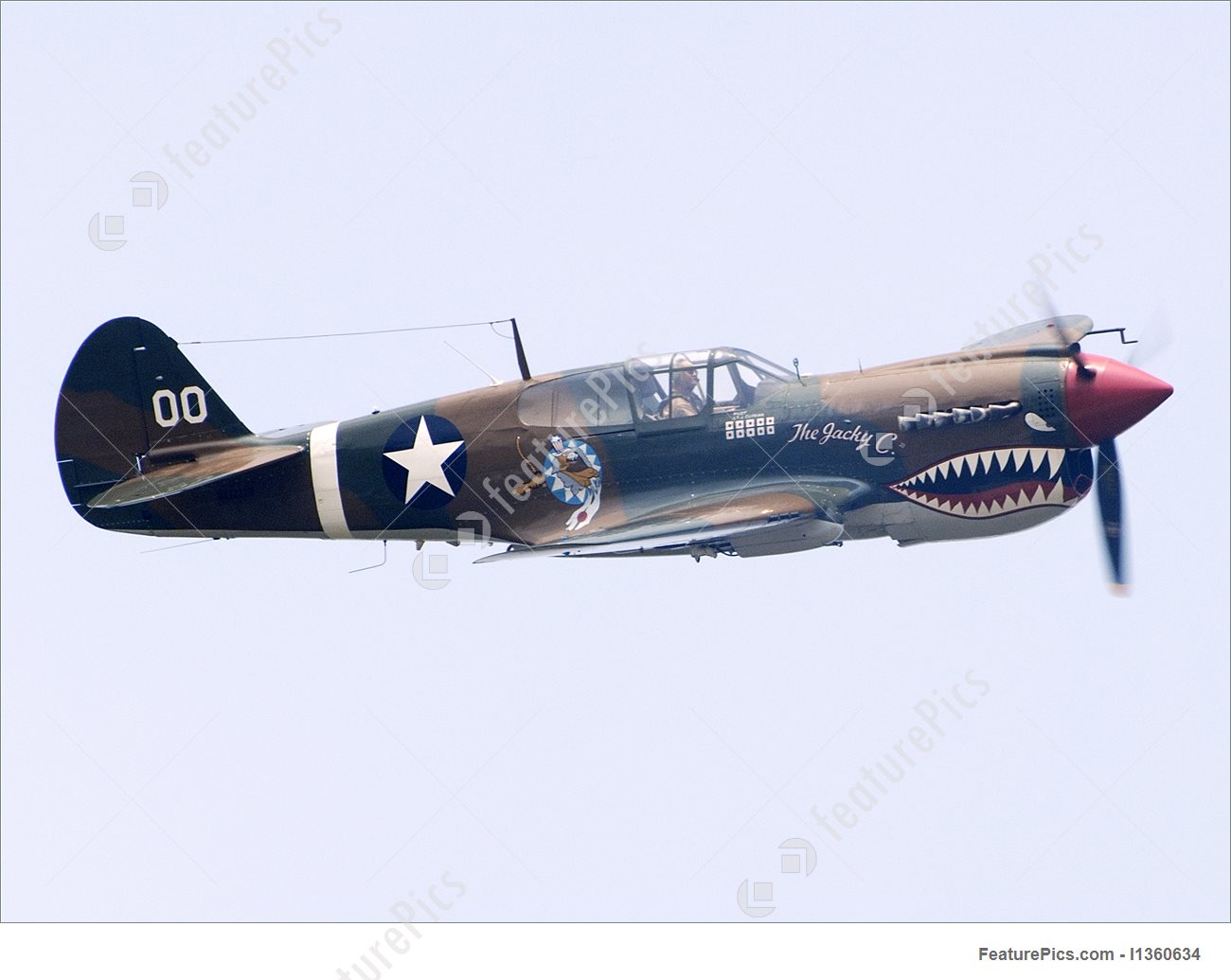

If we’re talking sexy WWII fighters...
Obviously performance wasn’t all there compared to the aircraft that are being discussed, but it looked good doing it.
The p-40, f4f wildcat, and hawker Hurricane and their pilots deserve admiration for holding the line against superior aircraft with tactics, cunning, and massive balls until engineering and manufacturing could turn the tide. Without them midway, Guadalcanal, North Africa, and the Battle of Britain might have been recorded differently.
