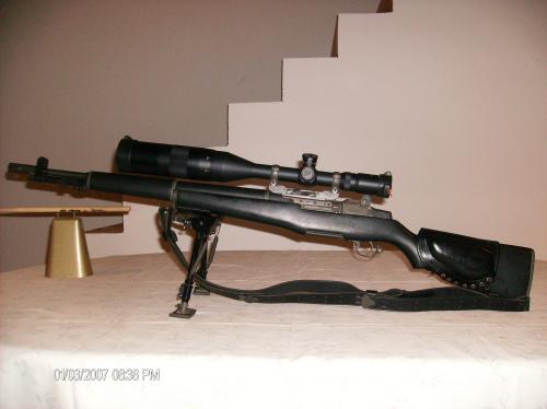

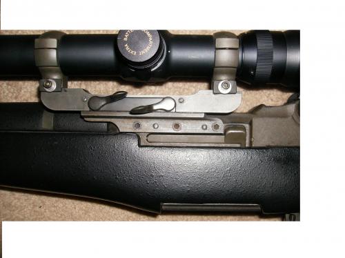

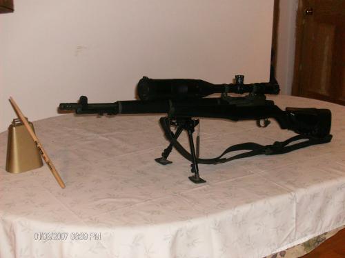

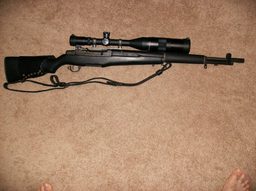

Here is what I have been working on for a while now. Started this several years back,with not much rounds throught the barrel yet.
My goal was to make my Garand as accurate as I could do so. The first shots out of it at 200 YDS have been AMAZING!
I feel special now that I own THE MOST,THE BEST garand on the PLANET!!! :p "This is MY rifle.There are NOT many like it,and THIS one is mine!!!"
Garand MC-1 serial # 1,xxx,xxx 30 06 NM barrel and OP rod Glas bedded,trigger job, NM 2 hooded sights,MANY,MANY other mods, ETC,ETC,ETC................ It shoots great and am soon to get back at it and see what ALL it can do,but being a Semi auto it is limited. (Bolt rifle Rem 700 project coming up soon in my future )
