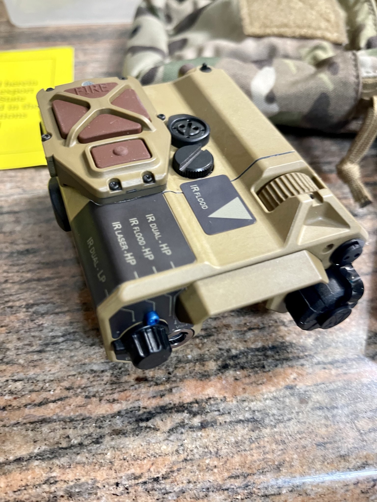

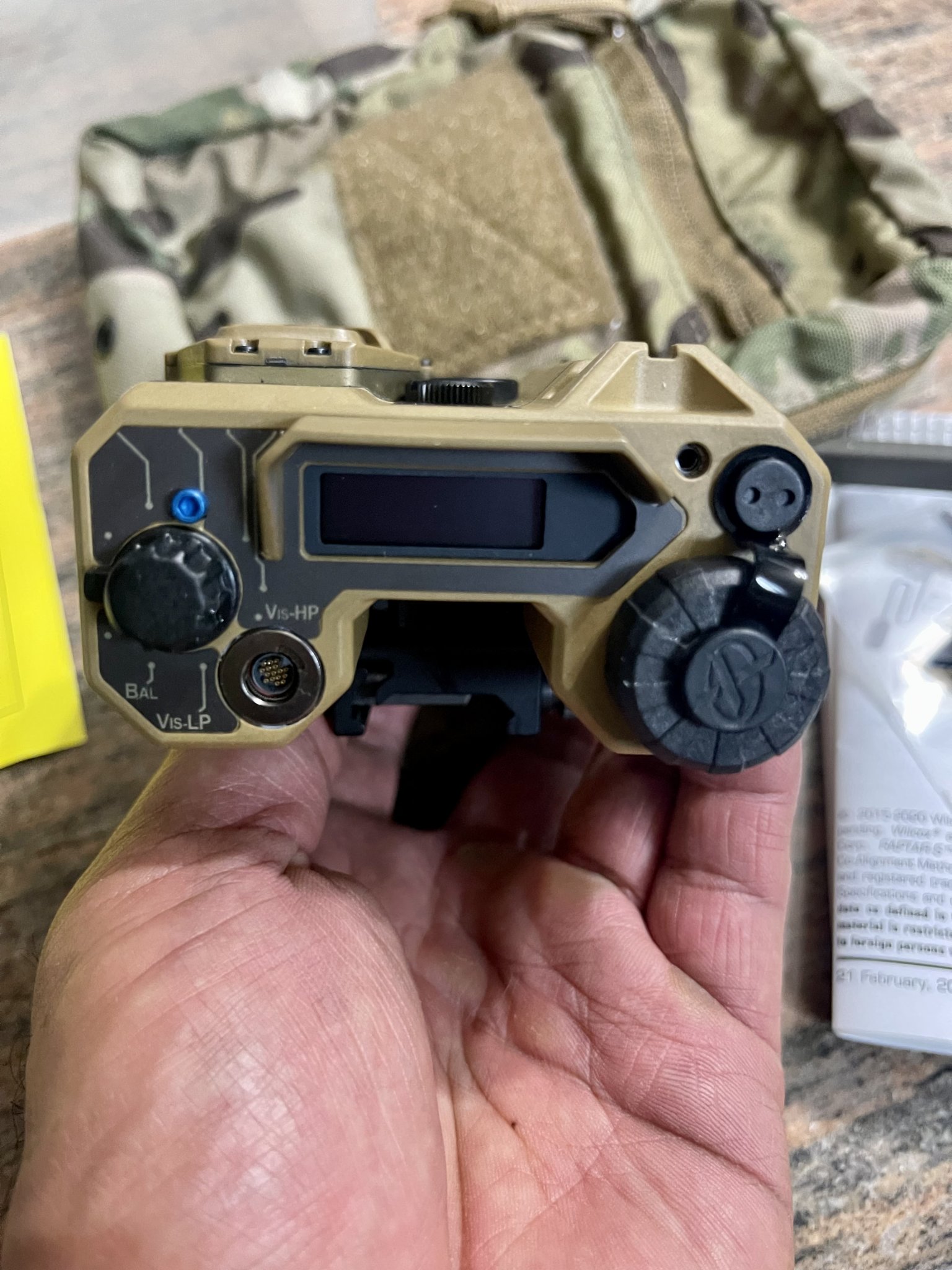

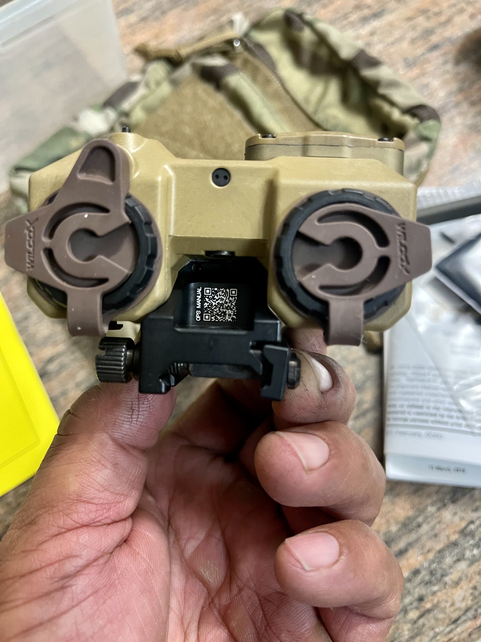

Wow! Got my Raptar S HP today. What a New Years Eve surprise. Thanks to members of this forums. And few calls to Wilcox reps for helping me decide which route to invest my money in between the two units. And shout out to Larry at https://ownthenight.com/ . For also helping me out on this too and getting info for MRF unit. Btw, he’ll be getting MRF units in April. Got my HP unit through him. Very fast service, knowledgeable person to deal with. Will use them again. Happy New Year!
Damn this thing smaller then I thought it was. Badass looking too!
55152CA6-7DDF-4F41-9F2E-8524F7B47BF9.jpeg7C1676A0-D081-4C4D-8FF5-B75450524312.jpeg6F7F077E-9F3C-4E38-AFDF-437CF9EA3B74.jpeg
View attachment 7773792View attachment 7773793View attachment 7773794View attachment 7773795View attachment 7773796
