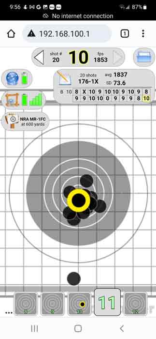

Here's a flyer , Velocity was way low. I'm not great, but better than this.
88ELD.
