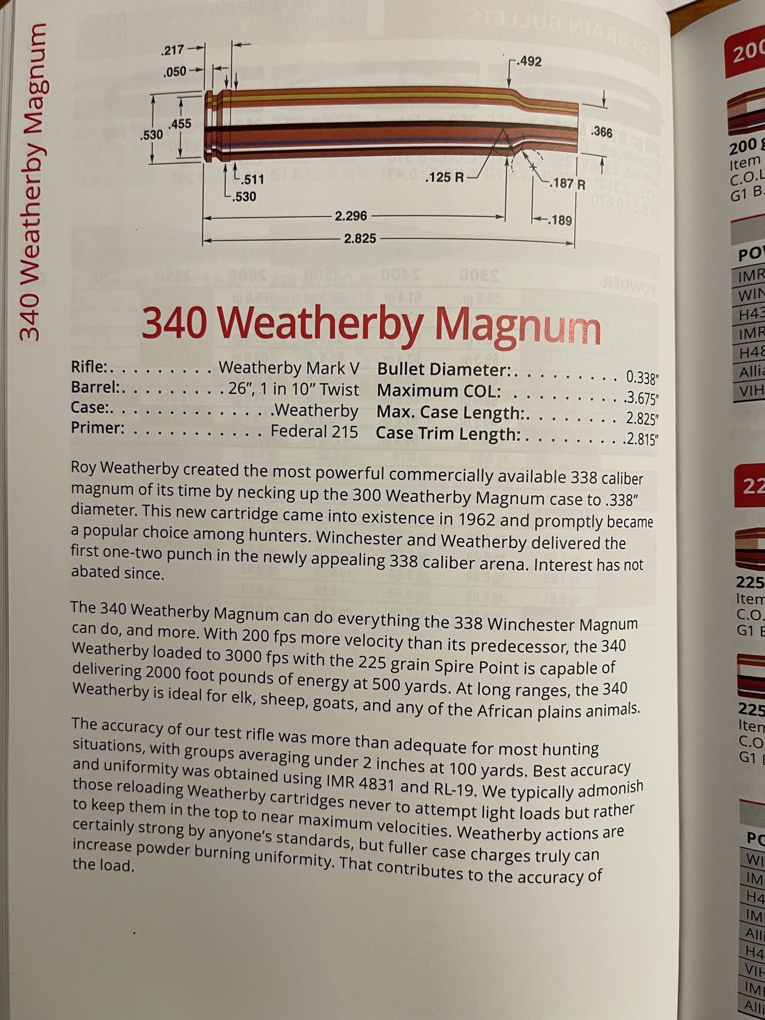

Been a while since I’ve been on the hide. I’m still waiting on a build that I posted about on here a while back, which should be nearing completion soon so the anticipation has been killing me. In the mean time I’ve been trying to gather up some reloading equipment and components to keep myself occupied until then. I’ve also been brainstorming components do another build when this one is finished. The build I’m waiting on is a 300 PRC based on a Bat Vampire action and centered around the idea of a putting together a light weight all purpose 30 cal. I’m not sure which direction I’m going to go next but I’ve been doing some research on different calibers to try to decide. If you flip through a reloading handbook chances are you’ll probably come across quite a few cartridges you’ve never seen before or run across something you may have heard of but don’t know much about since it’s not commonly used or discussed, then you read the ballistics on it and you think to yourself, damn that is an extremely capable cartridge. I’ve come across several and it got me thinking, if you could create your own ultimate wildcat cartridge using anything out of a reloading handbook what would it be? We are seeing a lot of cool new cartridges come out these days and it seems like the parent case is usually something that’s been around for quite some time that’s tried and true then it’s tied into something a little more modern. And the possibilities almost seem endless. Im a sucker for .30 cals, so I was looking at the .340 Weatherby. The ballistics on this round are pretty impressive for the time period it came out, Weatherby introduced it to compete with the 338 Win Mag and I think they knocked it out of the park with the .340 WBY. With the right configuration of powder it can launch a 250 grain pill 2,900 fps and I’m sure if tuned correctly it could easily reach 3,000 fps. I know absolutely nothing about making Wildcat cartridges so I may sound like an idiot here lol, but If I were capable of building my own cartridge, I think I’d take the .340 Weatherby and get rid of the double radius shoulder and replace it with the 338 lapua shoulder and then trim the neck to get the proper cartridge length. Not really a wildcat per say, just modifying the case I guess but I’d love to see what a .340 WBY modernized like this would do. What would you build?
They have already been done.. but I wanted something along the lines of the 25 creedmor and the 28 Sherman. Not a super crazy wildcat but definitely something I would have to load myself.
Done in 1990.....a .375 AI. There are many older design cartridges that benefit greatly with the AI conversion. Many, of the modern cartridges......not so much!
The .338 diameter bullets are a darn good performer on game, and have bullets designed for extremely high BC’s for great LR performance......an example being the .338 Lapua! I like your idea for the modification of the 340. You may get a slight performance enhancement, and rid yourself of that “double radius”!
I went with the .375 AI, with no regrets. It provided me with a caliber (.375) that is legal in most African countries for all of the big 5.....yet capable of using a factory round with minimal reduction in performance from the H&H ballistics, and a cartridge available most anywhere if the need should arise. It has been my “only” hunting cartridge since 1990. Good bullets, flat trajectories, high energy.....it simply works! memtb
Have you ever heard of the .300 Ackley Improved Magnum? It's basically a .300 Weatherby on steroids. You form cases from .300 Wby brass. I had mine built about 10 years ago. Awesome cartridge.
.280 Sherman is one I've been wanting to build for a long time.
I think a .25 Creedmoor would be an awesome cartridge for deer hunting. I have a new .257 Proof Research CF blank sitting here that's going to finish at 26" and it's got a 1:7.5 twist. Thinking about building a .25 CM Imp. (40º shoulder).
Reactions: Hardshot and TrevK

Thanks Memtb, one thing is for sure Roy Weatherby knew how to make a cartridge pack some heat and that was 60 years ago. I can only imagine what he’d design with today’s technology. I like your approach on the 375. I’m planning on doing a compact rifle build on a Bat Bumblebee action when my Vampire build comes home and that’s kind of the same approach I’m going to take on this build and why I’ve been researching a few different cartridges. I’m kind of leaning towards 6.5-284 Norma.
Reactions: Highbrass and memtb

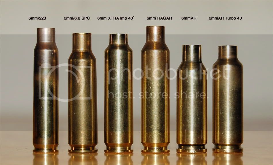

Mr.BR Very interesting, any concern of keeping bullet aligned during feed from mag with a short neck?
Yes that is definetly a fine line i will have to balance on, but like said waiting for the software so i can game some configurations and then strike a balance of MV gained vs neck lenght lost , that is the great thing about wildcatting in the computer first before any metal is cut.
Might end up with neck shorter than 6mm XTRA imp40 ,note these are all meant for semi auto rifles so with bolt action i might be able to get away with shorter neck and still have enough grip on the bullet
Reactions: oldiephrt

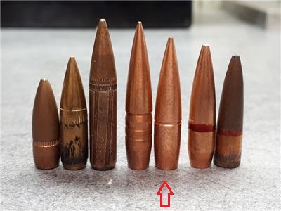

Current bleeding edge of cartridge design
French 5.56x45 neckless, neck cut short to accommodate a 64g monolithic bullet, design is meant of be used in existing rifles ,mags and 5.56x45 chambers.
They are actually going to test fire it from an HK416 , and was already tested from a test barrel , point of the whole endeavor is to demonstrate that with proper bullet design there are still ways to go in 5.56 , of course end game would be a neckless cartridge with composite case like 6.8 from True velocity
Bullet is slightly modified and scaled down Balle D , 120y old design with better form factor than Werner Straight line.
Ballistics from a 14in barrel . Note considerable gains due to bullet used.
300m Velocity and Energy: M855 (1992fps/546) vs Neckless (2216fps/698ftlbs)
600m Velocity and Energy: M855(1224fps/206) vs Neckless (1631fps/378)
Supersonic Range: M855 (649m) vs Neckless (842m)
M193 / M855 / M856 (fired) / 70 gr VKO / 64 gr "5.56 mm D" / 7N6 / 5.45 tracer.

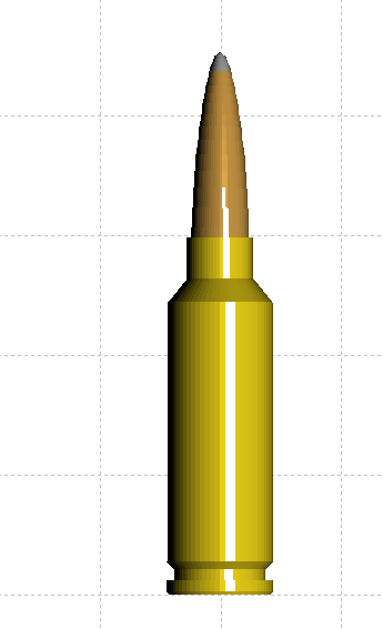

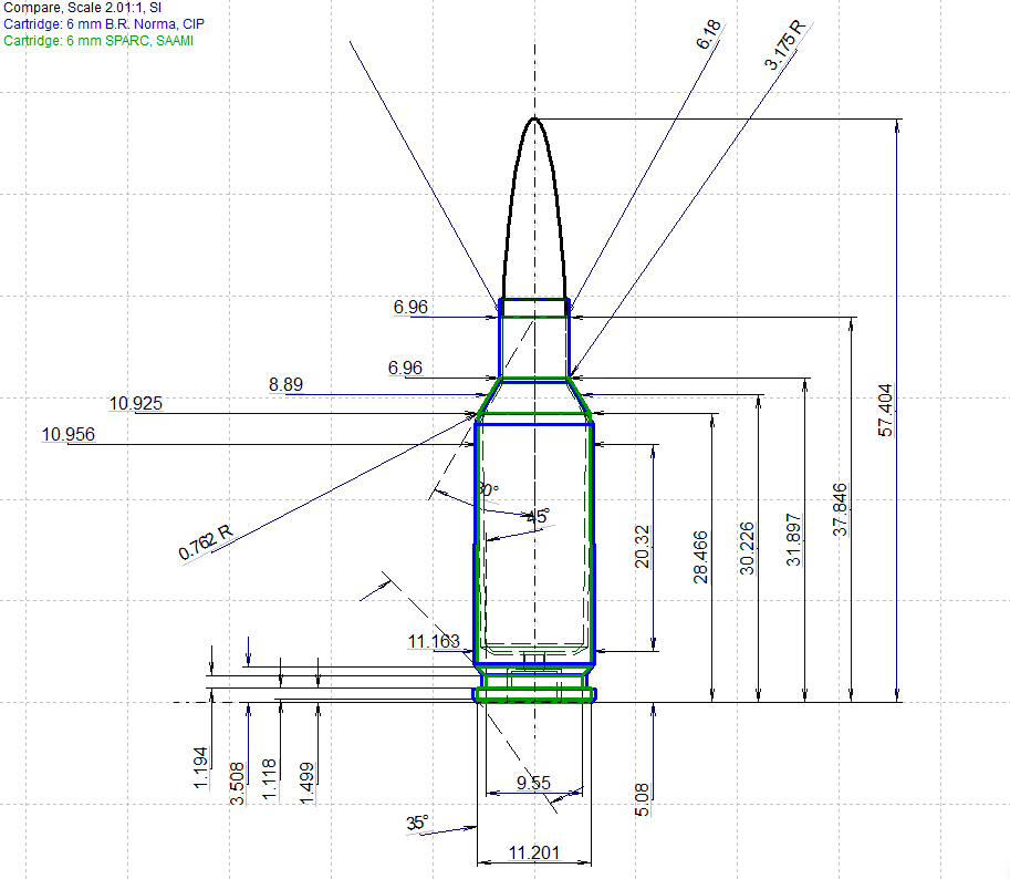

Got to play with QuickDesign today
Green new chamber design ,blue 6ARC, this is still relatively normal neck length and gives cca 3grain more volume over ARC with same OAL , will likely further bump the shoulder , but first i have to export the design to Quickload so i can benchmark the different chamberings at least roughly before deciding to make one for real.
