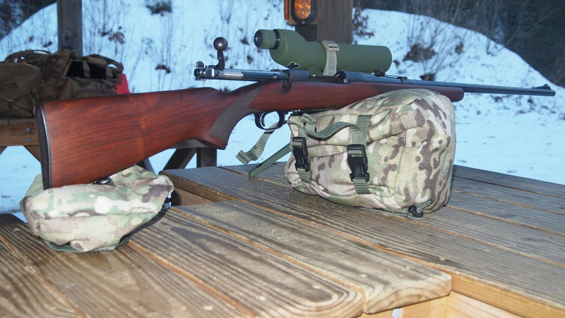

    The owner of that site did all the work on my rifle, fit the Douglas blank, installed pillars, full beautiful bed job, bluing in a variety of finishes to meet original Winchester finishes....
    Further info, lots of pictures here......
    https://www.snipershide.com/shooting/threads/winchester-m70.6789905/
    @pre64win will take care of you.

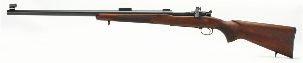

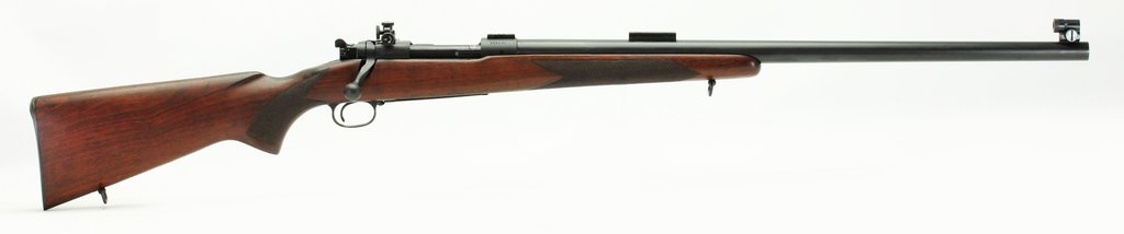

    My first love was Springfield 1903s.
    All a Pre 64 Winchester is is a Springfield 03 made for commercial sales without the military over engineering.
    Im interested to see how a well bedded flat bottom does against mil spec.
    Im willing to bet a modern chassis/synthetic stock would really make these capable of holding their own.

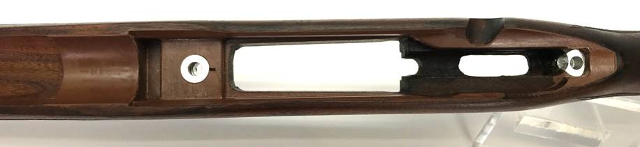

    I run the TBM System. My first SPR a1 a decade and a half ago, had the DMB system. It was a poorly designed mag system that had feeding issues. I had that gun converted by CDI to use AICS mags. My next SPR a5 also had the DBM system.
    When MWS was blowing out their FN stocks, I picked up some TBM systems with A3/A4 stocks cheap. I converted over my DBM to TBM and am really happy with it. They feel as well as my AICS mags, but are double stack like AW mags so I get 10 rounds in a shorter profile. They feed great.
    The other benefit is its drop in. Now here is the catch. The action screws that come are not the right size. Perhaps FN figured they would be shortened by a gunsmith, but the screw when torqued, ends up into to bolt either binding it in place, or preventing it from closing.
    So you need to measure what you have and order the next smaller size from here: https://www.midwestgunworks.com/winchester-model-70/trigger-guard-screw-rear.html
    I just got my new action mounted in the a3 stock with the TBM and need to do the same again. The hawk hill marksman 6.5 fits perfect into the channel. The plan is to sent it off to get either KMW or LRI cheekpeice installed , barrel/chambered and coated shortly. Hopefully I can get LRI to do it, but in the past chad told me he didnt like working on stocks that aren't inletted/bedded by them.
    Most smiths can work on a 700 because it takes almost no skill. CRF, flat bottom actions require a higher level of understanding and usually some fixtures to be able to mount the fucker in a lathe. I would stick with someone like LRI, GAP, SAC, PVA who l have experience with CRF actions such as the mausingfield and winchester 70.
