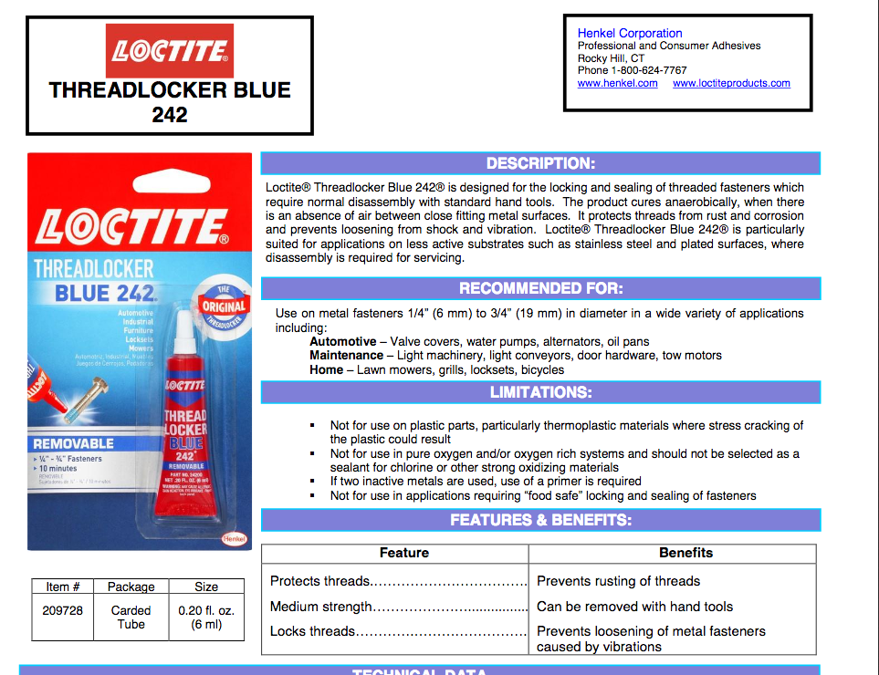

The loctite adhesive requires anaerobic (i.e. lack of oxygen)conditions to cure; little to no air between screw thread and mount thread. Any excess on the surface is easily wiped off after screws tightened, as it will not cure in open air and will generally not harm open air plastics or finishes; it comes in a plastic bottle!
243 is not intended for surface sealing. Put the Loctite in the screw holes, make sure that there is no Loctite on the mating surface, and install the screws.
If I was going to chemically bond those parts I'd use a different Loctite that's made for the application. That is essentially a permanent install though.
Nitride coating is very chemically resistant, and Loctite is very chemically stable as far as standard metal coatings go. It's not like Loctite isn't used on tons of Nitrided parts.
Not running for the job of adhesive police just the common sense police..experience trumps the simple mfg. recommendation which is NOT to use the product to secure two pieces of plastic together! No where does it state NOT allow it touch a plastic surface. It's almost like saying don't it is okay to allow your gin martini to pass over your the mucous membrane of your lips just don't wash out your eyes with your martini! It's common sense not nonsense. I have used blue loctite to secure fasteners on hundreds and hundreds of Safariland plastic strutures without ever seeing a problem. IF you don't believe then don't do it. Simple.
Blue Loctite does work reasonably well as a non-permanent bedding compound. It's not ideal, but it does work to fill voids in metal to metal fit up and does provide some adhesive bonding as well. I use it on scope bases/rails, muzzle brakes, AR gas blocks, AR receiver extensions/receivers etc.
Also, don't use it on plastic unless you know it's compatible, or don't mind losing the part. It says right there in the "LIMITATIONS" section, "Not for use on plastic parts..." A company I used to work for had to recall a batch of parts we made because it was ABS supported with screws that were Loctited into a steel standoff. The tiny bit of excess Loctite from installation caused a large number of them just crumble under load. Are there certain types of plastics it's probably fine for (like the bottle)? Sure, but why fuck around?
Back when I was big and the RC helis, ran into a number of issues with Loctite. At one time there was no mention of plastic degradation due to loctite use. When Servo gears, case tabs started cracking as a result of screw retention we started seeing the info listed on the Loctite site.
Can't tell you all the different components or scenarios where Loctite was found to be the cause of the failure with plastic parts. Just know that Loctite and plastic is not a good mix. Yes, there are Plastics that are resistant to some chemicals. Typically that is used as a selling point.
